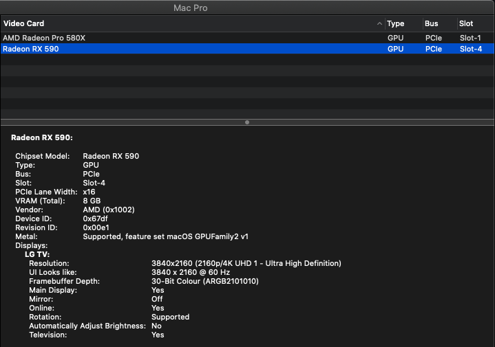

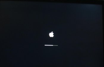

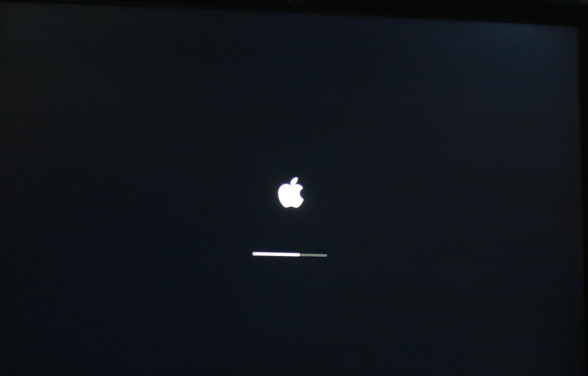

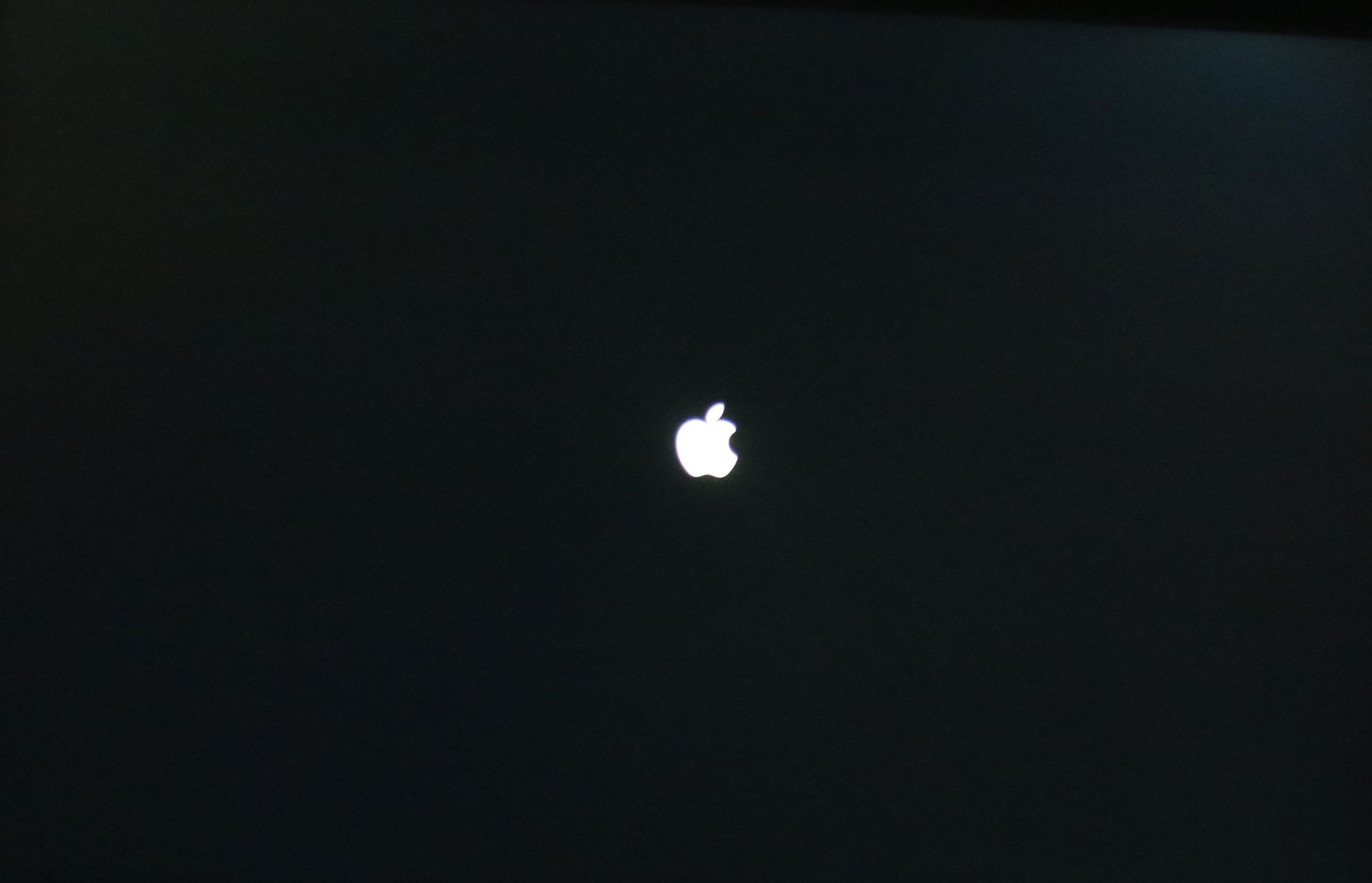

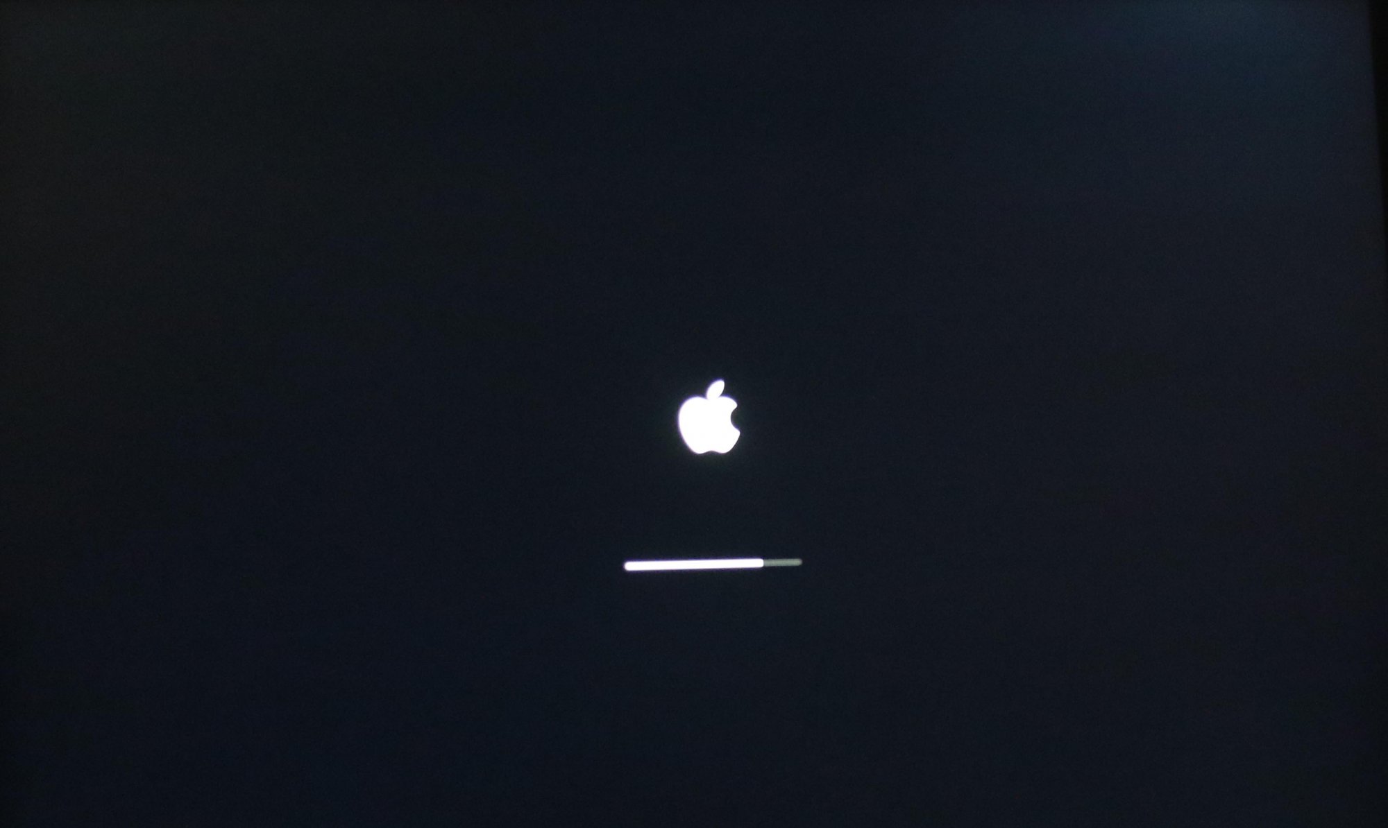

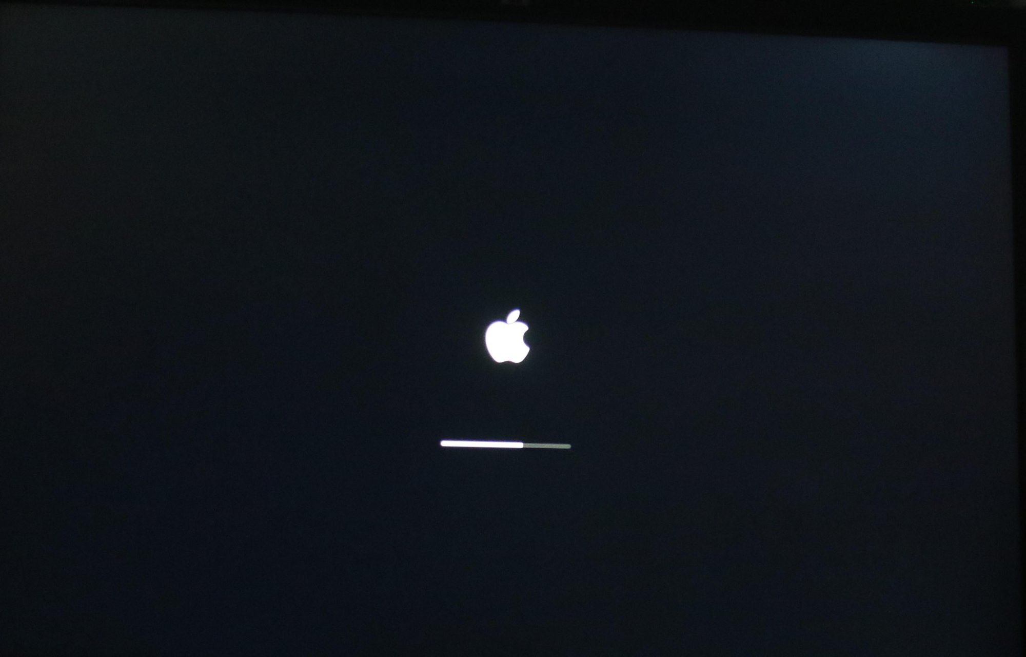

People tested this with Mac mini 2018 after the Catalina firmware upgrades and aftermarket GOP AMD PCs GPUs now work fine for pre-boot configuration support when installed via eGPU. Mac mini 2018 was the first Mac that this was seamless, nothing needed with the GPUs firmware whatsoever, GOP working perfectly.
Now we need to confirm the same with 2019 Mac Pro.

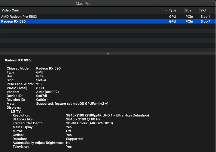

some german user confirmed boot screens working with an Asus Strix RX590 installed.
Any link?
And a more important test, only boot with the RX590.
Even I believe that test result is valid. However, if the 7,1 works similar as 5,1. Then as long as the stock 580X has the required tailor made EFI. The 7,1 can read that and use that to correctly activate the RX590 to provide boot screen.
To make it clear, I am not saying that the 7,1 is using any Mac specific EFI. However, even it is, the RX590 may still able to show boot screen as long as the 580X is there.
So, a test with only 3rd party graphic card installed is required to confirm boot screen availability.
