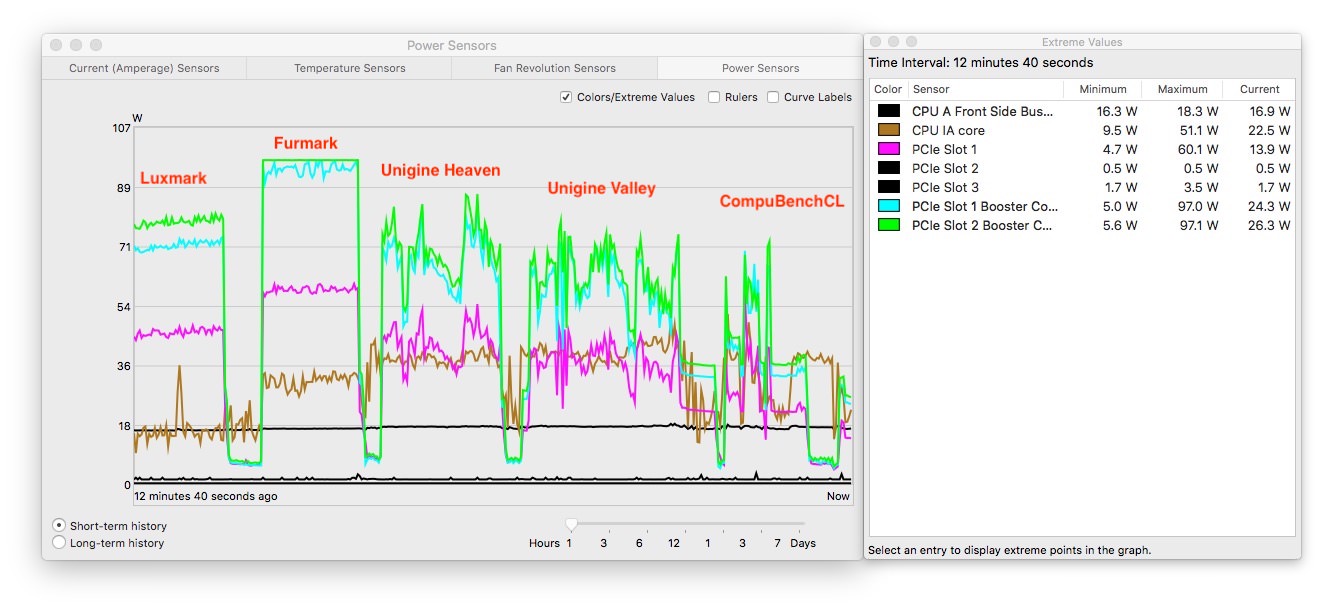

I am running a 1080Ti right now. I can confirm that CUDA-Z heavy test can cause issue. However, that seems to be a very exceptional case. Even MVC page stated that, the power draw of the 1080Ti is generally lower than the 980Ti, and the 980Ti can run with just the mini 6pin.
I can run everything including Furmark (and OCCT in Windows) without any issue. And obviously the power draw for real world usage is not a problem at all. I tested it in both MacOS and Windows.
So, unless OP get a factory OC 1080Ti. Or his daily job is to run CUDA-Z heavy test. IMO, there is no need to go through the pixlas mod. But of course, if he doesn't mind to do that, I totally agree that let the 1080Ti drawing power directly from the PSU is better than via those tiny mini 6pin ports.
Anyway, even if don't want to go Pixlas mod, and worry about the power draw, as MVC said, a simple SATA to 6pin cable can also alleviate the problem. Not really need an external power.
