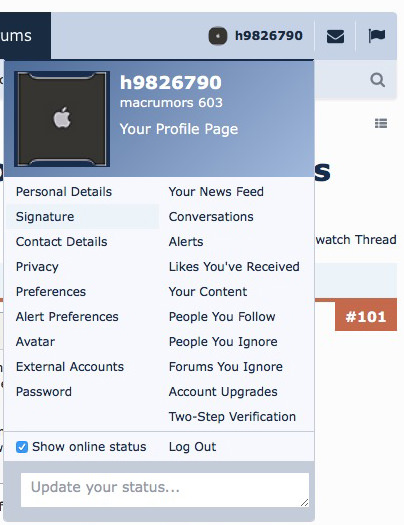

(BTW Caesar_091, how do I add that computer spec underneath the post like you did?)
Click your name on the top right corner and then click signature.
