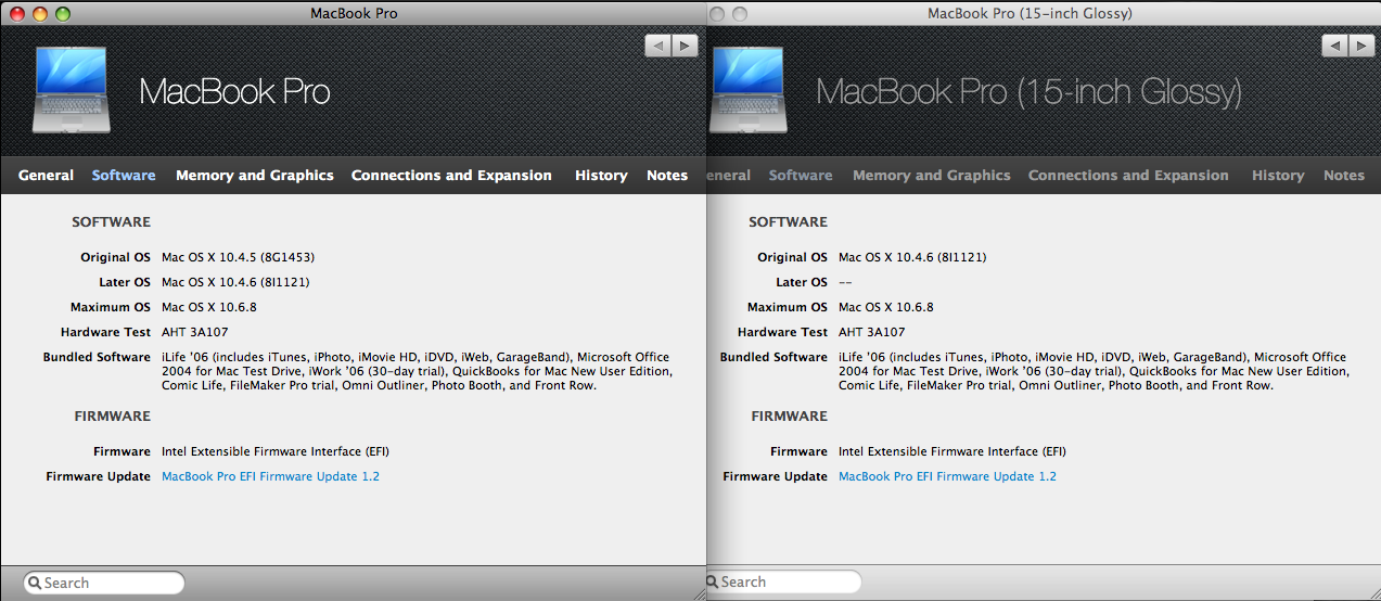

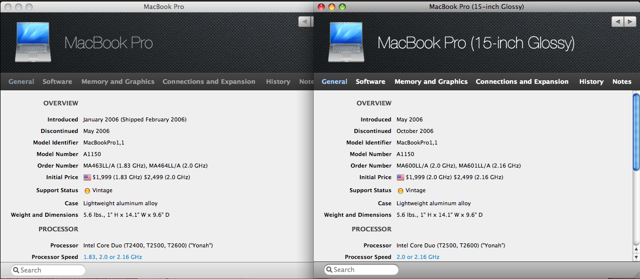

You Can not run Mountain Lion, 10.6.8 is the highest you can go.
There are two A1150, both 2006

Ok - that makes sense for some of my boot with circle /line scenarios ..
