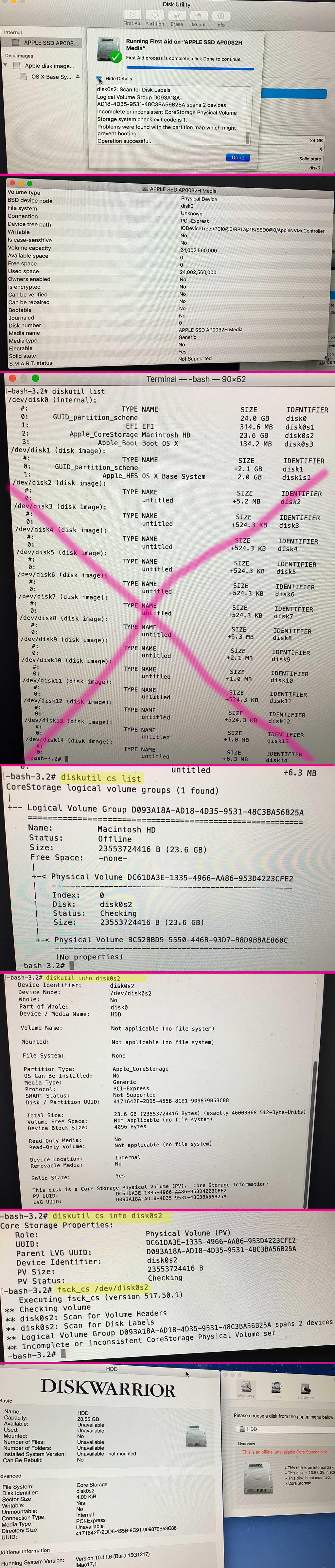

I am attaching a screen of some basic info (most is probably redundant) that will hopefully provide a better sense of what I'm dealing with. It seems like the SSD from the fusion group is the only thing it picks up? And that the main drive is missing?
That does seem like your HDD is missing entirely. As of right now, the only thing I can think of, is un-fusing the Fusion Drive, and only using the SSD for now
