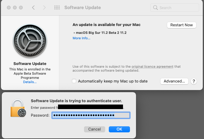

So I finally made a bootable clone 🙂 works great. Now I'm trying to update the clone to 11.2 beta but it will not accept my user password, ideas? (password works for everything else)

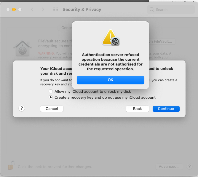

I've finally managed to make a bootable clone of Big Sur to my external drive. There is one issue though, I can't enable FileVault on it, any ideas?
Does this paragraph from this CCC article help at all? If so it is an explanation not a solution at this point.
"The System volume is not encrypted when FileVault is enabled on a Big Sur startup disk​
This is not a bug, this appears to be a deliberate change on macOS Big Sur. When you enable FileVault on a Big Sur startup disk, the System volume member of the APFS volume group is not encrypted. Considering that this volume is identical on all Macs, encrypting its contents is not going to prevent someone from knowing what's on it, so the encryption does appear to be unnecessary. There is one undesirable effect of this change, however, regarding an encrypted, bootable backup disk. When you attach the device to your Mac, the System volume is mounted automatically, regardless of whether you unlock the associated Data volume. If you specifically choose to not unlock the Data volume, there are three results that range from confusing to annoying to alarming:

You can unlock and mount the Data volume in Disk Utility to access the data. If you provided the volume's password to CCC, then you can simply run your CCC backup task and CCC will automatically unlock and mount the Data volume.
We have reported this issue to Apple (FB8918177) and we are currently awaiting a response"

I finally succeeded 🙂 I was enable to active FileVault, it did take some testing though (8 hours or so). Now I can just clone away whenever I want 🙂
