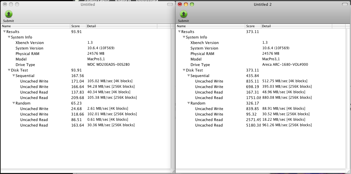

OK, here's the Xbench performance results with the set-up. 7 drives in the raid set, one is a spare. On the left is a single 2 TB 5400 rpm drive. On the right is the raid configured as a raid-6. I haven't done any real world tests yet.
Pretty good results. Looking forward to seeing if it will boot or not... 🙂
Thanks a bunch for the pc-pitstop recommendation. Really happy with the product so far, only negative was $110 for 2-day shipping.

Yep -- saw your EFI posts back in January in another thread. It seems to work fine so far, but I've only booted it once. It was a bit disconcerting as the newest Mac EFI firmware I could find is dated April 2008, but I guess neither the card nor EFI (nor Mac Pros...) are changing that much 🙂
