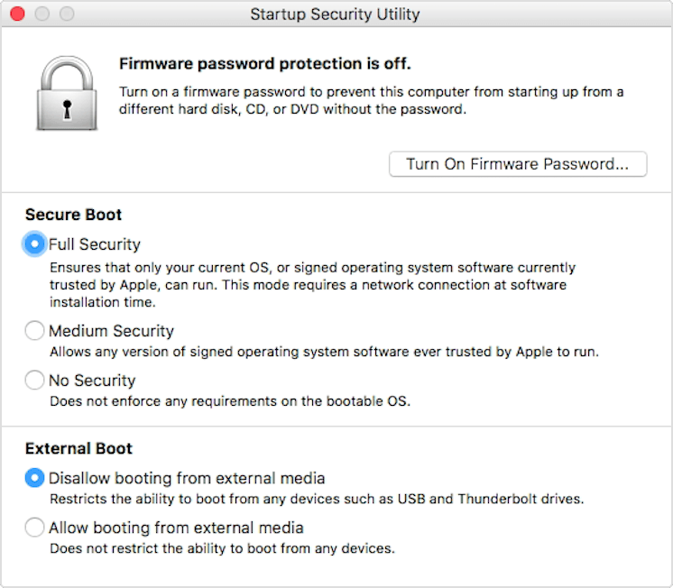

Bombich does have a support article dealing with booting problems with a clone. It specifically mentions T2 Macs, but only with regards to changing a System Preference to allow booting from external devices. However, that alone would appear to suggest that booting a CCC clone on a T2-enabled system is supported, contrary to what some others may believe.
https://bombich.com/kb/ccc5/help-my-clone-wont-boot
Side Note: T2-enabled macs do not support booting from a network-based image.
Would changing settings here help you?

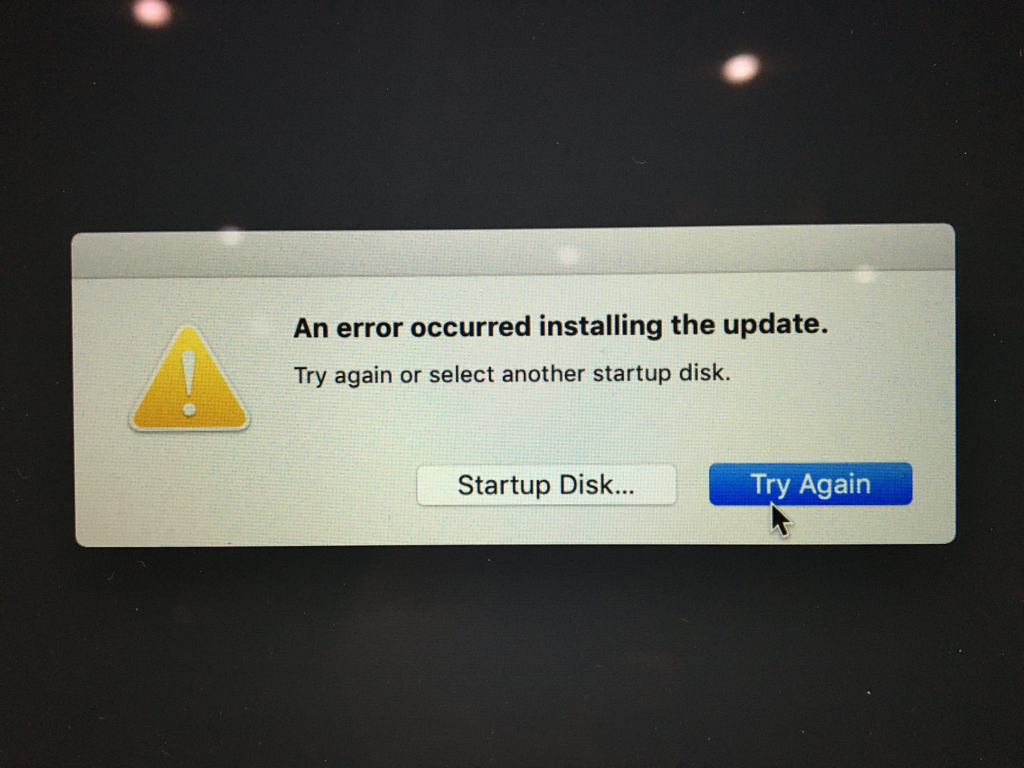

Hi MacHaltah,
I've tried your suggested solution on a T2 MacBook Air that was already imaged and it worked fine. Thank you very much for that. I've used a different cable than suggested and the transfer took longer but it worked. The Image is 14.6.
However, I am attempting the same thing on an out of the box T2 MacBook Air and unfortunately, I haven't been successful. It goes to Internet Recovery on first boot which takes around 9 minutes and reboots into Recovery Mode, prompting me to select the Startup disk or to Update. Once I select the startup disk it will restart and I Option select the drive but it will not boot normally and it goes to Internet Recovery again. If I select the Update instead of the Startup disk, it looks like it's attempting to update and it takes me to OS loading screen for a brief time and it fails, taking me to the Startup disk/Try Again prompt obviously it fails again if a choose to Try Again.
Any ideas?
Thanks
