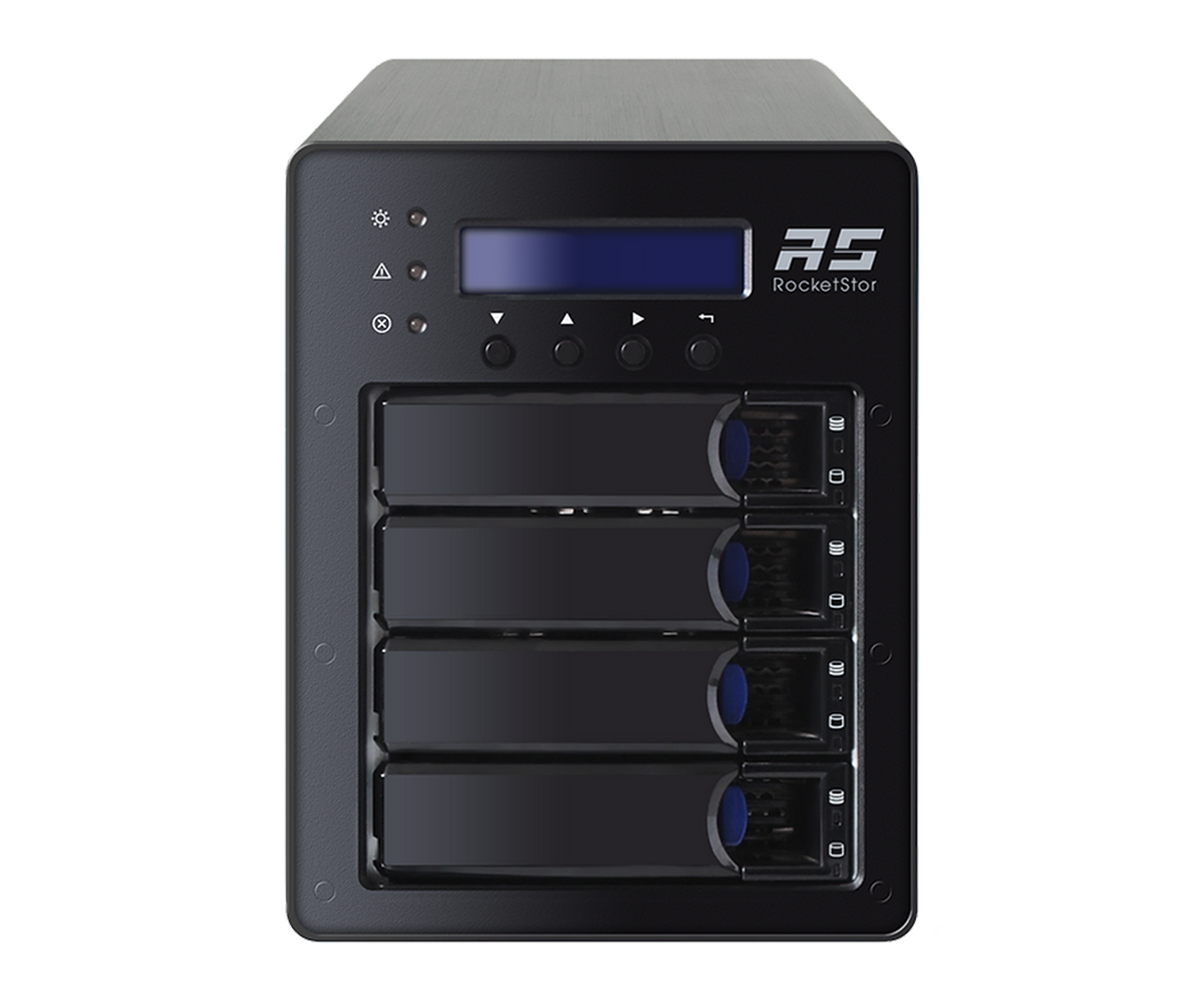

You may want to consider solutions like these:
Every time I see HighPoint mentioned I throw up in my mouth a little.
Never have had worse after-the-sale support from any other company. If it works out-of-the-box fine, but don't expect any firmware or driver fixes if it doesn't.
My life is HighPoint free at this point, and much better.
Do you have another brand you prefer for a U.2 4 drive bay box?
