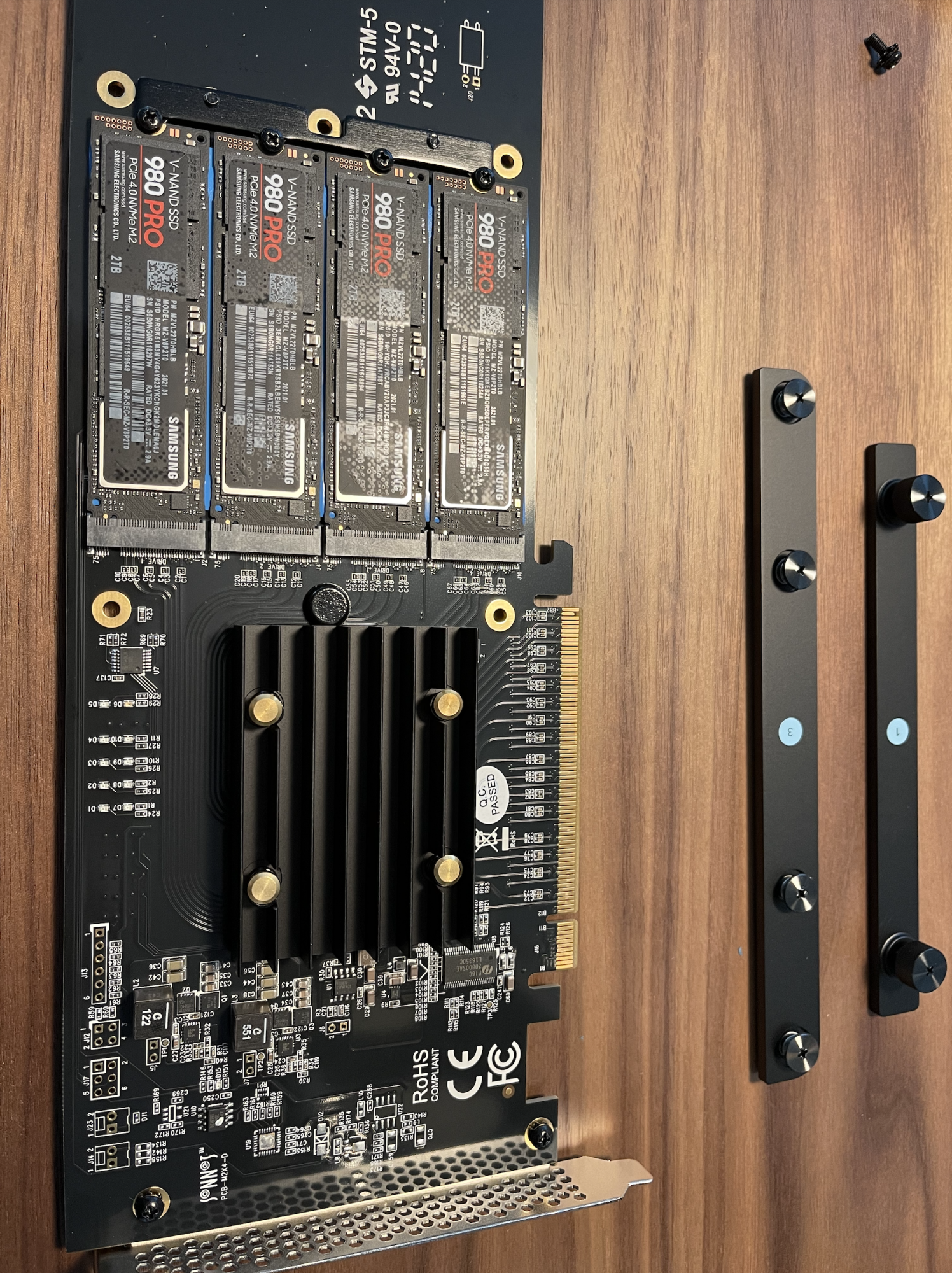

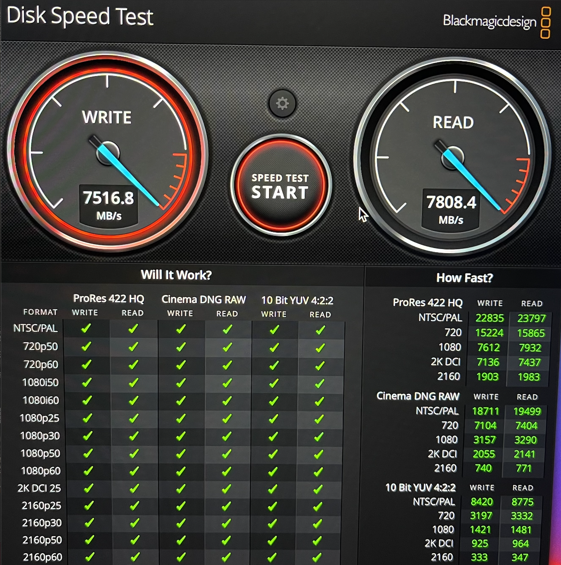

Added 980 PROs to the sonnet today (not necessary for mac pro but I can use it in other Pcie 4 system down the line), and disk utility raid 0 set up, APFS with 64k chunk. Getting amazing speeds but strangely read speed is not 8k+ mb/s
