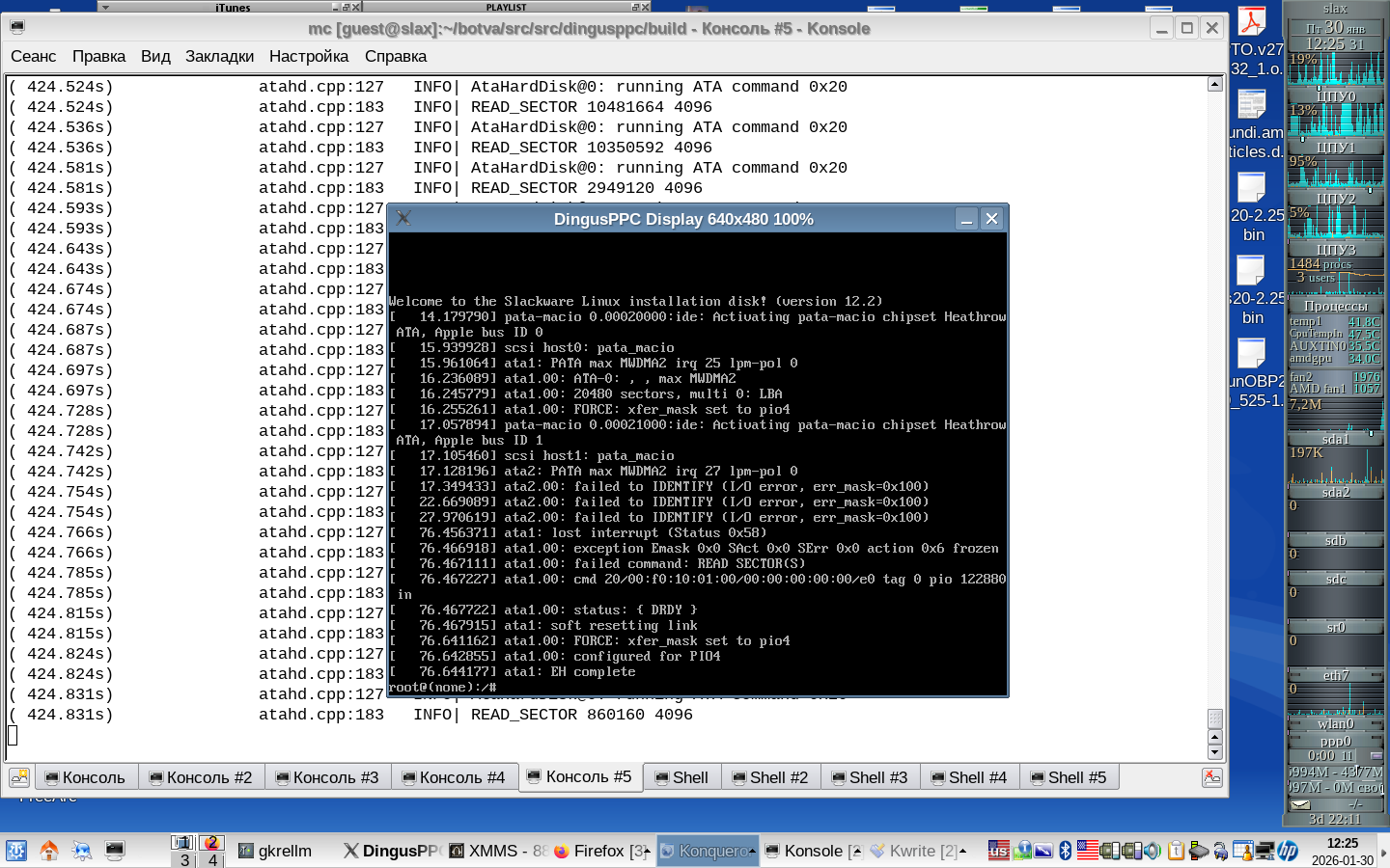

oops, removed too much from initrd! Sorry, rebuilding ....

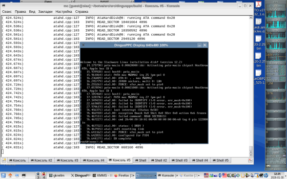

NICs are recognized now but no link. I'm not sure if firmware or manual configuration is required. Will investigate later.
well, if you have dhcp server on your network - "dhcpcd eth0" should be enough? (it does not do this automatically, and surprizingly there is no "dialog" menu for starting (u)dhcpcd - even if script put it in initrd filesystem. But I meet qemu hang at dhcpcd with Slackintosh 12.1 kernel, so may be this was reason for missed network autoconfig?
So, cool! I was trying to make bootable dvd, based on this image, and it worked in qemu, but sadly full set with KDE(5) does not fit on single layer DVD anymore!

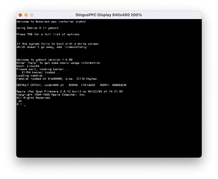

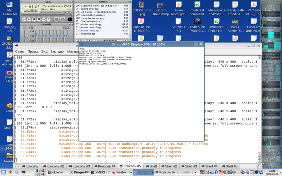

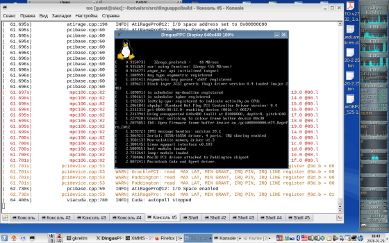

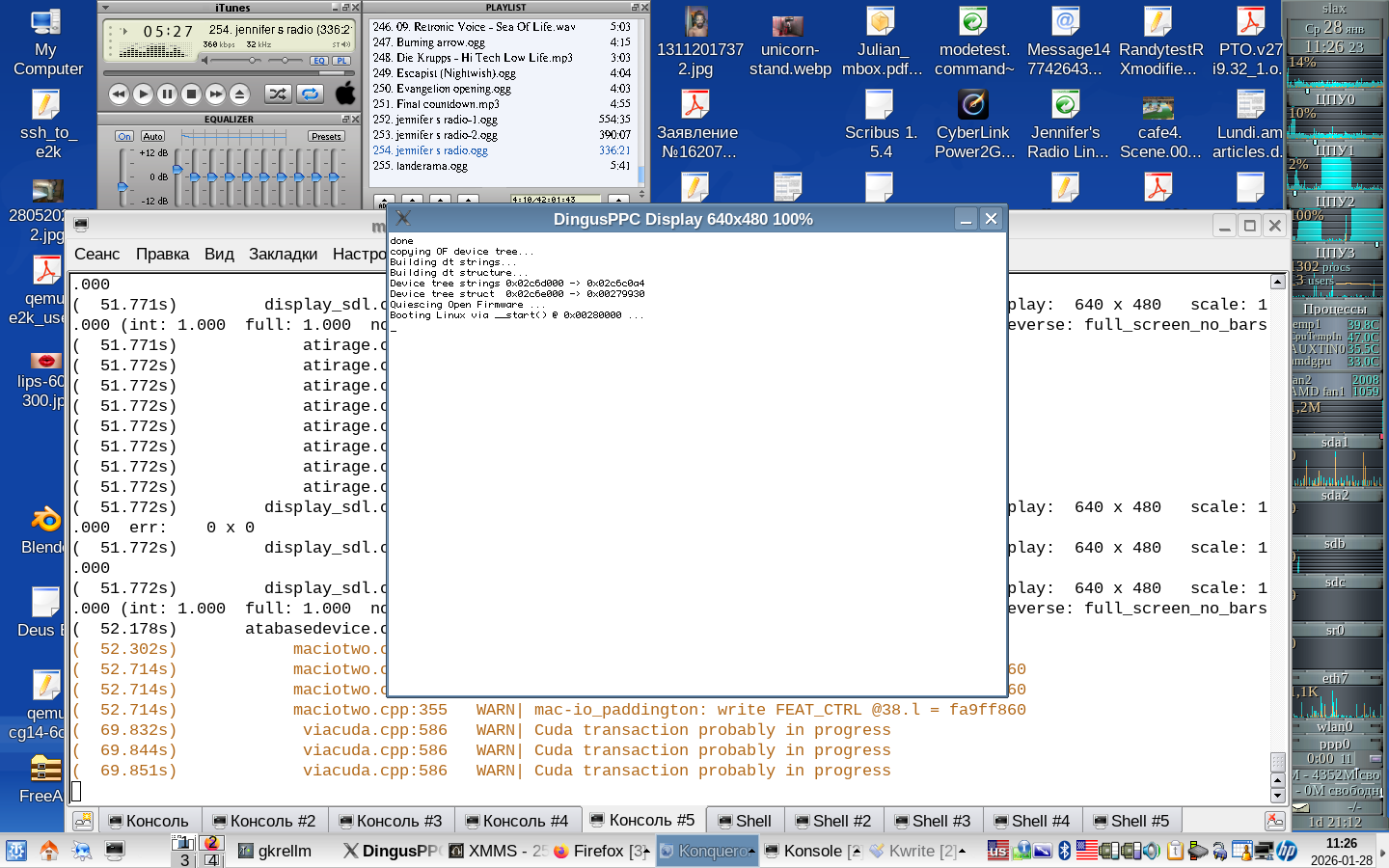

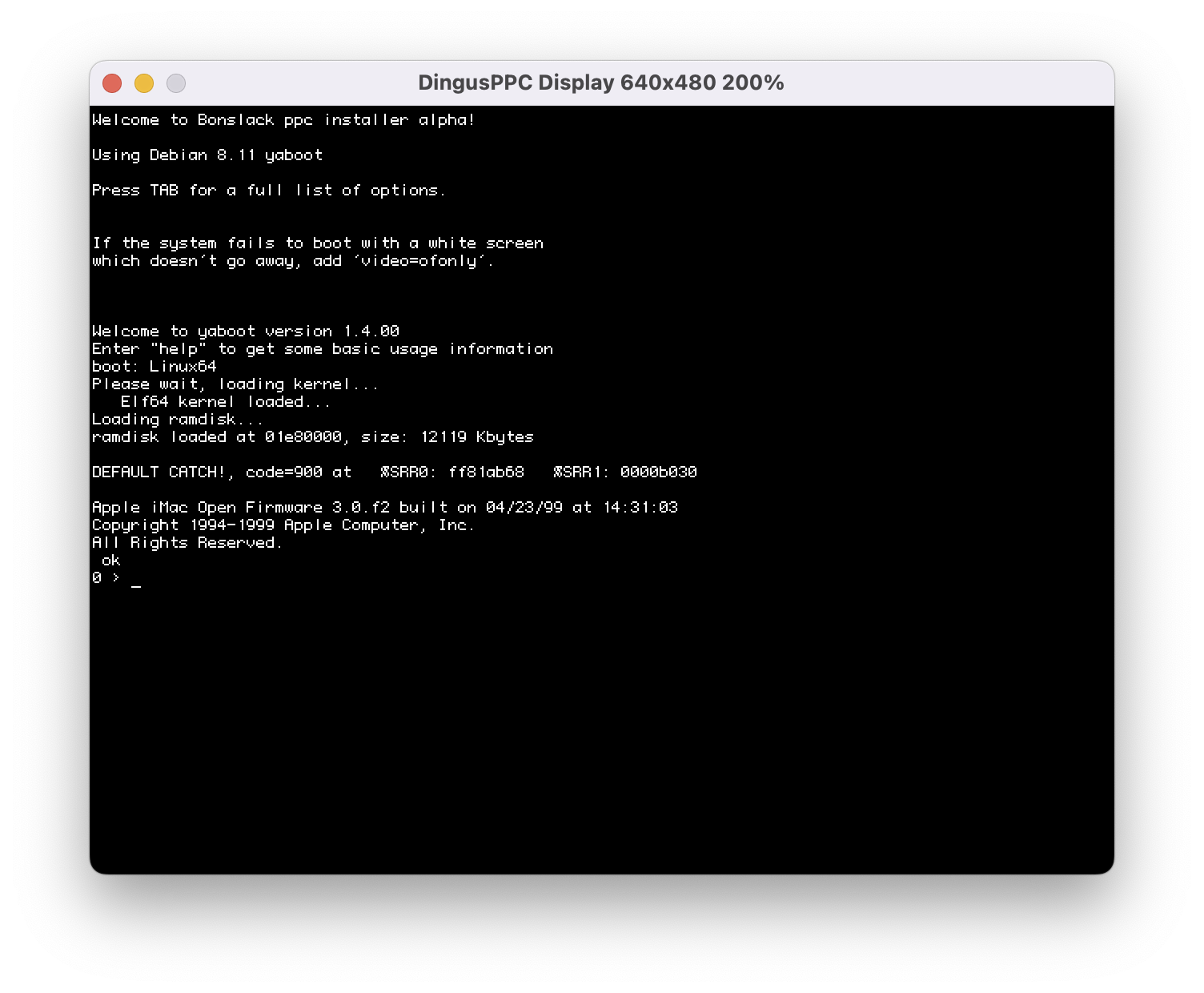

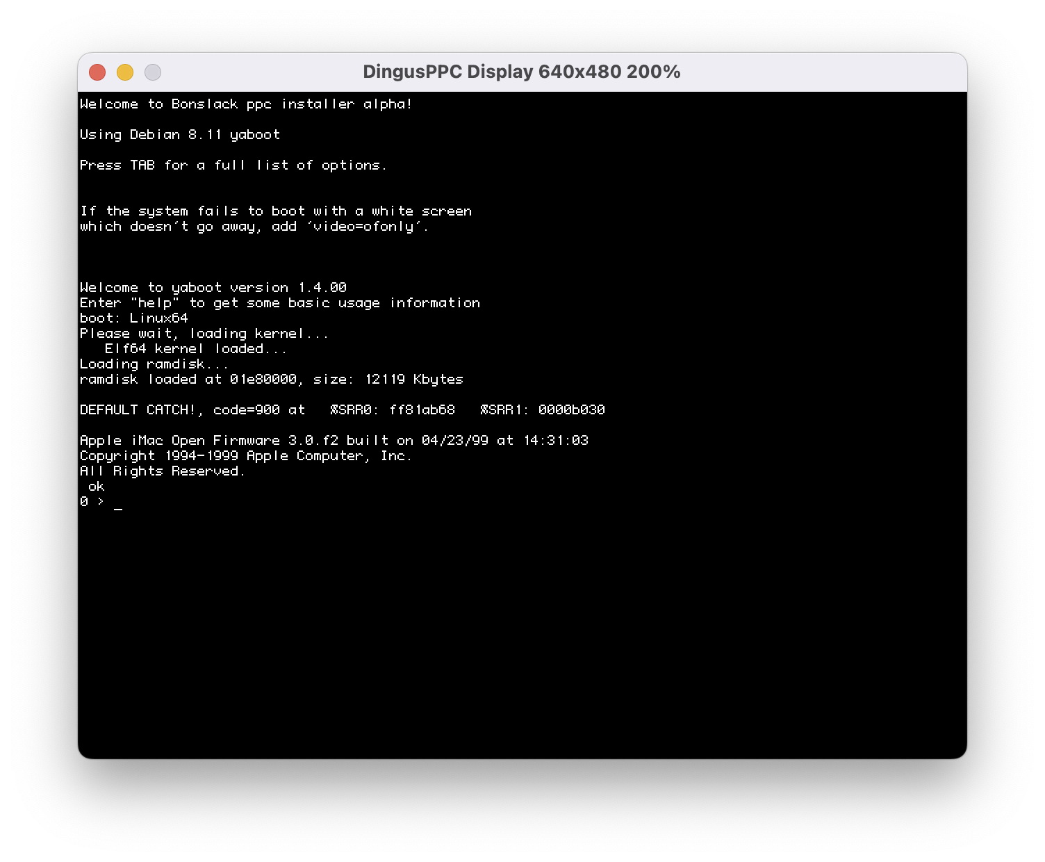

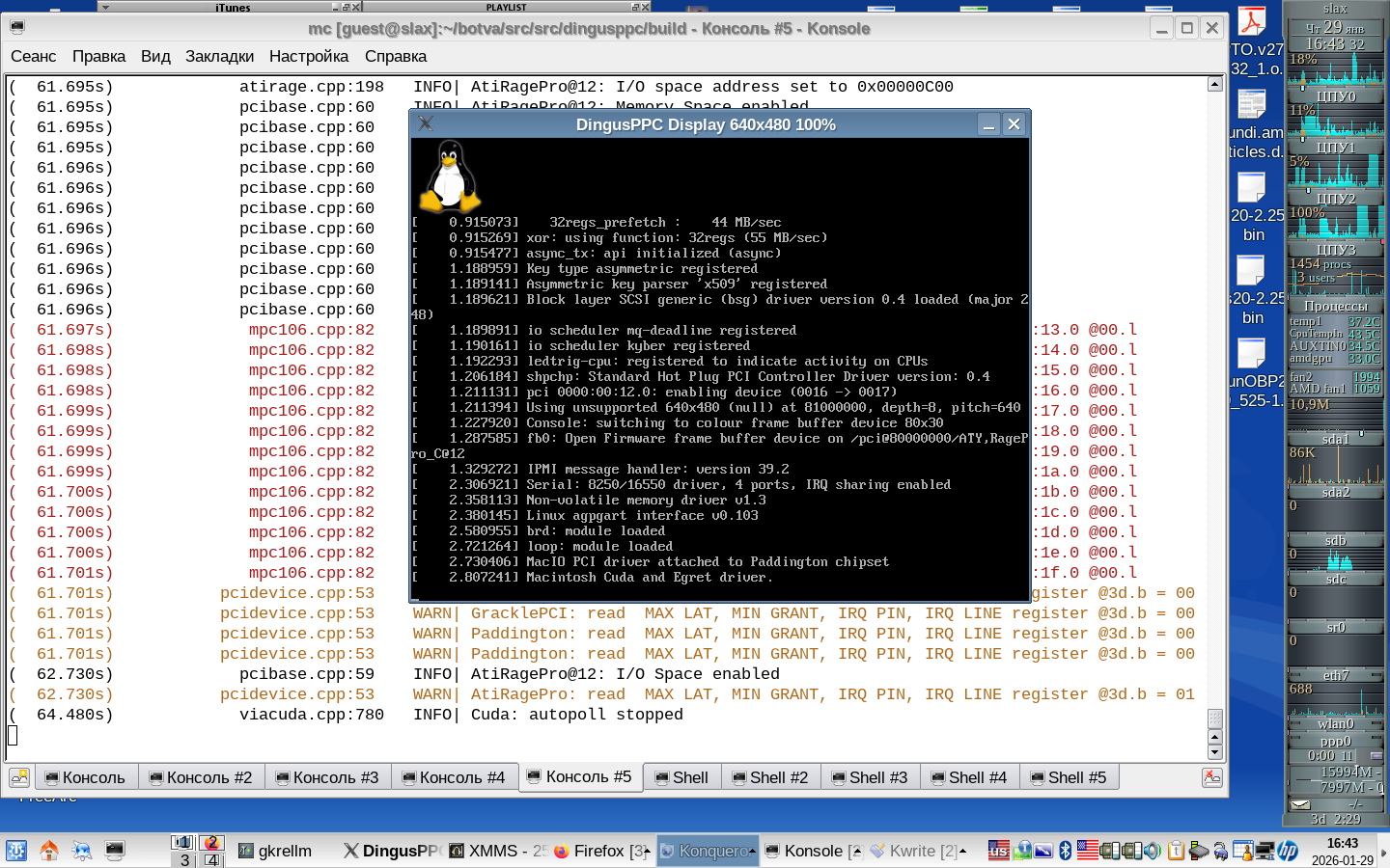

Yes, thank you, with imac.zip rom from MAME emulation starts, but stuck lately when Linux kernel is loaded?
Code:
bash-5.1$ sudo bin/dingusppc -b ~/botva/src/src/NewWorldRoms/imacboot.u3 -r --rambank1_size 256 --rambank2_size 256  -m imacg3 --cdr_img /mnt/sdc1/cross/yaboot4-s.iso  --gfxmem_size 4 --log-to-stderr

(  36.085s)         display_sdl.cpp:254   INFO| configure_dest         drawable:  640 x 480   display:  640 x 480   scale: 1.000 (int: 1.000  full: 1.000  nobars: 1.000)  mode: not_full_screen  forward: full_screen_int  reverse: full_screen_no_bars
(  36.098s)       atabasedevice.cpp:46    INFO| ATAPI-CDROM: soft-reset triggered
(  36.171s)       atabasedevice.cpp:46    INFO| ATAPI-CDROM: soft-reset triggered
(  36.241s)     atapibasedevice.cpp:176   INFO| ATAPI-CDROM: xfer_type=0x0, mode=0x1
(  36.712s)       atabasedevice.cpp:46    INFO| ATAPI-CDROM: soft-reset triggered
(  36.781s)       atabasedevice.cpp:46    INFO| ATAPI-CDROM: soft-reset triggered
(  37.214s)       atabasedevice.cpp:46    INFO| ATAPI-CDROM: soft-reset triggered
(  37.277s)       atabasedevice.cpp:46    INFO| ATAPI-CDROM: soft-reset triggered
(  37.339s)     atapibasedevice.cpp:176   INFO| ATAPI-CDROM: xfer_type=0x0, mode=0x1
(  37.345s)       atabasedevice.cpp:46    INFO| ATAPI-CDROM: soft-reset triggered
(  37.407s)       atabasedevice.cpp:46    INFO| ATAPI-CDROM: soft-reset triggered
(  37.473s)       atabasedevice.cpp:46    INFO| ATAPI-CDROM: soft-reset triggered
(  37.537s)       atabasedevice.cpp:46    INFO| ATAPI-CDROM: soft-reset triggered
(  37.597s)     atapibasedevice.cpp:176   INFO| ATAPI-CDROM: xfer_type=0x0, mode=0x1
(  37.602s)       atabasedevice.cpp:46    INFO| ATAPI-CDROM: soft-reset triggered
(  37.664s)       atabasedevice.cpp:46    INFO| ATAPI-CDROM: soft-reset triggered
(  37.726s)       atabasedevice.cpp:46    INFO| ATAPI-CDROM: soft-reset triggered
(  37.789s)       atabasedevice.cpp:46    INFO| ATAPI-CDROM: soft-reset triggered
(  37.850s)     atapibasedevice.cpp:176   INFO| ATAPI-CDROM: xfer_type=0x0, mode=0x1
(  37.855s)       atabasedevice.cpp:46    INFO| ATAPI-CDROM: soft-reset triggered
(  37.916s)       atabasedevice.cpp:46    INFO| ATAPI-CDROM: soft-reset triggered
(  37.982s)       atabasedevice.cpp:46    INFO| ATAPI-CDROM: soft-reset triggered
(  38.047s)       atabasedevice.cpp:46    INFO| ATAPI-CDROM: soft-reset triggered
(  38.109s)     atapibasedevice.cpp:176   INFO| ATAPI-CDROM: xfer_type=0x0, mode=0x1
(  38.116s)       atabasedevice.cpp:46    INFO| ATAPI-CDROM: soft-reset triggered
(  38.176s)       atabasedevice.cpp:46    INFO| ATAPI-CDROM: soft-reset triggered
(  38.240s)       atabasedevice.cpp:46    INFO| ATAPI-CDROM: soft-reset triggered
(  38.303s)       atabasedevice.cpp:46    INFO| ATAPI-CDROM: soft-reset triggered
(  38.366s)     atapibasedevice.cpp:176   INFO| ATAPI-CDROM: xfer_type=0x0, mode=0x1
(  38.386s)       atabasedevice.cpp:46    INFO| ATAPI-CDROM: soft-reset triggered
(  38.456s)       atabasedevice.cpp:46    INFO| ATAPI-CDROM: soft-reset triggered
(  38.539s)       atabasedevice.cpp:46    INFO| ATAPI-CDROM: soft-reset triggered
(  38.603s)       atabasedevice.cpp:46    INFO| ATAPI-CDROM: soft-reset triggered
(  38.666s)     atapibasedevice.cpp:176   INFO| ATAPI-CDROM: xfer_type=0x0, mode=0x1
(  38.672s)       atabasedevice.cpp:46    INFO| ATAPI-CDROM: soft-reset triggered
(  38.735s)       atabasedevice.cpp:46    INFO| ATAPI-CDROM: soft-reset triggered
(  38.800s)       atabasedevice.cpp:46    INFO| ATAPI-CDROM: soft-reset triggered
(  38.864s)       atabasedevice.cpp:46    INFO| ATAPI-CDROM: soft-reset triggered
(  38.927s)     atapibasedevice.cpp:176   INFO| ATAPI-CDROM: xfer_type=0x0, mode=0x1
(  38.933s)       atabasedevice.cpp:46    INFO| ATAPI-CDROM: soft-reset triggered
(  38.994s)       atabasedevice.cpp:46    INFO| ATAPI-CDROM: soft-reset triggered
(  39.059s)       atabasedevice.cpp:46    INFO| ATAPI-CDROM: soft-reset triggered
(  39.123s)       atabasedevice.cpp:46    INFO| ATAPI-CDROM: soft-reset triggered
(  39.185s)     atapibasedevice.cpp:176   INFO| ATAPI-CDROM: xfer_type=0x0, mode=0x1
(  39.190s)       atabasedevice.cpp:46    INFO| ATAPI-CDROM: soft-reset triggered
(  39.252s)       atabasedevice.cpp:46    INFO| ATAPI-CDROM: soft-reset triggered
(  39.318s)       atabasedevice.cpp:46    INFO| ATAPI-CDROM: soft-reset triggered
(  39.384s)       atabasedevice.cpp:46    INFO| ATAPI-CDROM: soft-reset triggered
(  39.448s)     atapibasedevice.cpp:176   INFO| ATAPI-CDROM: xfer_type=0x0, mode=0x1
(  39.454s)       atabasedevice.cpp:46    INFO| ATAPI-CDROM: soft-reset triggered
(  39.516s)       atabasedevice.cpp:46    INFO| ATAPI-CDROM: soft-reset triggered
(  39.581s)       atabasedevice.cpp:46    INFO| ATAPI-CDROM: soft-reset triggered
(  39.646s)       atabasedevice.cpp:46    INFO| ATAPI-CDROM: soft-reset triggered
(  39.709s)     atapibasedevice.cpp:176   INFO| ATAPI-CDROM: xfer_type=0x0, mode=0x1
(  39.759s)       atabasedevice.cpp:46    INFO| ATAPI-CDROM: soft-reset triggered
(  39.822s)       atabasedevice.cpp:46    INFO| ATAPI-CDROM: soft-reset triggered
(  39.900s)       atabasedevice.cpp:46    INFO| ATAPI-CDROM: soft-reset triggered
(  39.965s)       atabasedevice.cpp:46    INFO| ATAPI-CDROM: soft-reset triggered
(  40.027s)     atapibasedevice.cpp:176   INFO| ATAPI-CDROM: xfer_type=0x0, mode=0x1
(  40.033s)       atabasedevice.cpp:46    INFO| ATAPI-CDROM: soft-reset triggered
(  40.094s)       atabasedevice.cpp:46    INFO| ATAPI-CDROM: soft-reset triggered
(  43.680s)       atabasedevice.cpp:46    INFO| ATAPI-CDROM: soft-reset triggered
(  43.745s)       atabasedevice.cpp:46    INFO| ATAPI-CDROM: soft-reset triggered
(  43.807s)     atapibasedevice.cpp:176   INFO| ATAPI-CDROM: xfer_type=0x0, mode=0x1
(  43.813s)       atabasedevice.cpp:46    INFO| ATAPI-CDROM: soft-reset triggered
(  43.874s)       atabasedevice.cpp:46    INFO| ATAPI-CDROM: soft-reset triggered
(  43.938s)       atabasedevice.cpp:46    INFO| ATAPI-CDROM: soft-reset triggered
(  44.003s)       atabasedevice.cpp:46    INFO| ATAPI-CDROM: soft-reset triggered
(  44.064s)     atapibasedevice.cpp:176   INFO| ATAPI-CDROM: xfer_type=0x0, mode=0x1
(  44.069s)       atabasedevice.cpp:46    INFO| ATAPI-CDROM: soft-reset triggered
(  44.133s)       atabasedevice.cpp:46    INFO| ATAPI-CDROM: soft-reset triggered
(  44.197s)       atabasedevice.cpp:46    INFO| ATAPI-CDROM: soft-reset triggered
(  44.261s)       atabasedevice.cpp:46    INFO| ATAPI-CDROM: soft-reset triggered
(  44.323s)     atapibasedevice.cpp:176   INFO| ATAPI-CDROM: xfer_type=0x0, mode=0x1
(  44.328s)       atabasedevice.cpp:46    INFO| ATAPI-CDROM: soft-reset triggered
(  44.391s)       atabasedevice.cpp:46    INFO| ATAPI-CDROM: soft-reset triggered
(  44.457s)       atabasedevice.cpp:46    INFO| ATAPI-CDROM: soft-reset triggered
(  44.521s)       atabasedevice.cpp:46    INFO| ATAPI-CDROM: soft-reset triggered
(  44.583s)     atapibasedevice.cpp:176   INFO| ATAPI-CDROM: xfer_type=0x0, mode=0x1
(  44.589s)       atabasedevice.cpp:46    INFO| ATAPI-CDROM: soft-reset triggered
(  44.651s)       atabasedevice.cpp:46    INFO| ATAPI-CDROM: soft-reset triggered
(  44.715s)       atabasedevice.cpp:46    INFO| ATAPI-CDROM: soft-reset triggered
(  44.780s)       atabasedevice.cpp:46    INFO| ATAPI-CDROM: soft-reset triggered
(  44.842s)     atapibasedevice.cpp:176   INFO| ATAPI-CDROM: xfer_type=0x0, mode=0x1
(  48.027s)       atabasedevice.cpp:46    INFO| ATAPI-CDROM: soft-reset triggered
(  48.087s)       atabasedevice.cpp:46    INFO| ATAPI-CDROM: soft-reset triggered
(  48.161s)       atabasedevice.cpp:46    INFO| ATAPI-CDROM: soft-reset triggered
(  48.227s)       atabasedevice.cpp:46    INFO| ATAPI-CDROM: soft-reset triggered
(  48.286s)     atapibasedevice.cpp:176   INFO| ATAPI-CDROM: xfer_type=0x0, mode=0x1
(  48.291s)       atabasedevice.cpp:46    INFO| ATAPI-CDROM: soft-reset triggered
(  48.353s)       atabasedevice.cpp:46    INFO| ATAPI-CDROM: soft-reset triggered
(  48.418s)       atabasedevice.cpp:46    INFO| ATAPI-CDROM: soft-reset triggered
(  48.482s)       atabasedevice.cpp:46    INFO| ATAPI-CDROM: soft-reset triggered
(  48.543s)     atapibasedevice.cpp:176   INFO| ATAPI-CDROM: xfer_type=0x0, mode=0x1
(  48.548s)       atabasedevice.cpp:46    INFO| ATAPI-CDROM: soft-reset triggered
(  48.609s)       atabasedevice.cpp:46    INFO| ATAPI-CDROM: soft-reset triggered
(  48.675s)       atabasedevice.cpp:46    INFO| ATAPI-CDROM: soft-reset triggered
(  48.739s)       atabasedevice.cpp:46    INFO| ATAPI-CDROM: soft-reset triggered
(  48.802s)     atapibasedevice.cpp:176   INFO| ATAPI-CDROM: xfer_type=0x0, mode=0x1
(  48.807s)       atabasedevice.cpp:46    INFO| ATAPI-CDROM: soft-reset triggered
(  48.872s)       atabasedevice.cpp:46    INFO| ATAPI-CDROM: soft-reset triggered
(  48.940s)       atabasedevice.cpp:46    INFO| ATAPI-CDROM: soft-reset triggered
(  49.004s)       atabasedevice.cpp:46    INFO| ATAPI-CDROM: soft-reset triggered
(  49.068s)     atapibasedevice.cpp:176   INFO| ATAPI-CDROM: xfer_type=0x0, mode=0x1
(  49.075s)       atabasedevice.cpp:46    INFO| ATAPI-CDROM: soft-reset triggered
(  49.143s)       atabasedevice.cpp:46    INFO| ATAPI-CDROM: soft-reset triggered
(  49.209s)       atabasedevice.cpp:46    INFO| ATAPI-CDROM: soft-reset triggered
(  49.271s)       atabasedevice.cpp:46    INFO| ATAPI-CDROM: soft-reset triggered
(  49.334s)     atapibasedevice.cpp:176   INFO| ATAPI-CDROM: xfer_type=0x0, mode=0x1
(  51.444s)       atabasedevice.cpp:46    INFO| ATAPI-CDROM: soft-reset triggered
(  51.507s)       atabasedevice.cpp:46    INFO| ATAPI-CDROM: soft-reset triggered
(  51.771s)             atirage.cpp:878   INFO| ati-rage@pci_GPU: primary CRT controller enabled:
(  51.771s)             atirage.cpp:879   INFO| Video mode: extended
(  51.771s)             atirage.cpp:881   INFO| Video width: 640 px
(  51.771s)             atirage.cpp:882   INFO| Video height: 480 px
(  51.771s)             atirage.cpp:710   INFO| Pixel format: 8 bpp with DAC palette
(  51.771s)             atirage.cpp:884   INFO| VPLL frequency: 150.991712 MHz
(  51.771s)             atirage.cpp:885   INFO| Pixel (dot) clock: 25.165286 MHz
(  51.771s)             atirage.cpp:886   INFO| Refresh rate: 59.917347 Hz
(  51.771s)         display_sdl.cpp:165   INFO| update_window_size try drawable:  640 x 480   display:  640 x 480   scale: 1.000  err:    0 x 0
(  51.771s)         display_sdl.cpp:174   INFO| update_window_size     drawable:  640 x 480   display:  640 x 480   scale: 1.000
(  51.771s)         display_sdl.cpp:254   INFO| configure_dest         drawable:  640 x 480   display:  640 x 480   scale: 1.000 (int: 1.000  full: 1.000  nobars: 1.000)  mode: not_full_screen  forward: full_screen_int  reverse: full_screen_no_bars
(  51.772s)             atirage.cpp:879   INFO| Video mode: extended
(  51.772s)             atirage.cpp:881   INFO| Video width: 640 px
(  51.772s)             atirage.cpp:882   INFO| Video height: 480 px
(  51.772s)             atirage.cpp:710   INFO| Pixel format: 8 bpp with DAC palette
(  51.772s)             atirage.cpp:884   INFO| VPLL frequency: 150.991712 MHz
(  51.772s)             atirage.cpp:885   INFO| Pixel (dot) clock: 25.165286 MHz
(  51.772s)             atirage.cpp:886   INFO| Refresh rate: 59.917347 Hz
(  51.772s)         display_sdl.cpp:165   INFO| update_window_size try drawable:  640 x 480   display:  640 x 480   scale: 1.000  err:    0 x 0
(  51.772s)         display_sdl.cpp:174   INFO| update_window_size     drawable:  640 x 480   display:  640 x 480   scale: 1.000
(  51.772s)         display_sdl.cpp:254   INFO| configure_dest         drawable:  640 x 480   display:  640 x 480   scale: 1.000 (int: 1.000  full: 1.000  nobars: 1.000)  mode: not_full_screen  forward: full_screen_int  reverse: full_screen_no_bars
(  52.178s)       atabasedevice.cpp:46    INFO| ATAPI-CDROM: soft-reset triggered
(  52.302s)            maciotwo.cpp:365   WARN| mac-io_paddington: write @0.l = ffffffff
(  52.714s)            maciotwo.cpp:355   WARN| mac-io_paddington: write FEAT_CTRL @38.l = fafff860
(  52.714s)            maciotwo.cpp:355   WARN| mac-io_paddington: write FEAT_CTRL @38.l = fadff860
(  52.714s)            maciotwo.cpp:355   WARN| mac-io_paddington: write FEAT_CTRL @38.l = fa9ff860
(  69.832s)             viacuda.cpp:586   WARN| Cuda transaction probably in progress
(  69.844s)             viacuda.cpp:586   WARN| Cuda transaction probably in progress
(  69.851s)             viacuda.cpp:586   WARN| Cuda transaction probably in progress
( 136.384s)             viacuda.cpp:586   WARN| Cuda transaction probably in progress
( 136.397s)             viacuda.cpp:586   WARN| Cuda transaction probably in progress
( 136.404s)             viacuda.cpp:586   WARN| Cuda transaction probably in progress
( 136.410s)             viacuda.cpp:586   WARN| Cuda transaction probably in progress
( 136.416s)             viacuda.cpp:586   WARN| Cuda transaction probably in progress
( 136.423s)             viacuda.cpp:586   WARN| Cuda transaction probably in progress
( 176.342s)             viacuda.cpp:586   WARN| Cuda transaction probably in progress
( 176.349s)             viacuda.cpp:586   WARN| Cuda transaction probably in progress
( 176.470s)             viacuda.cpp:586   WARN| Cuda transaction probably in progress
( 176.483s)             viacuda.cpp:586   WARN| Cuda transaction probably in progress
( 176.502s)             viacuda.cpp:586   WARN| Cuda transaction probably in progress
( 176.508s)             viacuda.cpp:586   WARN| Cuda transaction probably in progress
( 176.514s)             viacuda.cpp:586   WARN| Cuda transaction probably in progress
( 176.527s)             viacuda.cpp:586   WARN| Cuda transaction probably in progress
( 176.534s)             viacuda.cpp:586   WARN| Cuda transaction probably in progress
( 176.540s)             viacuda.cpp:586   WARN| Cuda transaction probably in progress
( 176.546s)             viacuda.cpp:586   WARN| Cuda transaction probably in progress
( 176.559s)             viacuda.cpp:586   WARN| Cuda transaction probably in progress
( 176.566s)             viacuda.cpp:586   WARN| Cuda transaction probably in progress
( 176.572s)             viacuda.cpp:586   WARN| Cuda transaction probably in progress
I don't think anyone's tried booting Linux yet. The emulator is intended to be able to boot any OS that a real machine can boot but each OS may have different expectations that are not accounted for in the emulation yet. Is there a link for the yaboot4-s.iso file?
I get a different result in my fork of DingusPPC.
Do we know that this CD boots a real iMac (Bondi Blue) or B&W G3?
sorry, it set to Linux64 kernel by default (G5). You can try to TAB at bootloader prompt and type Linux so it will load 32bit ELF Linux kernel.
I hope users of real ppc machines will try it too.
There is earlier Finnix ppc I used for qemu tests since few years ago.
May be Slackware-like kernel is too big for earlier openfirmware ?
Fixed some bugs and added some hacks to my DingusPPC fork so it can now boot to the prompt (I need to rebase -> fixup to clean up the commits).
I haven't tried adding a hard drive yet or formatting a drive.
If the Open Firmware input-device is scca then I have to type Linux from the emulated serial port to boot Linux instead of the default Linux64
When it hangs, I press Control-I to do a cuda interrupt. This has to be done in a couple places during boot to make it continue.
Yes, now on your fork kernel boots, but unhappy about attached small HDD image (10 mb), DMA probably?
Code:
(  61.697s)              mpc106.cpp:82     ERR| GrackleBondi: read attempt from non-existent PCI device 00:13.0 @00.l
(  61.698s)              mpc106.cpp:82     ERR| GrackleBondi: read attempt from non-existent PCI device 00:14.0 @00.l
(  61.698s)              mpc106.cpp:82     ERR| GrackleBondi: read attempt from non-existent PCI device 00:15.0 @00.l
(  61.698s)              mpc106.cpp:82     ERR| GrackleBondi: read attempt from non-existent PCI device 00:16.0 @00.l
(  61.699s)              mpc106.cpp:82     ERR| GrackleBondi: read attempt from non-existent PCI device 00:17.0 @00.l
(  61.699s)              mpc106.cpp:82     ERR| GrackleBondi: read attempt from non-existent PCI device 00:18.0 @00.l
(  61.699s)              mpc106.cpp:82     ERR| GrackleBondi: read attempt from non-existent PCI device 00:19.0 @00.l
(  61.699s)              mpc106.cpp:82     ERR| GrackleBondi: read attempt from non-existent PCI device 00:1a.0 @00.l
(  61.700s)              mpc106.cpp:82     ERR| GrackleBondi: read attempt from non-existent PCI device 00:1b.0 @00.l
(  61.700s)              mpc106.cpp:82     ERR| GrackleBondi: read attempt from non-existent PCI device 00:1c.0 @00.l
(  61.700s)              mpc106.cpp:82     ERR| GrackleBondi: read attempt from non-existent PCI device 00:1d.0 @00.l
(  61.700s)              mpc106.cpp:82     ERR| GrackleBondi: read attempt from non-existent PCI device 00:1e.0 @00.l
(  61.701s)              mpc106.cpp:82     ERR| GrackleBondi: read attempt from non-existent PCI device 00:1f.0 @00.l
(  61.701s)           pcidevice.cpp:53    WARN| GracklePCI: read  MAX LAT, MIN GRANT, IRQ PIN, IRQ LINE register @3d.b = 00
(  61.701s)           pcidevice.cpp:53    WARN| Paddington: read  MAX LAT, MIN GRANT, IRQ PIN, IRQ LINE register @3d.b = 00
(  62.730s)             pcibase.cpp:59    INFO| AtiRagePro@12: I/O Space enabled
(  62.730s)           pcidevice.cpp:53    WARN| AtiRagePro: read  MAX LAT, MIN GRANT, IRQ PIN, IRQ LINE register @3d.b = 01
(  64.480s)             viacuda.cpp:780   INFO| Cuda: autopoll stopped
( 157.048s)      hostevents_sdl.cpp:228   INFO| CUDA interrupt
( 157.052s)            maciotwo.cpp:355   INFO| Paddington: read  FEAT_CTRL @38.l = fb1df860
( 157.052s)            maciotwo.cpp:452   WARN| Paddington: write FEAT_CTRL @38.l = bb1df860
( 157.052s)            maciotwo.cpp:355   INFO| Paddington: read  FEAT_CTRL @38.l = bb1df860
( 163.551s)      hostevents_sdl.cpp:228   INFO| CUDA interrupt
( 170.476s)      hostevents_sdl.cpp:228   INFO| CUDA interrupt
( 172.048s)      hostevents_sdl.cpp:228   INFO| CUDA interrupt
( 172.280s)            maciotwo.cpp:355   INFO| Paddington: read  FEAT_CTRL @38.l = bb1df860
( 172.280s)            maciotwo.cpp:452   WARN| Paddington: write FEAT_CTRL @38.l = fb1df860
( 172.280s)            maciotwo.cpp:355   INFO| Paddington: read  FEAT_CTRL @38.l = fb1df860
( 172.280s)         adbkeyboard.cpp:60    INFO| AdbKeyboard@1,2: Pending events cleared
( 194.502s)      hostevents_sdl.cpp:228   INFO| CUDA interrupt
( 194.536s)       atabasedevice.cpp:218    ERR| ATA Interrupt disabled
( 194.570s)       atabasedevice.cpp:48    INFO| AtaHardDisk@0: soft-reset triggered
( 194.573s)            maciotwo.cpp:355   INFO| Paddington: read  FEAT_CTRL @38.l = fb1df860
( 194.573s)            maciotwo.cpp:452   WARN| Paddington: write FEAT_CTRL @38.l = fb1d7860
( 194.573s)            maciotwo.cpp:355   INFO| Paddington: read  FEAT_CTRL @38.l = fb1d7860
For disabling ata probe in Linux
libata.force=2.00:disable (I used it as libata.force=1.00:disable)
Code:
( uptime  )                    file:line     v|
(   0.000s)              loguru.cpp:665   INFO| arguments: bin/dingusppc -b /home/guest/botva/src/src/NewWorldRoms/imacboot.u3 -r --rambank1_size 256 --rambank2_size 256 -m imacg3 --cdr_img /mnt/sdc1/cross/yaboot4-s.iso --gfxmem_size 4 --log-to-stderr
(   0.000s)              loguru.cpp:668   INFO| Current dir: /home/guest/botva/src/src/dingusppc/build
(   0.000s)              loguru.cpp:670   INFO| stderr verbosity: 0

Is this Trinity desktop?
Yes, ATA command 0xC8 is READ_DMA which is not implemented in DingusPPC yet. Is there a way to disable DMA for an ATA hard disk?
You can add SCSI drives to DingusPPC iMac but I think that emulation isn't working in Open Firmware currently.
ye, I used this guide
and set
Code:
libata.force=2.00:pio4 libata.force=1.00:pio4
CDROM still fails IDENTIFY command and do not appear, but I can read partition table from my hdd image at least
IDENTIFY seems like it shouldn't be too difficult to fix. Is something supposed to appear on the display besides the command line prompt?
