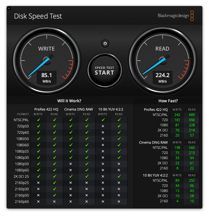

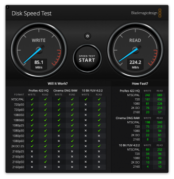

I tried this a few years ago with an SD card I had lying around. Booted very slowly. More recently, I used BM Disk Speed Test to check a much faster (V30) SDXC. It came in at about 80MBps - about the speed of an HDD. There's more to boot speed that what's measured with this simple test, but you're way better off with @Fishrrman 's advice.

Sounds like a single thunderbolt 1 pcie lane on the 2012. Don’t forget that the port itself may not support high speed cards. Flash cards won’t have anywhere near the wear resistance and read write flexibility of SSD though.
