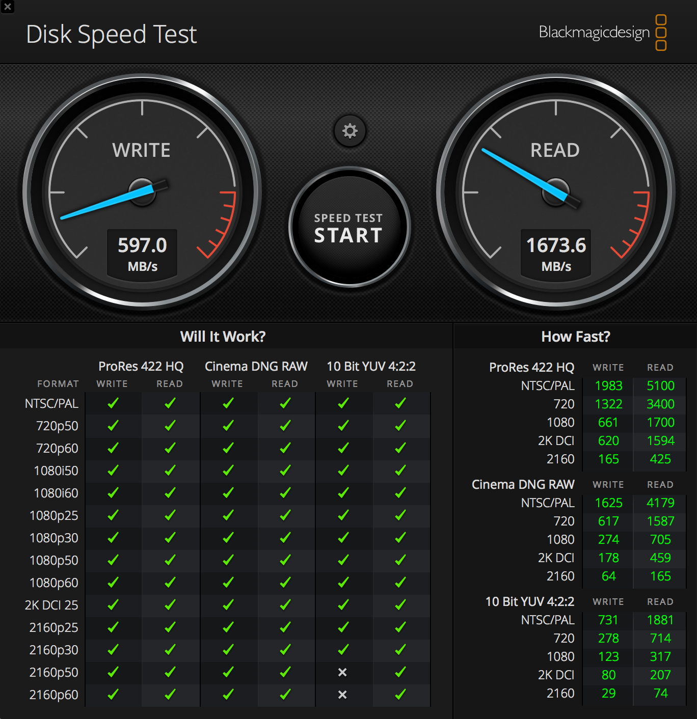

What could help out here, is if you'd use a benchmark utility such as BlackMagic Speed Test (free), and then post the read/write speeds you're seeing RIGHT NOW.
If you boot and run from an external USB3 SSD, you should see reads of about 430mbps and writes around 350-375mbps (depending on the drive make, model and size). How would this compare with what you're seeing NOW?

Thanks - here's what the BlackMagic program shows - (screenshot attached)
One SSD I was looking at - Currently $299 on Amazon
Rocket Pro 2TB NVMe USB 3.1 External Aluminum SSD (SB-2TB-NVME)
But maybe my R/W speeds aren't the issue at all - not sure now....

I'd say you are having software issues. My guess would be using an older version of Mac OS with the latest versions of LR and Photoshop. Nothing wrong with your drive speeds. I use a 2012 i7 iMac with an internal 1TB running at SATA 3 speeds, which is around 500MBps and I also use LR and Photoshop. I have no issues like you described. Everything is fast and responsive. So is the internal 8TB HDD. Granted, our workflows may be different but that’s what I would look into first.

The internal speeds you're getting right now (as reported in post 3 above) are just fine.
If you want/need "an alternative boot source", get a USB3 SSD -- it will work good enough (but won't be as fast as the internal drive is per your results).
