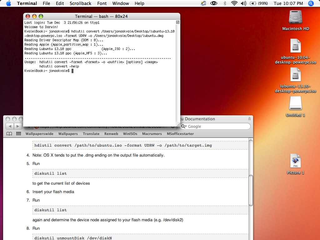

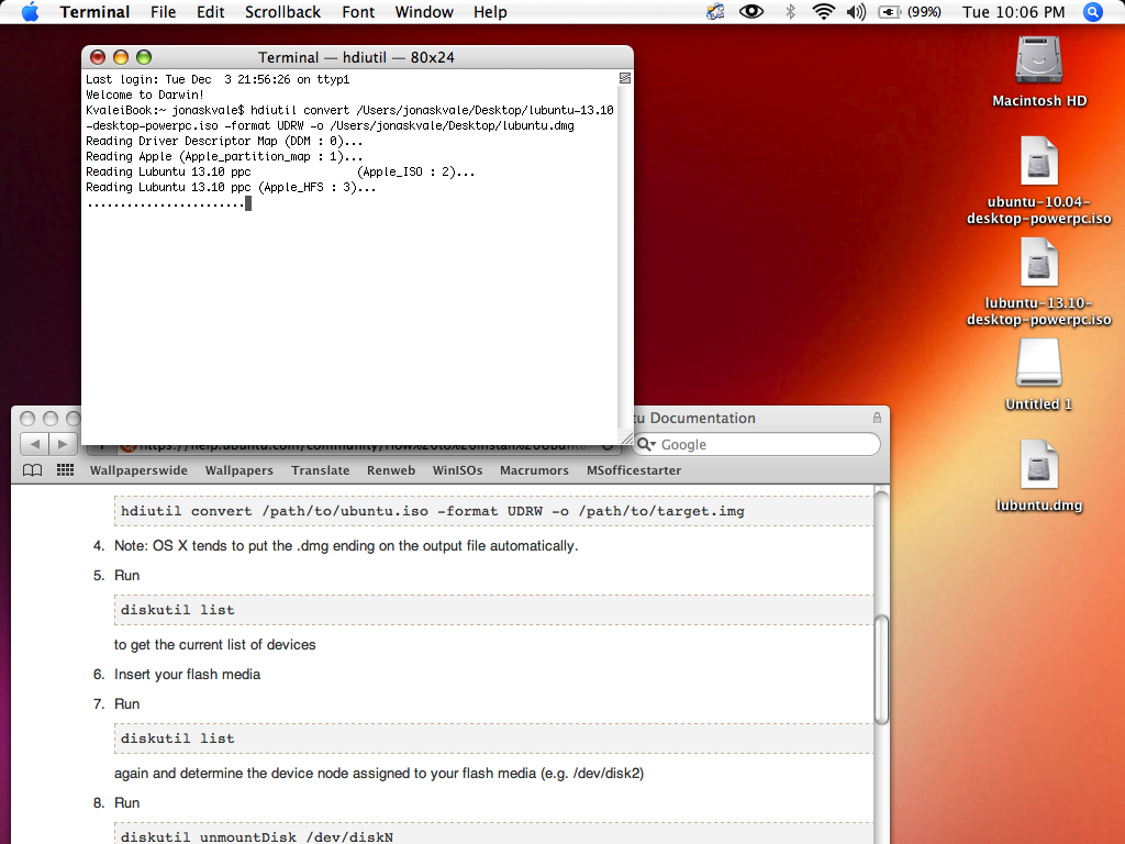

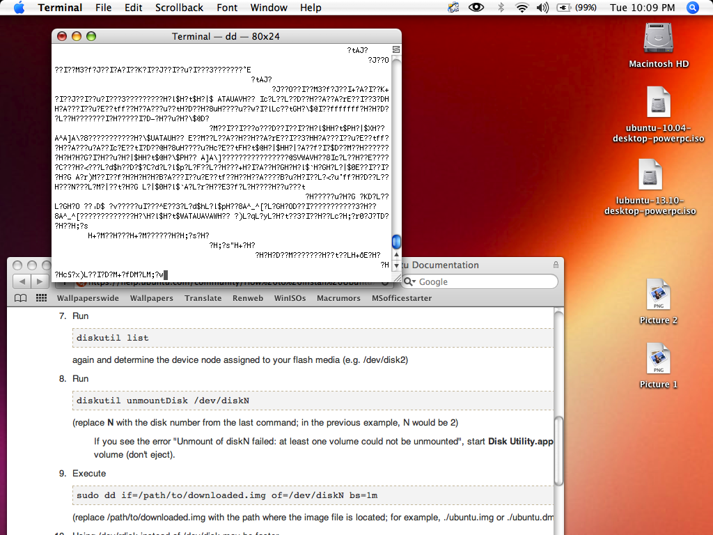

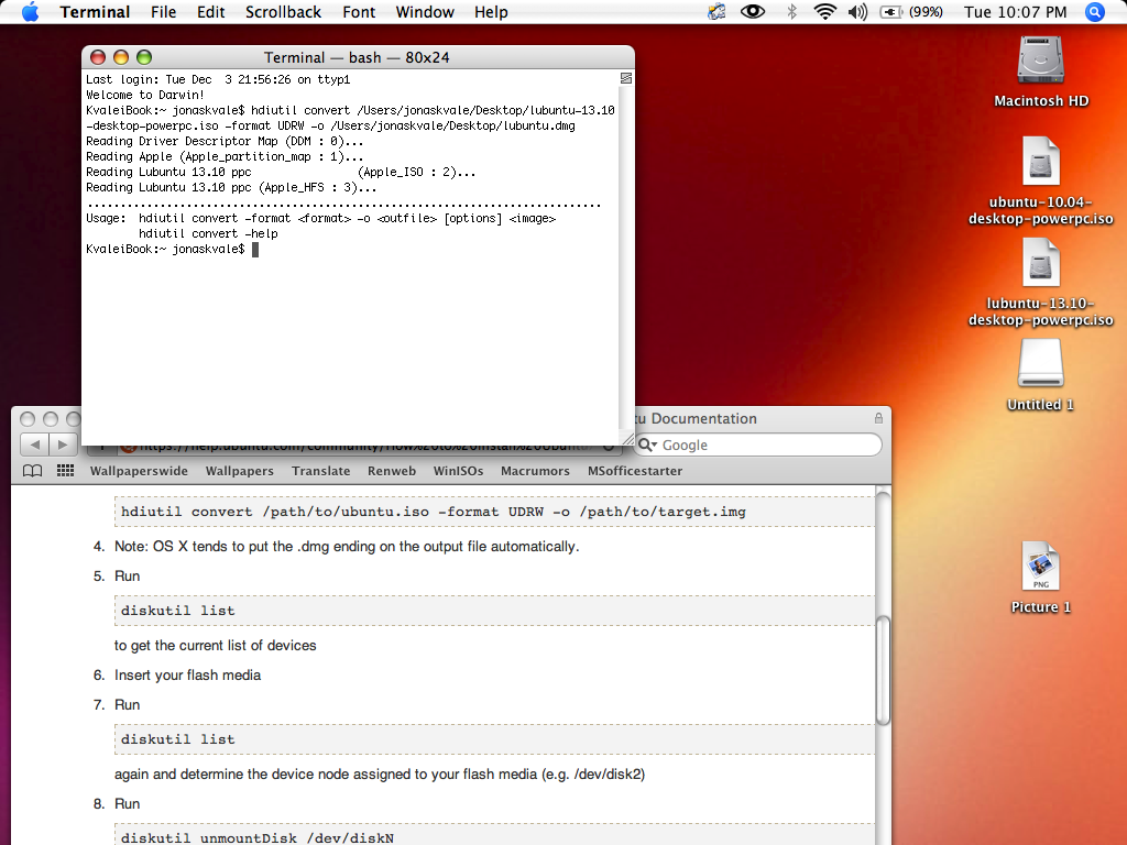

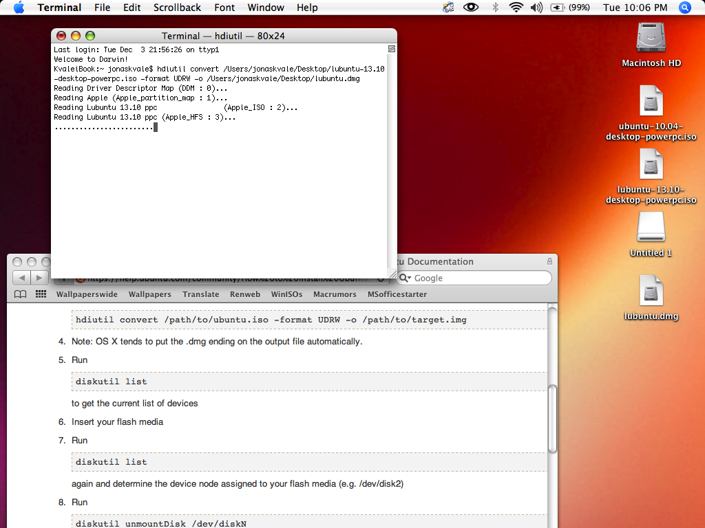

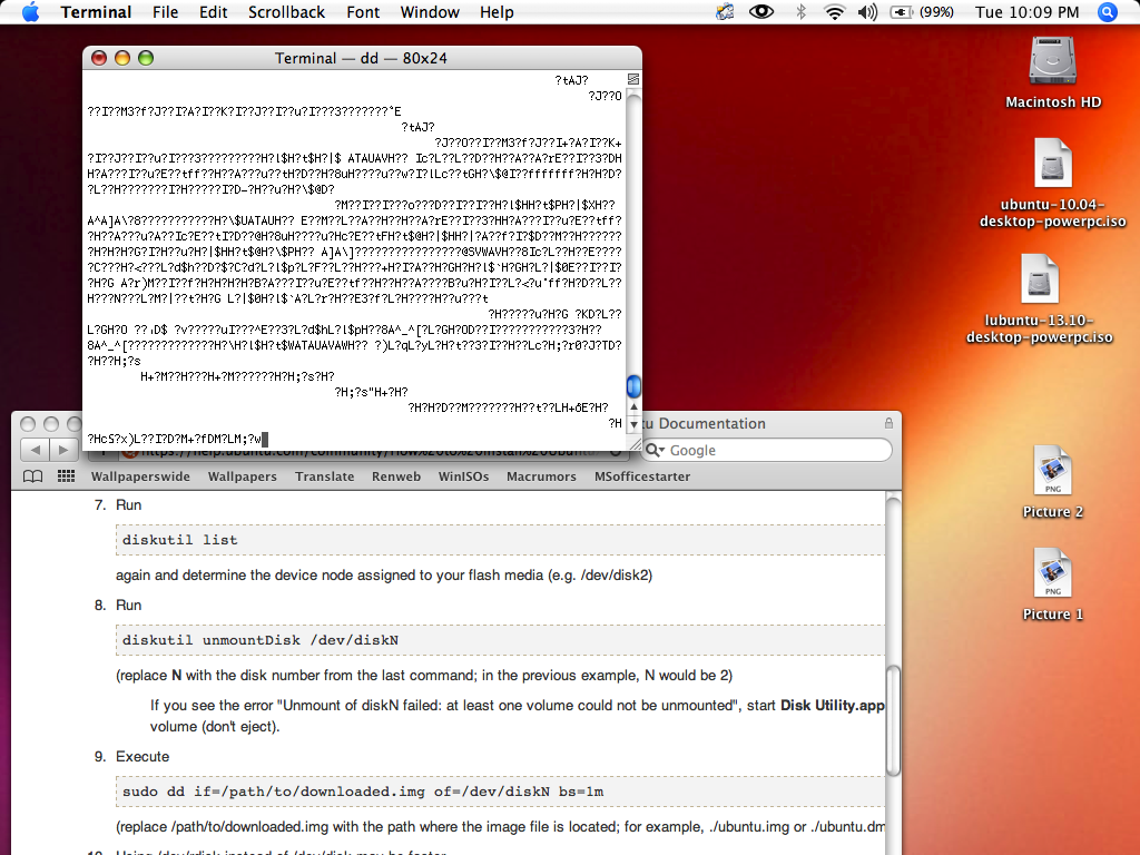

I finally got the terminal to work but....
Results in order of pics below.
First, all seemed to work well. It put the .dmg file on the desktop while it was working.
Second, after it finished, the .dmg file disappeared, and I couldn't find it ANYWHERE.
Third, I began to finish the commands necessary just in case I actually WAS doing it right, I have no idea. Suddenly, as I typed in the dd command, it came up with this HUGE error message, hundreds of pages long, and my 'beep' noise on my computer kept going off. What did I do? I had to force quit terminal, and nothing seems to have happened to anything. I am totally lost.

If you go back and read my earlier post, I said to skip trying to convert the iso to an img (dmg) file. That step is not needed and doesn't seem to work--as you have found out.
Go down to the bottom of the page to "other procedure" and start with line #3. This is all you need to do:
3. Run diskutil list and determine the device node assigned to your flash media (e.g., /dev/disk2)
4. Run diskutil unmountDisk /dev/diskN (replace N with the disk number from the last command; in the previous example, N would be 2)
5. Execute sudo dd if=/path/to/downloaded.img of=/dev/rdiskN bs=1m (replace /path/to/downloaded.img with the path where the image file is located; for example, ./ubuntu.img or ./ubuntu.dmg).
