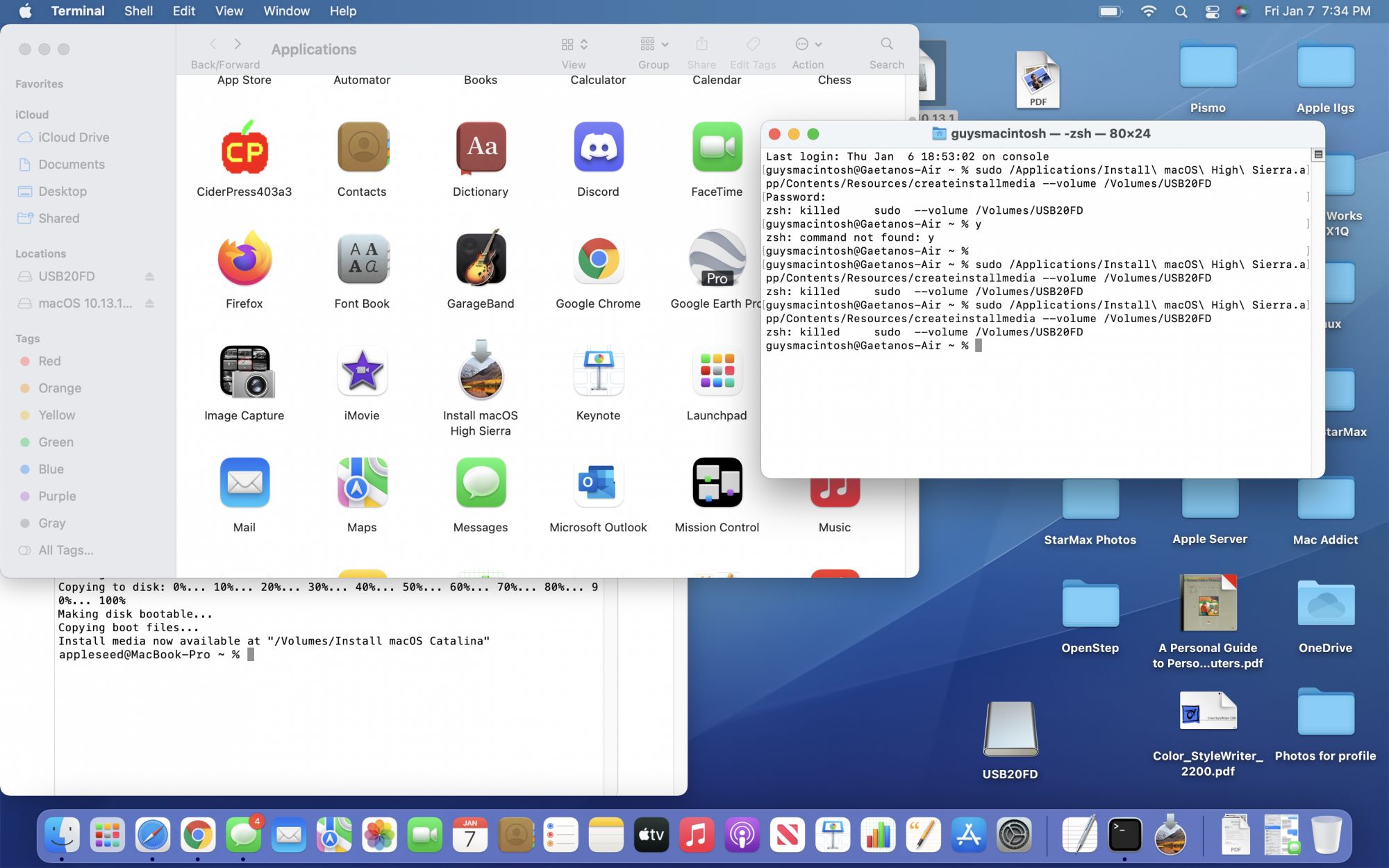

There is an extra terminal command you need to use to create the drive from M1 processors. you can find it in the forums here somewhere.
Also, Apple signs the packages with internal certificates with expiring clocks. Whatever you downloaded that is NOT from Apple might seemingly create a usb drive but the actual install might fail. Get the real DMG from Apple. They will have high sierra on their website.

They won't let me download it from My MacBook Air. It seems like you have to have Developer credentials to get DMGs for OS's that aren't supported on the machine you are downloading to.
I wonder if the DosDude High Sierra Patcher launches on M1 Macs. Cuz if it does, you can just use that to download High Sierra. It has a direct link to the latest installer from Apple's own servers.
However, if you already have the legit up-to-date copy from the link you already found, you should be able to make a USB installer using the Terminal, as long as you have the right command entered. It's different for different OS versions, and it may be different on M1 Macs too.
Also, it should be noted that some USB drives won't boot a Mac. I have two Lexar USB drives. One can boot the Mac, but the other cannot.
I wonder if the DosDude High Sierra Patcher launches on M1 Macs. Cuz if it does, you can just use that to download High Sierra. It has a direct link to the installer from Apple's own servers.
I'll give it a try. Even if that works, It does not look like I will be able to use Disk Utility to make a bootable USB. I am reading through the thread that Halfapie posted to figure this out
No, Disk Utility won't work. Or at least, it never worked for me. You need to enter the correct Terminal commands.
