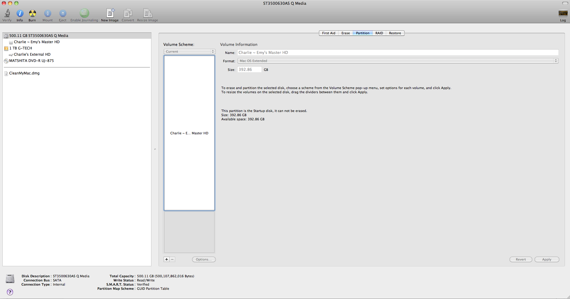

Here is the shot requested...
Now we are finally at the screenshot I requested in my first response, but you have changed things since your last post so I don't know what the situation will be by my next suggestion.
It looks like there is an issue with your main partition.
There should be an indication that the partition can be resized in the lower right corner of the partition. (See for example: http://macs.about.com/od/applications/ss/diskutilitysize_3.htm). I believe that was true in 10.5 as it is in 10.6.
Since it is not there, we need to get some info on why. Your OS X partition may not have journaling turned on (I seem to recall that non-journaled partitions cannot be resized on the fly).
ON THAT SAME SCREEN. Can you please click on the OS X partition and post a screenshot?
EDIT: Can you please confirm that you are in fact running OS X 10.5.6 and not 10.4.x? Your screenshot looks strange. Not only does it not show the resize option, but it shows your OS X partition as completely empty. Some of it should be blue. See the difference here: http://www.creativetechs.com/iq/leopard_disk_utility_can_resize_partitions.html

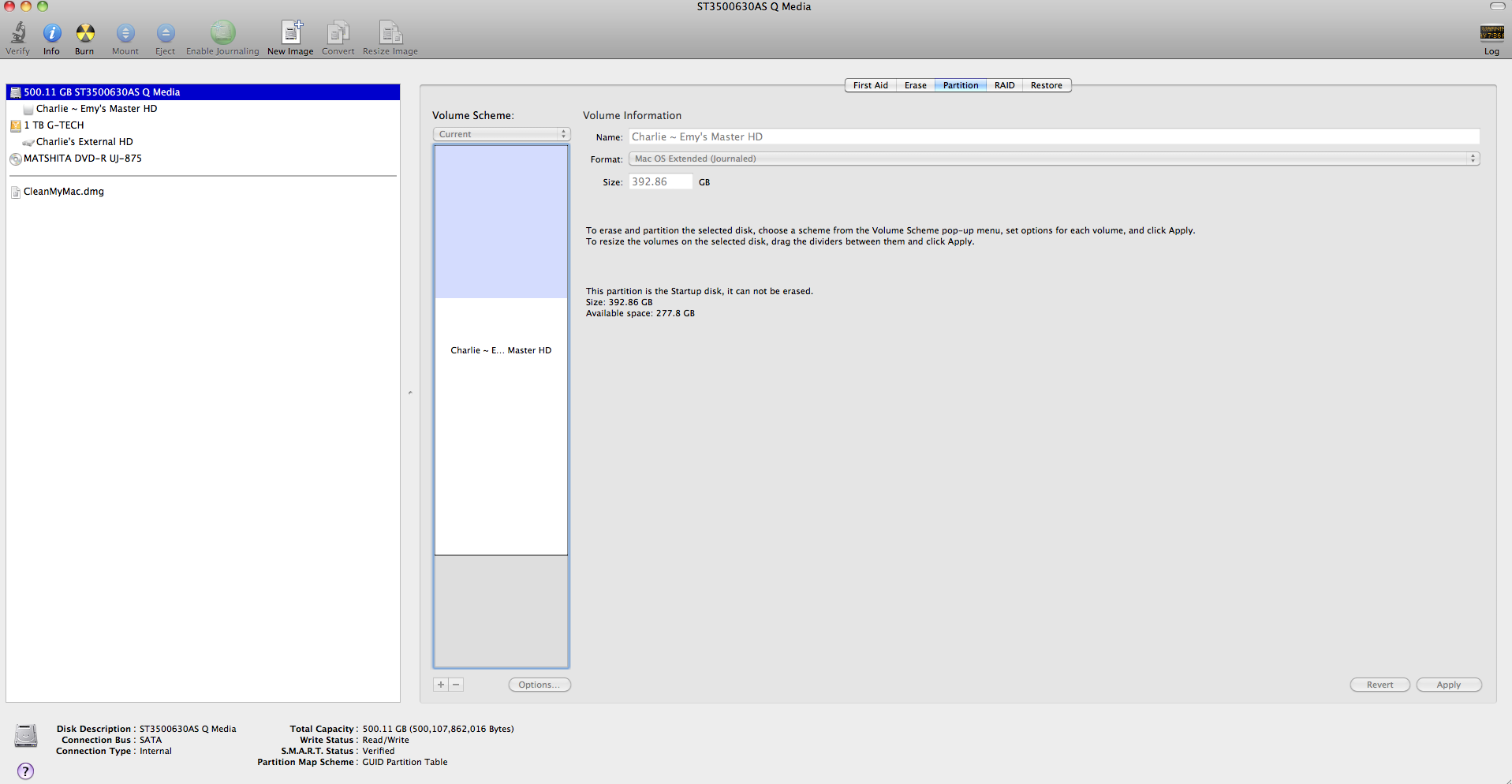

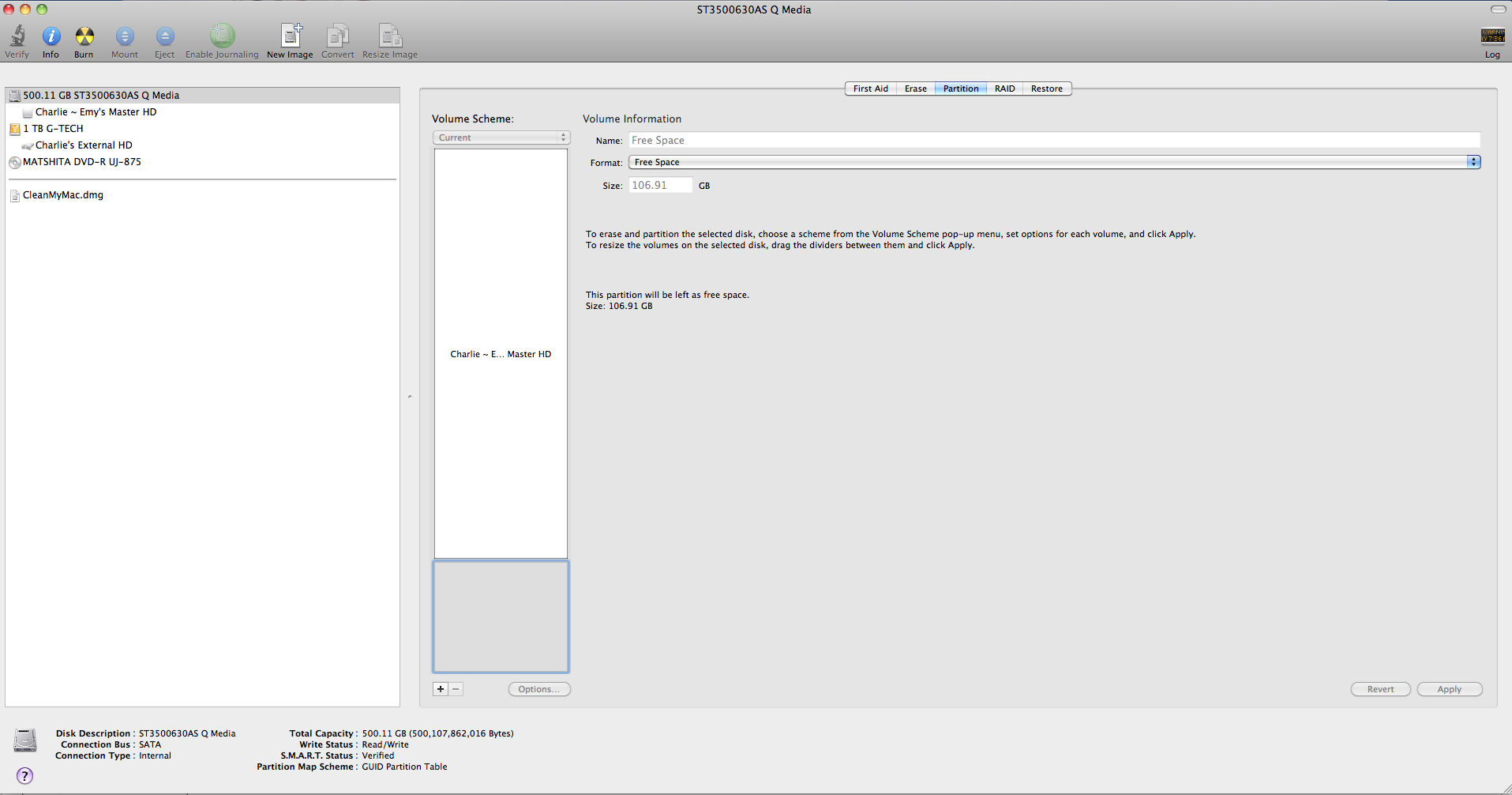

Here are the shots requested
OK 10.6.5 not 10.5.6. Makes more sense, but still surprising that you don't see any blue used space in the partition. Could have to do with journaling being turned off.
Now you want to select the Main OS X partition "Charlie ~ Emy's Master HD" in the left hand panel of the window. See the green icon labeled "Enable Journaling" in the tool bar? It should light up/be enabled now. [If not, post screenshot]
Click on it to enable journaling. [If that fails, post screenshot include error if there was one]
Return to the Partition Tab. Do you have a resize indicator in the bottom right of the "Charlie ~ Emy's Master HD" partition now? If so drag it as far down as it will go. [If not, post screenshot]

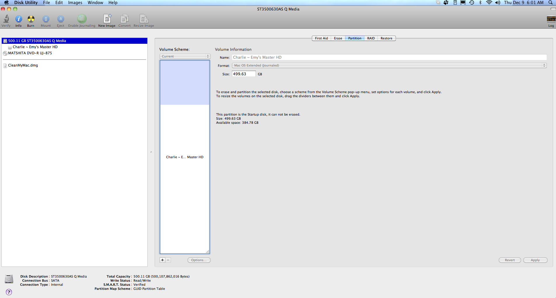

Fusion/Windows
Finally....thank you so much for all the help you gave me....you were very patient although a little edgy at times 🙂 I did what you said and booted off the install disk and worked from there...again, Thank You!
