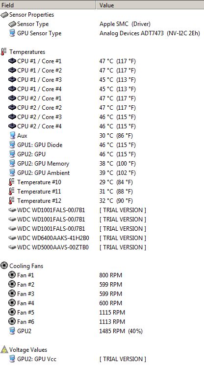

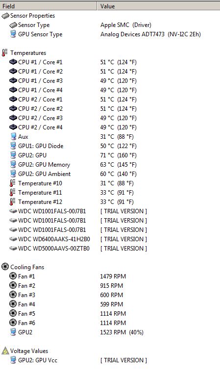

I placed the GT120 one place upper in slot three. So there is enough space between the 285 GTX and the GT120.
Here two pictures: The first before playing crysis (desktop - idle), the second one after crysis crashed. Max temperature of the 285 GTX in Crysis was 77° C.
GPU1 is GT120
GPU2 is 285GTX
I'm thinking of a faulty 285 GTX...

Sorry I missed your post. Yes, sounds like you have a bad GPU. Take a look at the link below... Good luck.
http://www.playtool.com/pages/artifacts/artifacts.html
