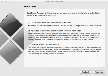

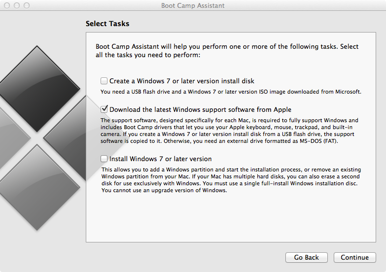

Try getting a blank USB drive and firing up Boot Camp Assistant in OS X and only choosing the option for downloading the latest software. Then install it in Windows off the USB drive.
Interesting I tried to launch bootcamp assistant and got this message...
How is your startup disk configured?
It was just OS X and windows. But I think I found the problem. To install os x I needed to install windows 8 then upgrade to 8.1 then to windows 10. I remember the 8.1 update causes the partition table to become corrupted. I checked the disk in disk utilities and found two small partitions which I believe is causing my problems. everything is backed up so now I reformatting the disk and will restore windows via incline and see what happens.
Sounds like a good plan and remember to download the updated Boot Camp 6.x software using the method I stated through Boot Camp Assistant.

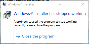

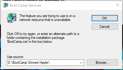

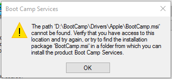

When I try to install it on my Windows 10 partition, I'm getting the below series of errors. After the first message it gives me the second, advising me to find the BootCamp.msi file somewhere but it's nowhere to be found on my computer (per the third error). This has been happening since Boot Camp 6 became available, I simply can't update. Has anyone else seen this happen when trying to install?
