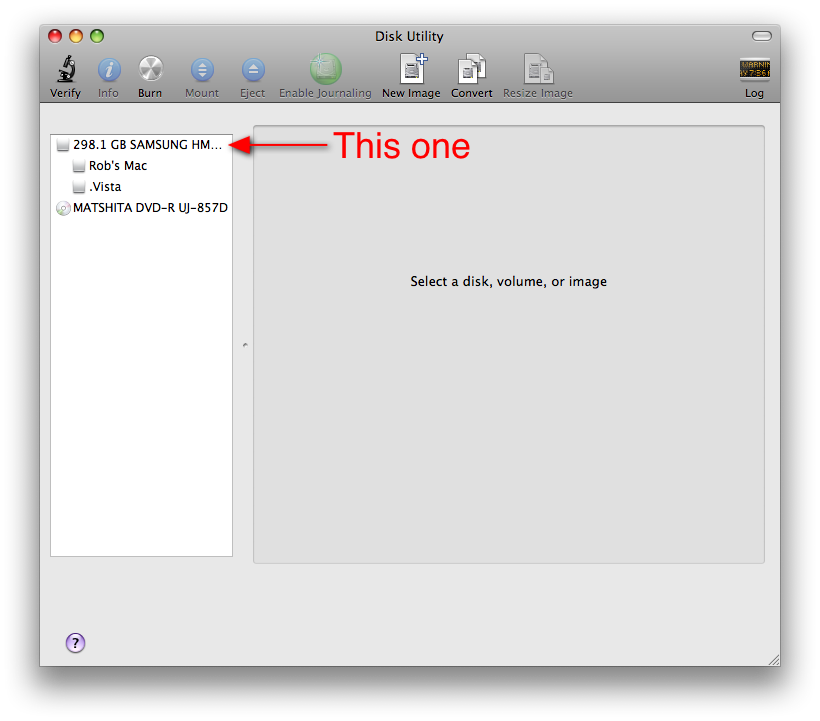

You should be able to choose the disk itself in Disk Utility, not the partition.

Tried that. It is still giving me grayed out options... won't let me choose a volume format or click erase... no options to click at all. 🙁
