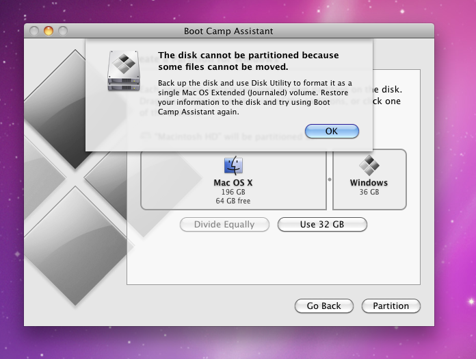

Hello there,
I just restore my Mac OS to a single partition and then I tried re-partitioning but it's giving me an error.
I've tried several times, tried using different sizes every time. My HD's capacity is 250GB, and I've got 108.95GB free. So I am sure that making a new partition of 35 - 40 GB is not a big deal.
I also tried using Disk Utility, both from the Mac OS install disc and while using the Mac OS itself, but it keeps giving me this error.
I do not want to format my Macintosh HD's partition because I don't have an external HDD on me at the moment so I will not be able to back up. I have a lot of important data that can not be deleted.
If anyone has any solution, please let me know.
Thank you so much!
Solution.
For whoever stumbles upon the same problem and wants the solution, here is what I did for it to work: I inserted the Mac OS install disc, rebooted the computer, booted into the install disc and opened Disk Utility. Then I verified and repaired the disk.
Then I restarted into Mac OS, ran Boot Camp, and VOILA partitioning worked like a charm.
