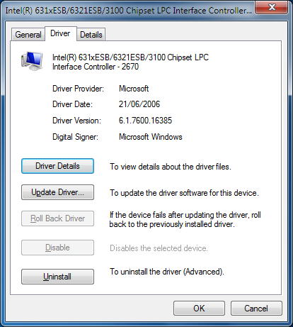

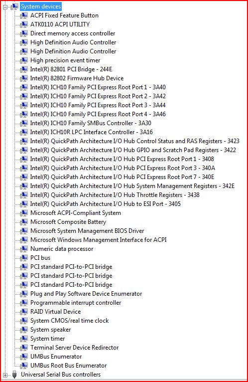

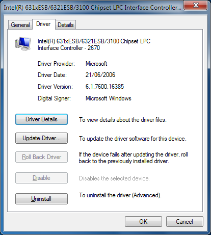

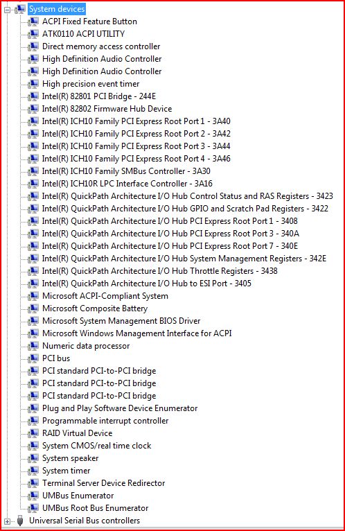

Ok. Here's one for you (a little test):
Is that the best driver or not? Note: the driver provider is Microsoft.
That probably means it was not put there by the Boot Camp driver
installer. Similarly, most of these drivers under the "System Devices"
branch are provided by Microsoft, not by Intel. Is that what one
would expect for this Intel chipset?
Something odd I noticed: when I checked "Programs and Features"
in the control panel, it was clear that Apple's program had installed
support for iSight, infrared remote, multitouch and touchad. I don't
think a Mac Pro has any hardware that would justify installing that
stuff. Bizarre.

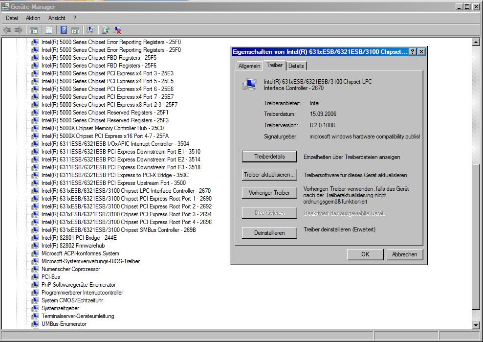

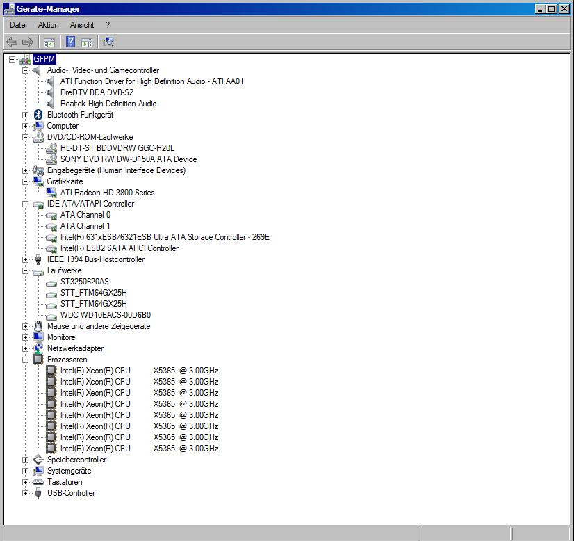

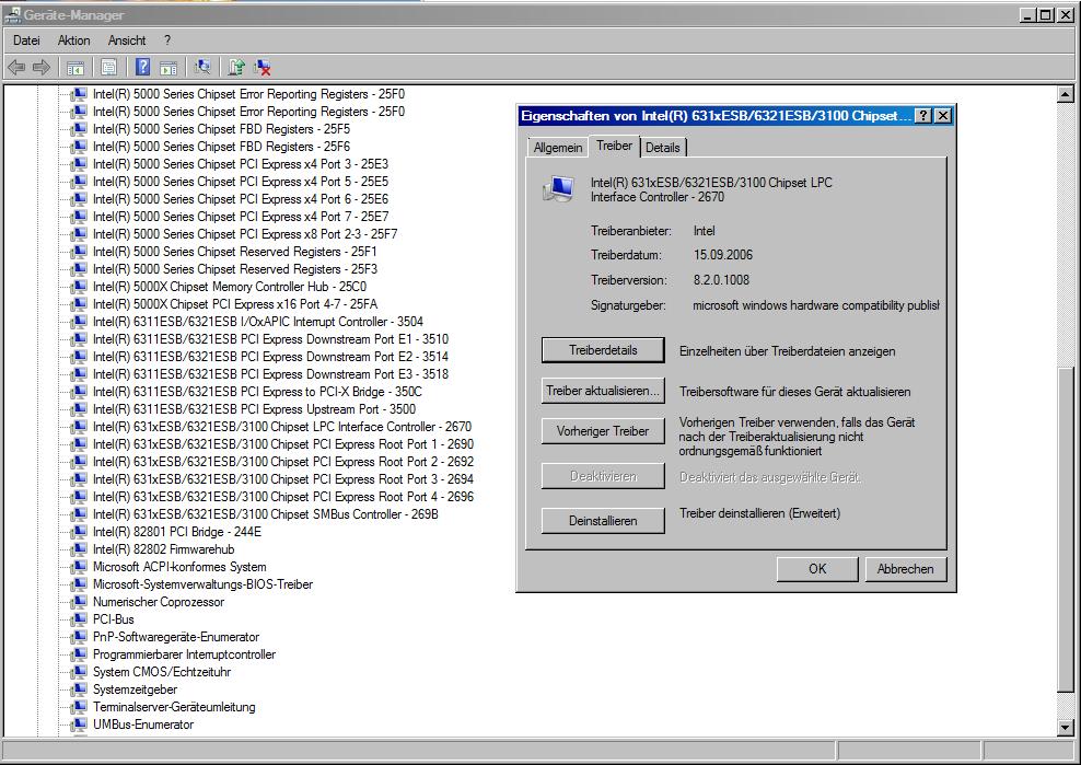

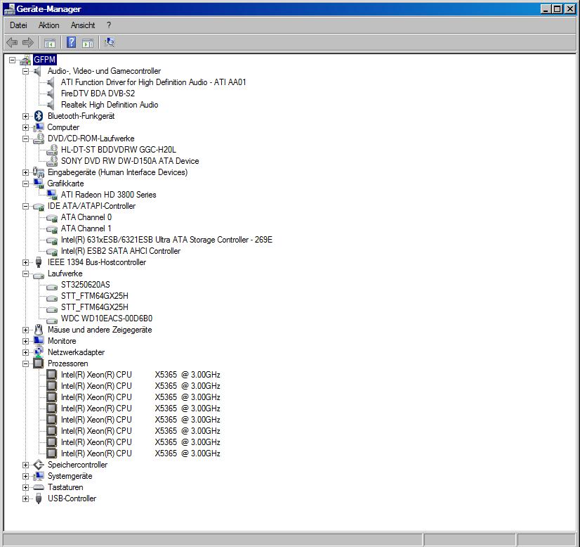

My MacPro1,1 has an Intel driver.
