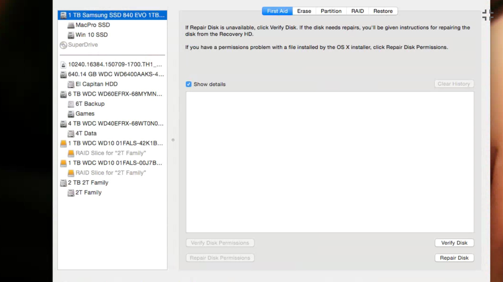

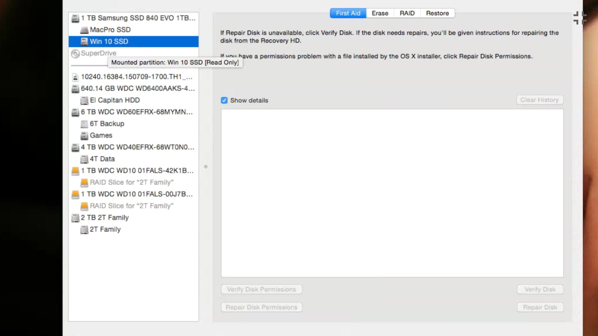

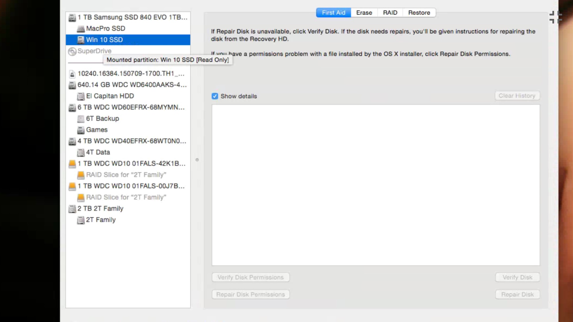

So, no matter which one you choose (like the following pic). The repair disk still gray out?
Not avail if choose partition.
Avail of choose disk.
