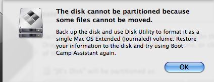

I put a new HD in about 4 months ago, and I'm trying to partition bootcamp and got this error message.. Do i need to Reformat my HD?

The best solution seems to be to clone your existing OS X set up to an external drive, reformat the drive and restore the clone... then run Boot Camp Assistant again

Then boot my mac using my Mac OS X disk and reformat my internal HD using the mac OS Extended (journaled) option..
Then using my cloned hd, restore my mac?
Is that a rough idea how it will work?

Yes, that is how it works
And yes, you could do it with Time Machine as well
Either method would work
The point is to get your data all in one place on the HD so Boot Camp Assistant can non-destructively partition your drive
