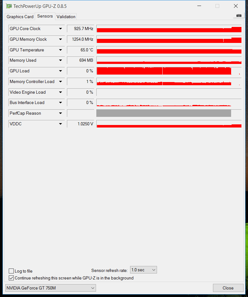

There is the readings of gpu-z program showing the clocks when running Dota 2 :
capture-png.575433
As we see it fluctuates constantly in game, only when I press alt+tab and go desktop it locks to stock clocks. It does not pass 80 celsius and stays around 70-75 in-game.
Can 650m users share their gpu-z readings (clocks) while gaming on bootcamp ?

This morning I booted into windows directly and ran a steam game called nosgoth. I finished one round and gpu-z readings were stable, 1.0250v VVDC constantly, therefore clocks were stable at stock clocks. No problem at all at first. But after another round, lags started and gpu-z showed like 0.0950v or 0.0850v VVDC. So GPU basically does not receives enough power, and beacuse of the downvolt clocks fluctutate, game starts to lag.
I realized the power adapter was cold while gpu was operating at 1.0250v. After two rounds of gaming, (it should be like 10-15 min) power adapter was hot. It seems it is a heat issue, but it still does not makes sense to me because I remember back in 2012 I was running games stable with 650m, even with a very hot power adapter (I was using it to warm my feet because it was winter 😉).
I noticed when I launch the game Nosgoth, or alt-tab from windows to it, the background of the menu turns green and pixelates. It backs to normal after 10-15 secs. You can see the background below, it shows an area with flames, buildings and trees. Does that mean why card is faulty ? I am upset because of this problem, and i am starting to think my card is faulty.

I performed a test while the power adapter sitting on a ice bag, and played game like that. It still downvolts and downclocks. It is not about power adapter/heat.
Then I performed a second test as you said : cpu power state set to %100, it was forcing cpu at 3.6 ghz turboboost constantly. Played game like that, nothing changes. Same downvolt, same downclocks. The performance has not get worse or better or had not occur sooner.
When I was playing at evening, after some fluctuations card locked itself to the downvolt and clocks as 765/1000. As you can see below, the line is stable in-game before going into desktop (going into desktop makes clocks back to 925/1254 instantly).

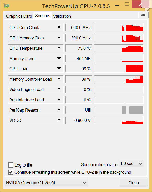

I am on w8.1 right now, using default drivers and ran a Furmark GPU stress test :
Downvolts started to happen when card reached 80 C. I have not tried in game, but it is the same, Furmark just accelarates the process of downvolting. And lowest voltage card reaches is 0.9000V, which equals 660/390.
And here is the readings when playing Nosgoth. Gaming is worse than W10 :
I even set max cpu state at %50, and the problem still persist.
Do you think I should try with w7 too before going to service ? It is too hard to describe this problem with this machine, though. I am sure it would do the same downvolts in OS X in intense tasks and gaming.
It will always downclock in furmark. That is done by the driver just because AMD/Nvidia despise Furmark. Use 3dmark or games for load testing. Furmark is unrealistic and really not good for anything these days. It is a stress testing utility and since modern gpu's aren't built to actually handle using all their execution units at the same time at high clocks, it isn't even any good for stress testing. Forget furmark.
