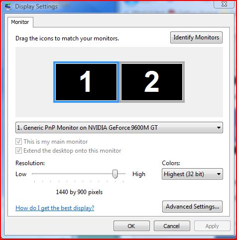

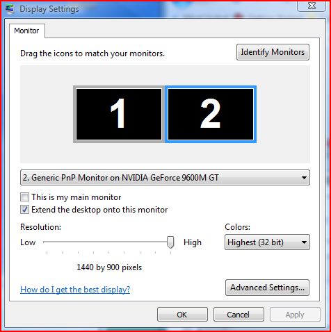

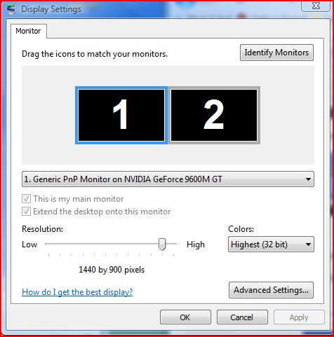

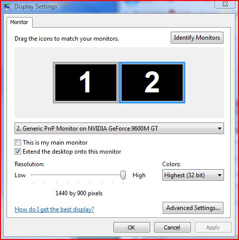

this may be due to you running an older version of windows than me
im on windows vista ultimate, and this is what mine looks like.
this is the setup with the external monitor as primary and the mbp monitor extending it. to change this i click, this is my main monitor on the second window and it simply swaps them around
