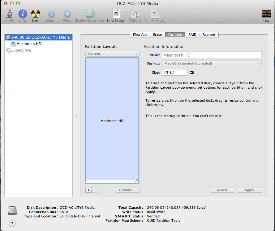

No idea why it won't be working. Would you at all be able to go into the root hard-drive in DU, and click the 'Partition' tab (see below)?
Sorry for asking you to do all this 😱
Its ok, its REALLY weird to me too, does not make sense at all. There are no updates in SU period, I am running 10.8.4 fully upgraded. Bootcamp just doesnt want to work for some reason.
Here is my partition map:
