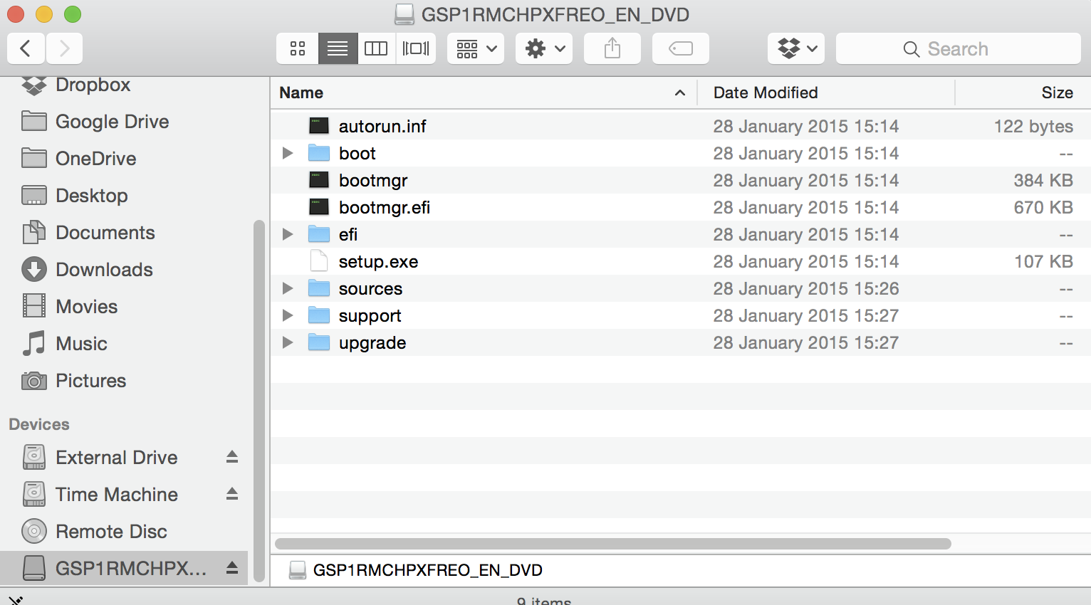

Thanks guys, exactly which file I have to copy to the HD? It looks like this the USB stick content, there is no .iso file

Looks like you have an installer for Windows 7 Home Premium.
Since you don't have the ISO you can just uncheck the first checkbox in Bootcamp assistant and just let it create the partition for you.
Then you'll just boot off of the USB you already have and then download and install the Bootcamp drivers manually.
Or you can re-download the matching ISO fie from here:
http://www.techverse.net/download-windows-7-iso-x86-x64-microsofts-official-servers/
and then use Bootcamp normally with all three checkboxes checked.
You could also try using a second USB drive and instead of copying a file from your USB to your hard drive, direct Bootcamp to your original USB drive as the source and the second FAT32 formatted USB drive as the target.
I've never tried that though -- not sure if it would work.
