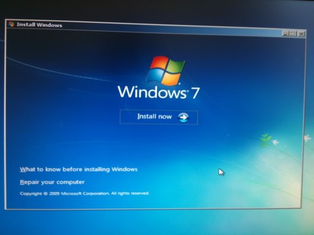

Do you have a working Windows Setup disc or ThumbDrive? I really should have asked this before. Maybe your Windows setup media (disc/flash drive) is wrong/broken?
It's not necessary to use the Boot Camp assistant. Your manually creating the partition using Disk Utility. You can try it but I don't know if it will get confused with 2 drives installed.
If you need clarification on any of the steps, feel free to ask.
This is Windows Setup -
