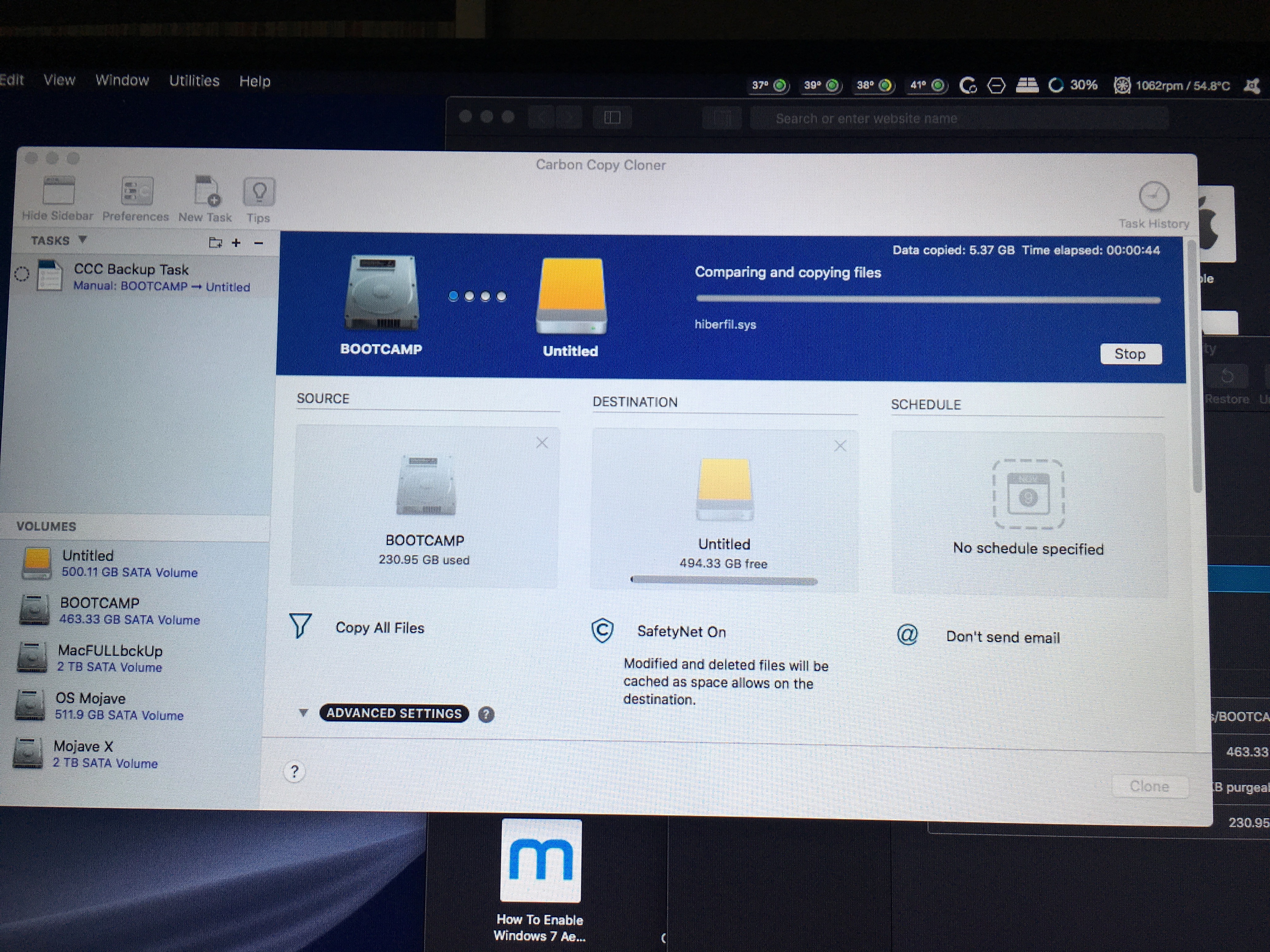

I just ran into this myself, and I was (am) trying to migrate my HDD Bootcamp installation to an SSD with Bootcamp Assistant. I have 4x 1TB drives, two are SSD and two are HDD. So, I reckon, I shouldn't have any limitations...?
In the process, I would also like to re-install Mojave from scratch, as it's become too slow over the years, upgrade after upgrade after upgrade. (Got my cMP with 10.8). For reasons too long to explain here, I do NOT want to reformat my W10 partition, which is running fine.
Any suggestions?

There is a dedicated forum here for all things Windows--suggest posting over there for more (maybe better) help. But basically what you want is WinClone by Twocanoes. It is purpose-built for moving Bootcamp partitions around.
Reactions: CocoaNut
I've looked at WinClone, and it won't work for me. I'm not going to spend $40 on something I will use once and probably never again after that. That said...
Since I'm interested in reformatting my macOS partition anyway, do you think I could downgrade and reformat with High Sierra? I will upgrade to Mojave later.
Since HS contains a version of Boot Camp that will work on the cMP, would it though see my current W10 partition, and allow me to move it? Otherwise, I already have a cloning utility on Windows which I can use to move the partition from the current HDD > SSD.
Thoughts on this?
I guess I could be wrong but my understanding is that Boot Camp Assistant will only create the partition. It won't move it around once created (that is one of the reasons why WinClone was created in the first place--because BCA is so limited in what it can do). Maybe others will chime in, but truly, if you want more help with this from boot camp experts you should repost in the Windows forum--you'll got more help there.
Also, I'm nitpicking, but saying WinClone "won't work" for you is not really an accurate statement. Indeed it will do exactly what you are seeking. It's just that you don't want to pay for it (which is fine, but you didn't stipulate that you only wanted free options in your post asking for suggestions).
I would say if you have a method to do it via Windows then just do it that way. I'm not aware of any free tools to do it on the Mac side. Just make sure you back up your data and partition scheme before you experiment.

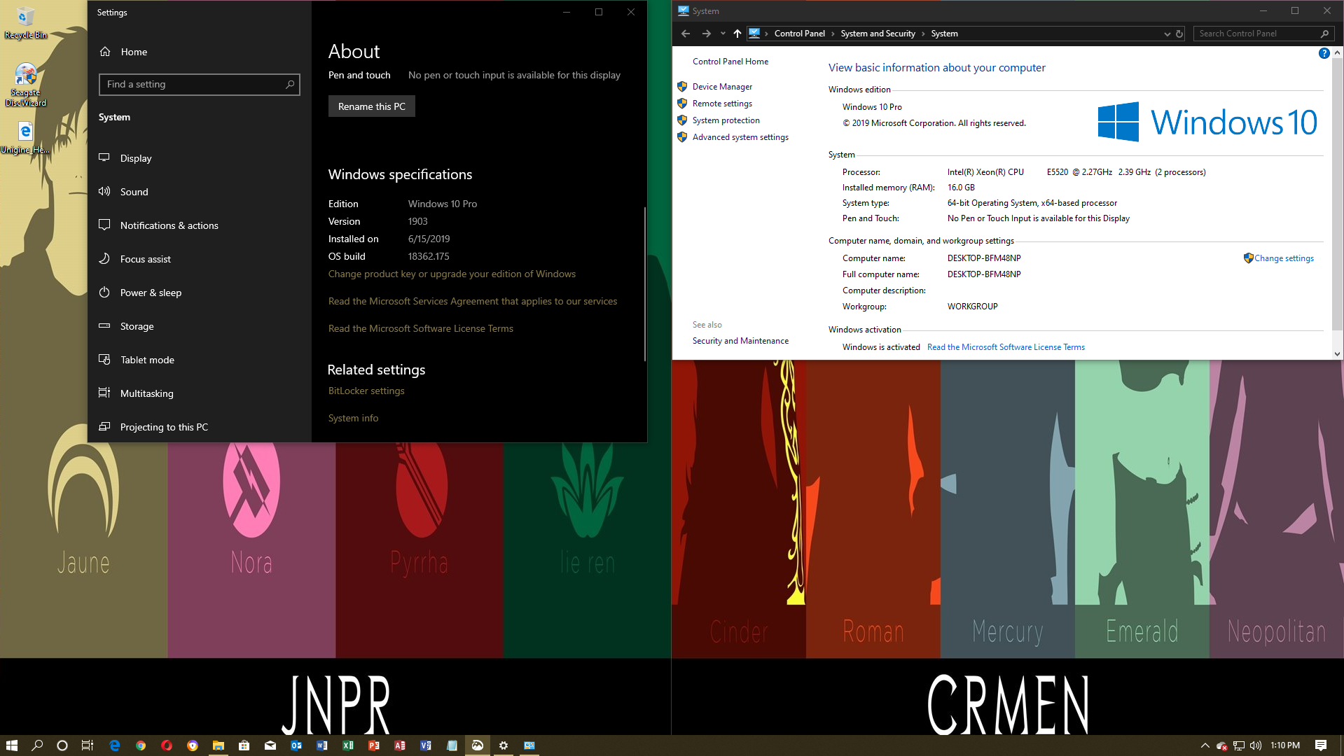

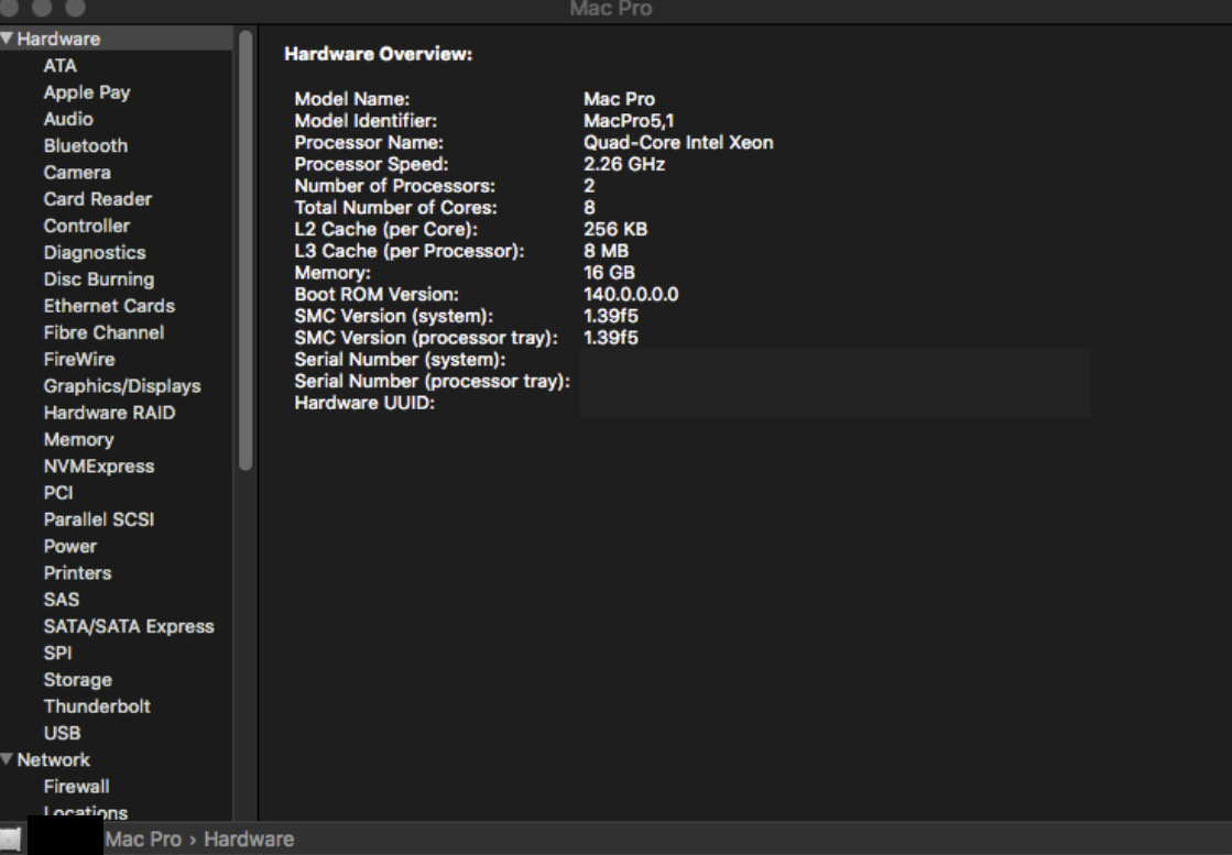

I've been running Windows for my cMP for many years while it was supported form the Boot Camp Assistant. Then in 2017 things changed to prevent the cMP 4,1 from running Boot Camp. So I found a work around from YouTube that involved flashing the PRAM. During so with its required software provided by the YouTuber helped to get my 4,1 to run Boot Camp again. Since my system was taken from a 4,1 to 5,1 status. So I was able to update Boot Camp Assistant to change my partition I had years prior. Then as of 2018 the cMP 5,1 was also placed on the chopping block as like the prior cMP's before it. Which didn't concern me since I had already created a Boot Camp partition years ago. However after the update to Windows 1903 something gone wrong with the boot up after the upgrade. I ran into blue screen issues and the startup repair that Windows 10 has wasn't able to solve the issue. Which lead to me scraping the partition and using a SSD.
These are capable machines so I don't know why Apple thought it was necessary to prevent them from updating. But since seeing the new cMP introduced this year it's clear what Apple's intent was targeted towards. That said MacOS Majove is the last supported OS for the 5,1 cMP. The next MacOS coming later this year has new hardware requirements. Something not stricken as form the Developers Beta yet. Apple will purposely required the software to check for components to make sure that neither the old Macs nor any Hackintosh builds will be able to install the final release. I believe the T2 chip might me that wrench!
FYI, If you have a PC ONLY Graphics Card (non Apple Graphics card) installed in your cMac Pro you will NOT be able to see the Boot Menu by holding down the Option key at startup. However you can select from with in MacOS from the Start Disk menu. Getting back to MacOS is where things get complicated with a Non Apple Graphics card. Flashing the PRAM becomes the only option. And Apple doesn't plan to fix Boot Camp for the cMP. So people like myself decided to go all in with WindowsOS. Truth be told Windows 10 version 1903 included all of the drivers for my 2009 Mac Pro that has been software flashed to 5,1 status. I didn't have to install a thing. For my installation to a larger SSD I removed all the hard drives and SSDs I had inside my cMP. All except the one I planned to have Windows 10 installed. Prior to the removal I reformatted the hard drive to Fat32 (which is very important). After the install all worked well. Only thing I done was update AMD software that controlled my MSI ATI Radeon RX580. I haven't had any issues and it's been nearly a week.
