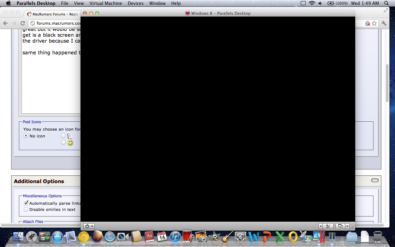

I have it running under Parallels 7 - works great but it would be so much better if I could get Parallels Tools installed. All I get is a black screen and I basically hosed my install because I can't uninstall the driver because I can't see it.
same thing happened to me... Im running it under parallels 6.
reinstalled windows 8 without parallels tools. For some reason I cant use any other apps besides desktop, control panel, windows explorer on the tile screen.

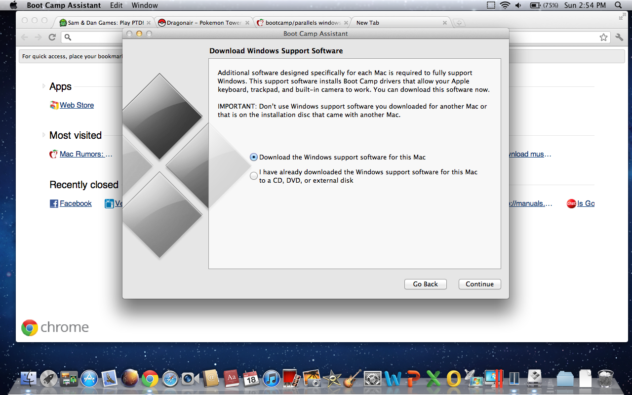

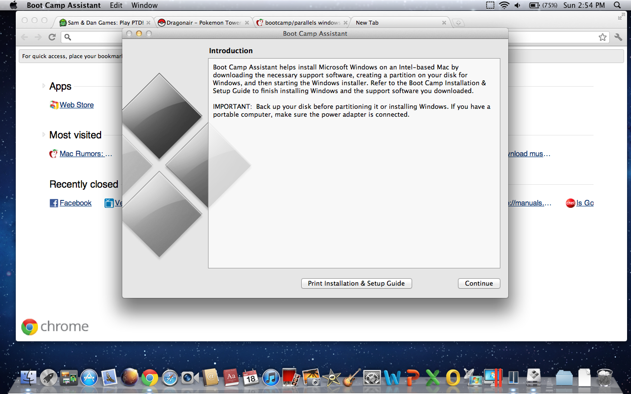

I have Lion, but bootcamp doesn't tell me to make any Bootcamp Drivers, i just read apple instruction but i dont know yet how to make the Bootcamp Drivers. Can you help me?? 🙂
Could anyone tell me a reason to why the tiles wouldn't be working and how you type a questionmark using virtualbox.
here is the screen shot. Go to bootcamp assistant... This is what I see when I open bootcamp assistant. If you dont see it try to download it somewhere else.

workaround for parallels 7 black screen of nothign
ok this was posted somewhere in the MR forums so the credit goes to that person, whomever he/she is... luckily i saved the parallels link so here it is:
Parallels_Support_Team said:
Workaround for issue with black screen in Windows 8 with guest tools installed.
Shut down virtual machine.
Open [Virtual Machine Configuration > Hardware > Boot Order] and locate [Boot flags].
In [Boot flags] write:
devices.video.pci_device_id=0x5005;
Run virtual machine. Install Parallels Tools (if not yet).
Known issues with that workaround: Coherence, Dynamic Resolution, Smart Mouse (Sliding Mouse) will not work.
However, Smart Mouse (Sliding Mouse) can be enabled manually.
Open [Virtual Machine Configuration > Options > Advanced] and set [Smart Mouse] to [On].
This will allow Smart Mouse to work in Windows 8 even when described workaround applied.
