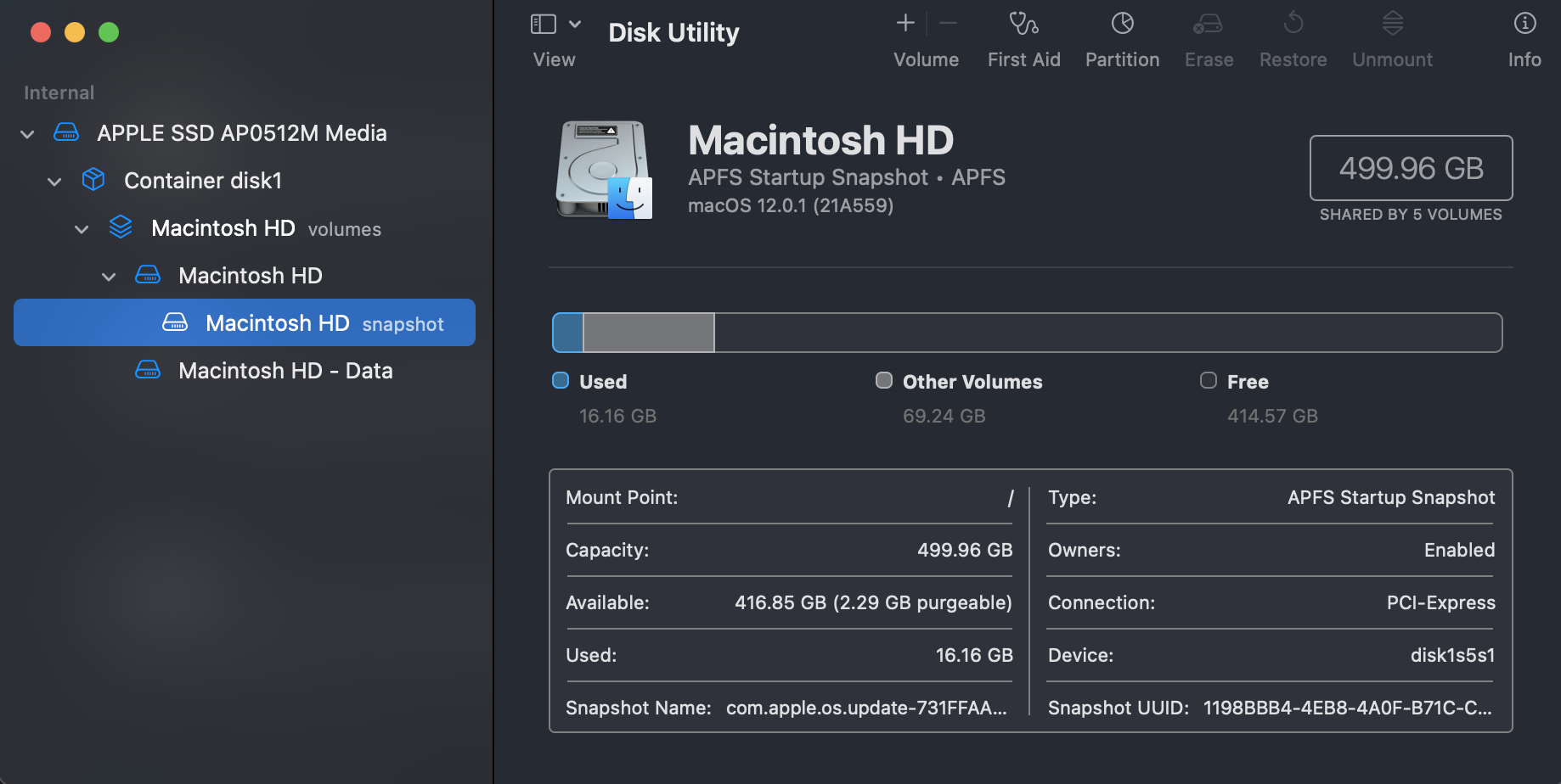

i have been unable to partition my ssd for bootcamp (manually or via assistant), and have read a bit about it. From what i can tell, it is due to the current configuration of my ssd partitions/volumes. I REALLY do not want to reinstall macOS just to set up windows via bootcamp. Can anyone depict a way for me to resolve this (via software or any means) without reimaging the macOS? Below is a screenshot of my current configuration. Thank you.
errors out
Bootcamp:
An error occurred while partitioning the disk. Please run First Aid from within Disk Utility to check and fix the error.
disk utility:
storage system check exit code is 8
storage system verify or repair failed : (-69716)

No, am not in the beta. I tried numerous times but it still failed. So, I did a clean install of Monterey but backed up using Time Machine to an external hard drive, but also to my Time Capsule. I still have one of those. Then after reinstall of Monterey, reclaimed about 300GB in the process and now the Boot Camp runs well. Installing windows as I type. So, this is the route that has worked out for me.
Boot Camp needs contiguous free space. So booting from another disk can work. It can't move locked files and Mac OS puts some at far end of the disk that cannot be moved, that has been true since day one - 2007 infancy when BC began.
