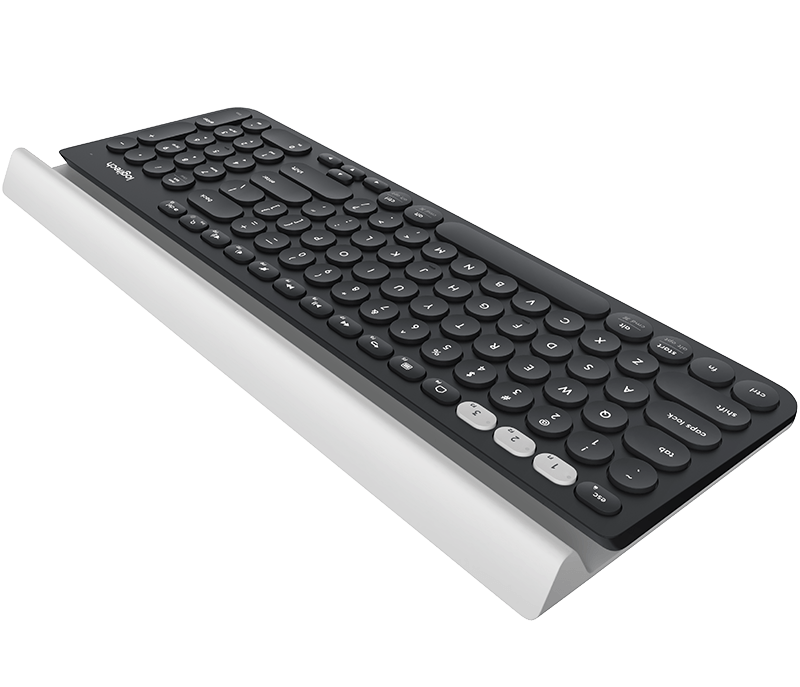

The left "Alt" key should work to bring up the boot menu.
[doublepost=1531826678][/doublepost]Oh wait is that your keyboard? If so it might be the "Start" button.

It's not really clear to me which key corresponds to "option."
If you are still stuck in windows, use the onscreen keyboard to verify which key is being read as "option".
(click on Start, and then type osk, or "on-screen keyboard". As you type on the logitech, the corresponding key on the on-screen keyboard should highlight. You need to find out which key on the logitech keyboard corresponds with the "alt" key.)
Now that you've identified it, hold down that key at startup.
