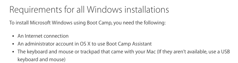

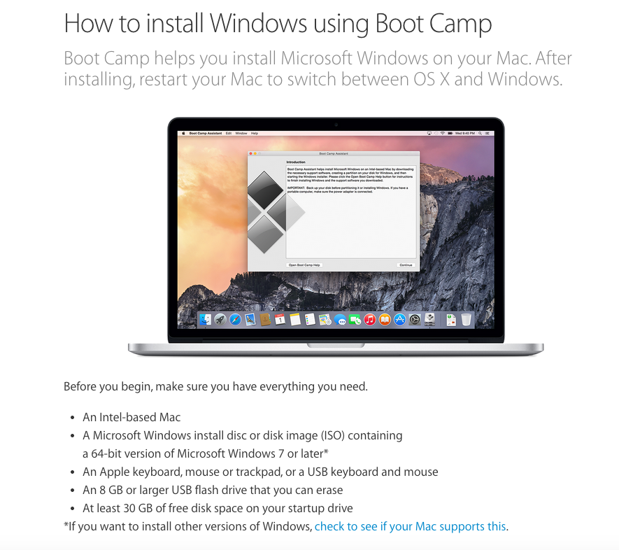

I have ordered Windows 8.1 full version for Bootcamp with my iMac. Just to confirm, the wireless keyboard will work during the initial setup of Windows 8 (when you type in the computer name and product code)? Apples site says this:
I think that ad implies a wired Apple keyboard because the wireless one needs a Bluetooth driver to work, and this is not installed until you run the Boot Camp Support Software after getting Windows up and running.

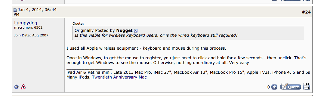

I think that the bootcamp 5 and 8.1 actually allow for wireless keyboards as here is a Macrumors comment from 2014:

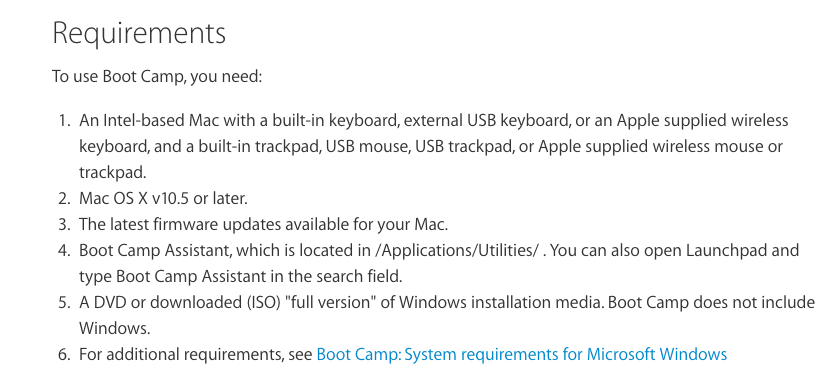

And this at Apple support says it should work also.
