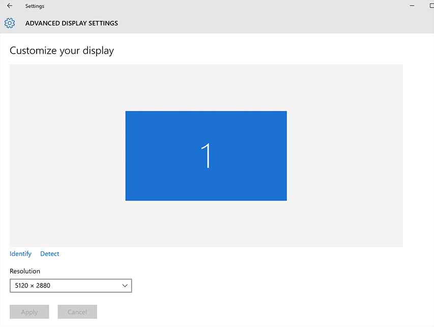

New Bootcamp update - Windows 10 is finally usable in full 5K on my Late 2014 iMac 5K (M290X GPU). Previously, 5K in Windows was only available for the new 2015 5K iMacs.
Also, fixes the bug where right click wouldn't work on my Magic Trackpad 2 in Windows 10.

I got the notification for the update as well. I have the M295X GPU and after the update, 5k worked, but I was unable to switch back to 4k and lower resolutions as all landscape resolutions became portrait resolutions (if this makes sense). Landscape is not an option in catalyst control center under these new drivers. Only Portrait, Landscape (flipped, and Portrait (flipped). I tried everything to get it to work and couldn't come up with anything. Games were also messed up at 1440p resolution for instance.
I uninstalled all the Radeon drivers using DDU in safe mode so everything was clean. And tried the new drivers again. Same thing. I can't figure out a way to uninstall the Bootcamp drivers altogether either. I'd like to be able to try that. I will try to download the latest bootcamp drivers from 10.11 and repair them in windows.
I reverted back to the old driver. Maybe on a fresh Windows 10 install these new drivers would work.
It's a bit upsetting as the software driver revision is slightly newer. I wonder if there were any other fixes/performance enhancements. I wish apple gave us bootcamp changelogs.
Does anyone else have the problem/s I mentioned above?

I don't have that issue with lower resolutions. But I have the M290X.

That's good that it works just fine for you. Thanks for letting me know about the resolutions. I uninstalled the old bootcamp drivers again and downloaded the bootcamp drivers from bootcamp assist, but they're the same display drivers as the old bootcamp drivers. No 5k yet on them. I checked apple software update, but the new bootcamp drivers don't show, however they show as already installed in the history log. Hmmm.
Does the 5k scale well for you in windows 10? As well as 4k if not better?

Windows scales well, with UI set to 200%, it's almost like OS X. Apps however - a different story. Some apps, like Photoshop, support hidpi screens and look great, but others (most of them) look really tiny and bad. Even worse than non-retina apps in OS X (at least they are usable in OS X).
I did the BootCamp 6 driver update on my 2014 RiMac with M295X and now have 5K resolution in Windows 10. The update comes with Apple Update, not Windows Update. You can force the updater to load by running the Apple Updater from installed apps. Mine was a 256MB download and required a reboot.
That's what I found as well. I was let down that chrome didn't scale well and that was text blurry where at 4k (even with zooming) everything looks really good. I wanted to go back to 4k immediately with the new drivers so maybe it's best I can't even get them to work right now or have them in the first place haha
I did the BootCamp 6 driver update on my 2014 RiMac with M285X and now have 5K resolution in Windows 10. The update comes with Apple Update, not Windows Update. You can force the updater to load by running the Apple Updater from installed apps. Mine was a 256MB download and required a reboot.

I'm glad the update came through for you. 5k worked here too, I just had problems changing to any other resolution. Does changing resolutions work okay for you? Do you think you could test it if you haven't already?

Same issue here on late 2015 5K iMac i5 and R395M GFX Card. I reinstalled Windows 8 in clean install and started from scratch, still the same issue. I am not changing my resolution in windows again. Lets hope Apple updates drivers (sometime between today and christmas eve of 2016) and fixes the issue.

All good on my 2014 5k iMac. Actually, all great! The only issue is with Chrome---there are rendering issues with some websites, including many Google properties unfortunately (Gmail, Calendar, Drive). Hopefully these will be fixed at some point. But, between the 5k resolution and the ExtraMagic driver, Win10 is a perfectly good alternative to OS X.
I received the updated iMac 5K driver through the Apple update software in Bootcamp and auto magically the resolution bumped to 5K - Great!
BUT - then i received the Microsoft 10586 updated build and after the upgrade process got "downgraded" to 4K again.
Can't figure out how / where to find the native drivers or way to reinstall the update...
