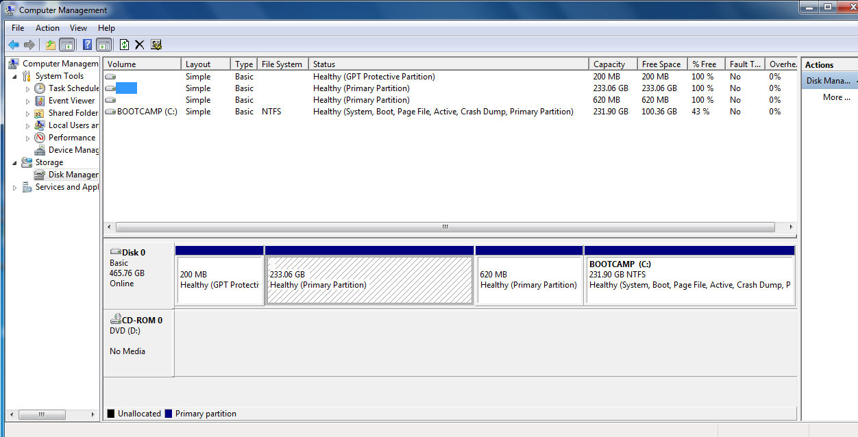

unable to see my MAC volume in Bootcamp Windows Explorer.
Is it listed in drive management in Windows? Do you have FileVault on in Mac?
Yes it is listed in Disk Management as "Healthy Primary Partition"
I have attached a screenshot of it below.
In the MAC I looked up the Filevault and it is OFF
My total HD space is 500 GB. I divided it equally between Bootcamp and MAC in the Bootcamp Assistant.
