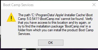

Now I have problem installing the drivers , I got the drivers using bootcamp assistant version 6.xx on usb ,,, but I get error in middle of installation stating wrong path or similar ( will attach photos when I get to my mac ) ,, I got exact same problem, when I updated Apple software driver update via windows update .

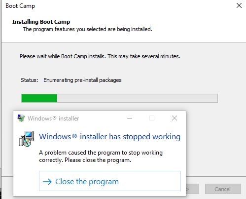

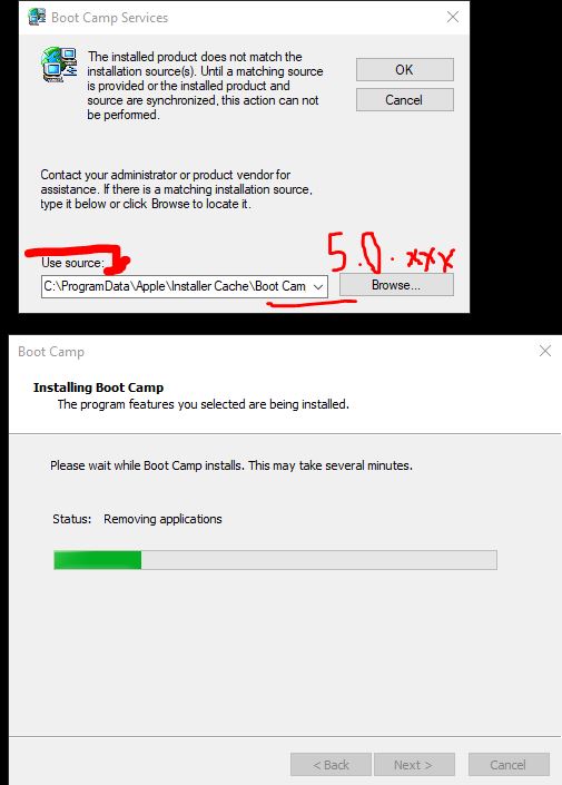

1-Not being able to install bootcamp drivers on windows 10 and getting error "installed product does not match installation source .

If you're still getting a "Windows Installer stopped working" dialog , just ignore it and click on "Close Windows Installer" and BC should continue to install , after installation complete it will ask you to restart your computer ,if it didn't ask , you restart anyway.
