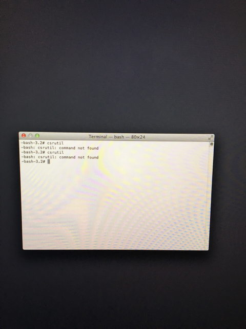

I just tried to re-enable SIP and terminal said command not found. I tried the disable command again and it said the same thing. This is odd.
You are running the latest version of OS X El Capitan? That is odd unless you have a typo of some sort.
What do you get is you just type: csrutil (lol ... I typed it crs... the first time I tested it just now)
csrutil

That's pretty odd since it worked the first time for disable.
I don't remember what update SIP became active ... but I assume with a new install that you are on 10.11.6 with updates.
