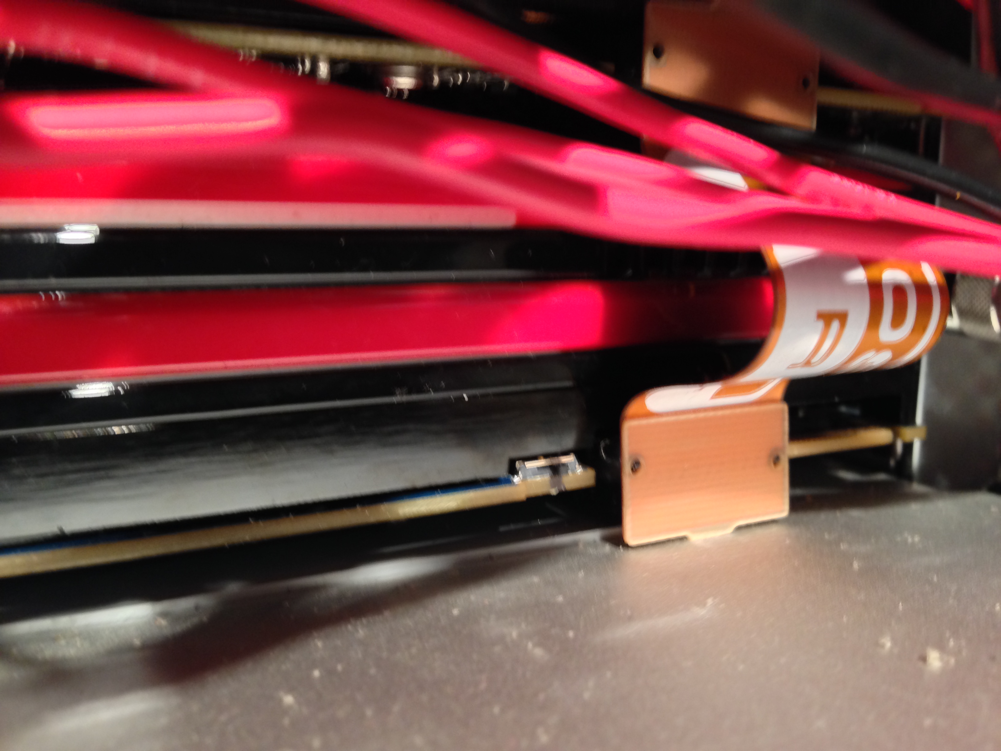

I have tried but it didn't help. I don't know why that switch doesn't say anything?

I still can't tell if you understand what I mean by switch.
It is a small electrical switch on card, by the CF connector.
So for instance, to fix your XFX you just place it in other position so it boots from 2nd BIOS, then go into Windows, flip switch back and flash the bad one back.
To clarify, the Reference 7950/70 cards have 2 EEPROM chips. There is a electrical switch that lets you choose which chip's rom you use.
To recover a bad flash, you just flip switch to boot from unmolested BIOS, then BE 100% SURE YOU FLIP BACK.
A card only accesses the chip at boot.
To get CF working I had to be sure that both cards had the EFI switched off and only used the PC BIOS.
This trick worked for 7950 and 7970.

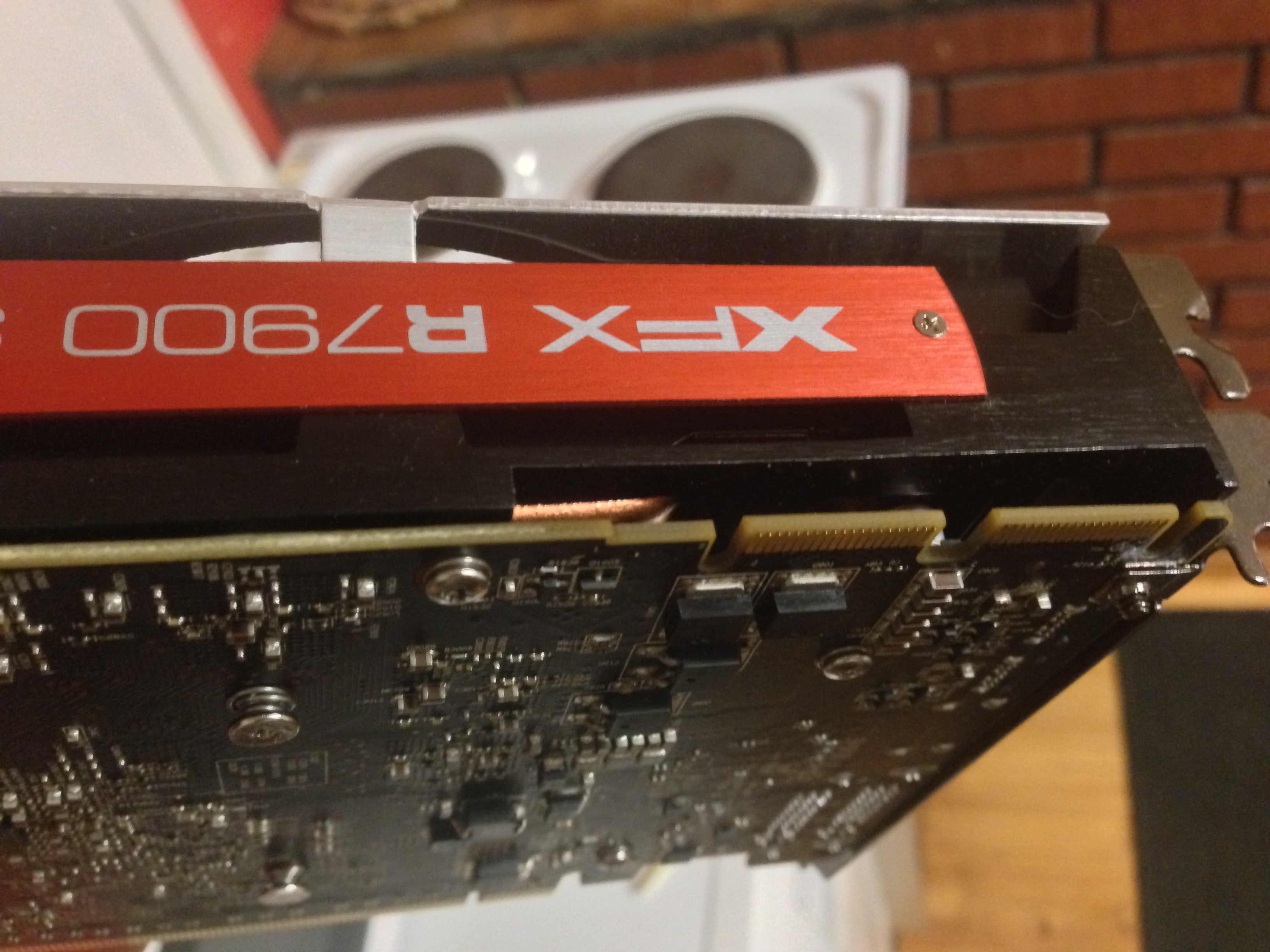

Yes i understand that switch but xfx card doesnt have it. Other card have it and i have plugged it at pc bios position. That's the rom what i flashed to xfx card from other card pc rom. Xfx card have that same place where the switch is at other card but there is no switch. Just similar looking empty place with numbers 1 and 2 like other card have. But without switch. Xfx card is not a "mac edition" card. It's just the normal pc card.
