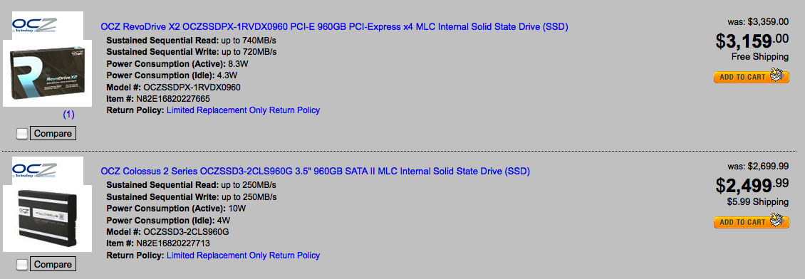

Hi boody,
here are two 1TB SSDs for you (from newegg):
