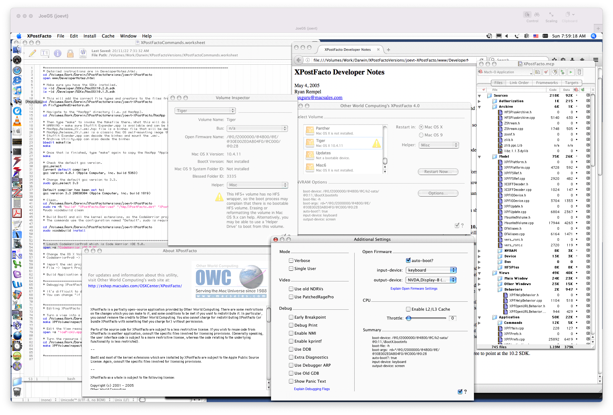

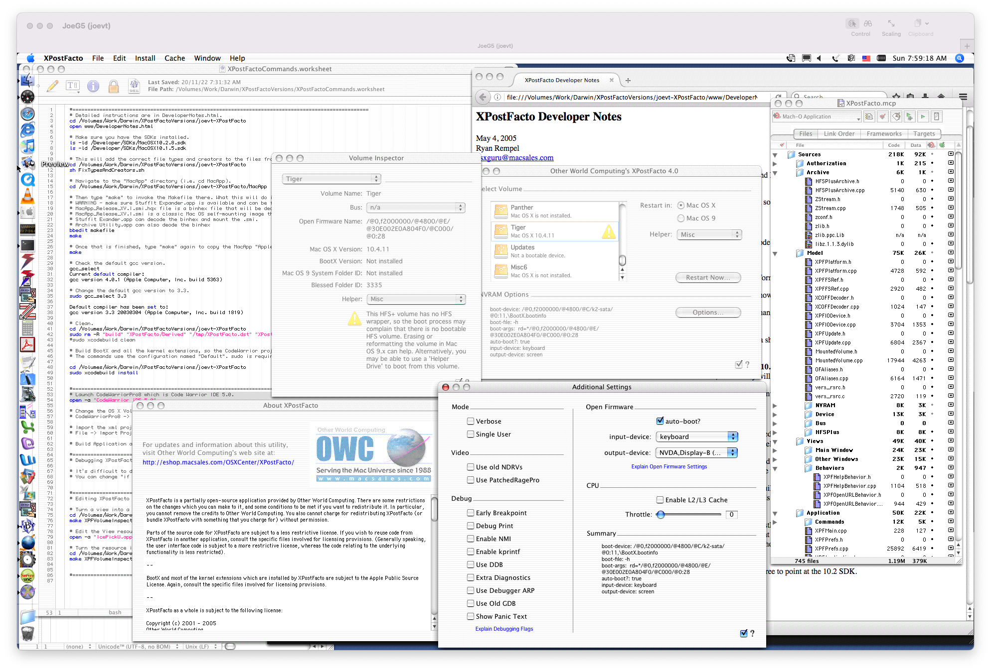

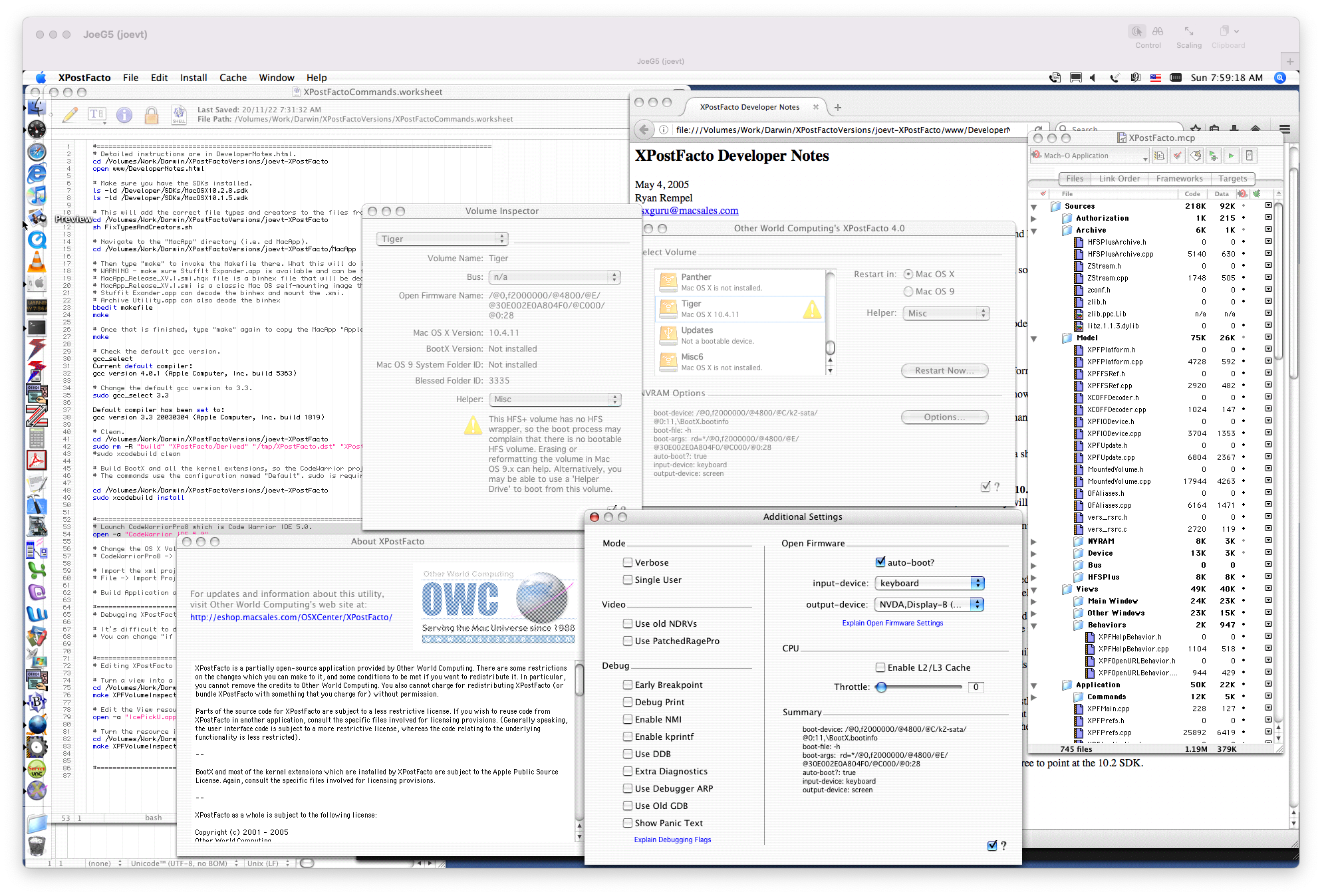

I just finished building XPostFacto on my Quad G5 in Tiger. I'll update my GitHub when I finish testing the result on my Power Mac 8600. My changes aren't really necessary for what you're talking about but we could use it as a base.
Anyway, I think XPostFacto is supposed to be able to work on New World Macs as well? I haven't tried it though. Instead of a RAM disk, the helper disk is a partition on a bootable disk.
The XPostFacto UI shows what the nvram settings will be so you can see what is required to redirect the root. In the attached screenshot from my Quad G5, boot-device points to BootX on the helper disk (internal SATA disk) which also contains the startup kernel extensions. boot-args contains the root device path which is a FireWire partition - you'll point this at the AHCI SSD. I suppose if someone made a XHCI driver or an NVMe driver for PPC Mac OS X (both have been done before for Intel Mac OS X) then you could point it at a USB 3.x drive or an NVMe SSD.
