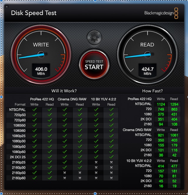

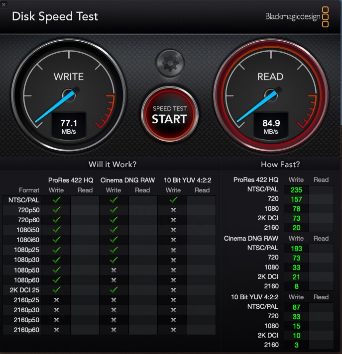

I can't quite believe the transformation simply in buying a $100 external SSD and connecting via USB 3.0. It feels like a new machine.
A speed test of my internal HDD which was the start up disk since new in 2016:
The external SSD now being used as a startup disk:
