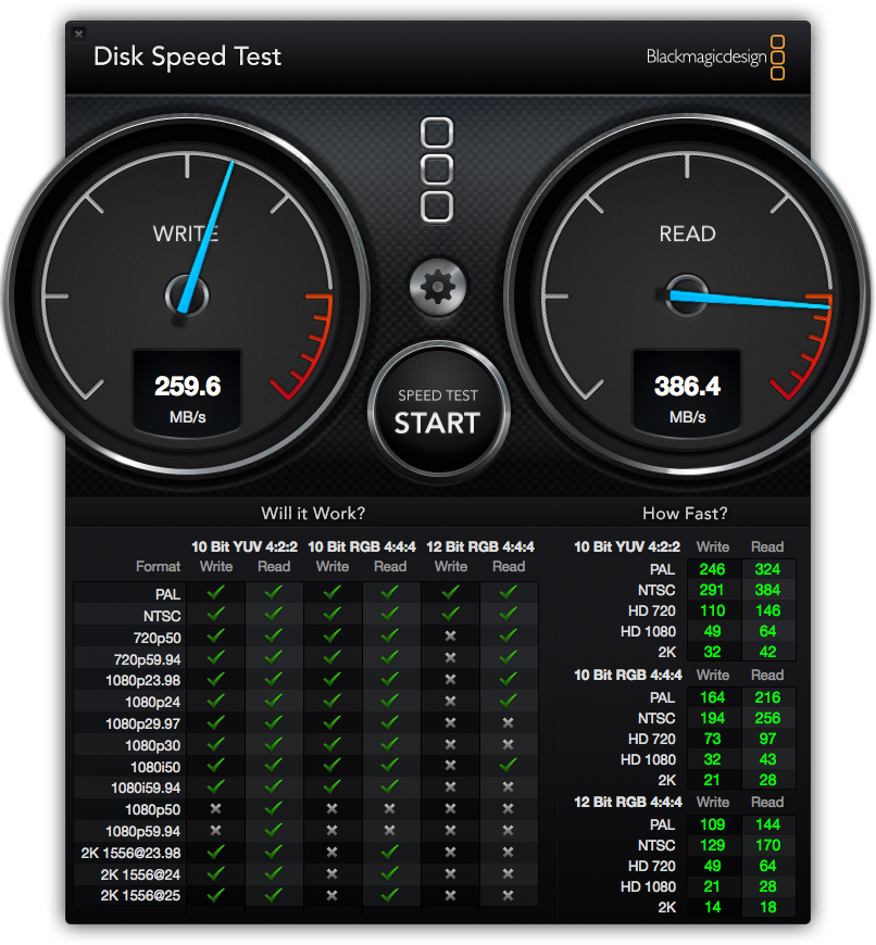

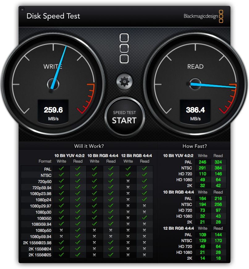

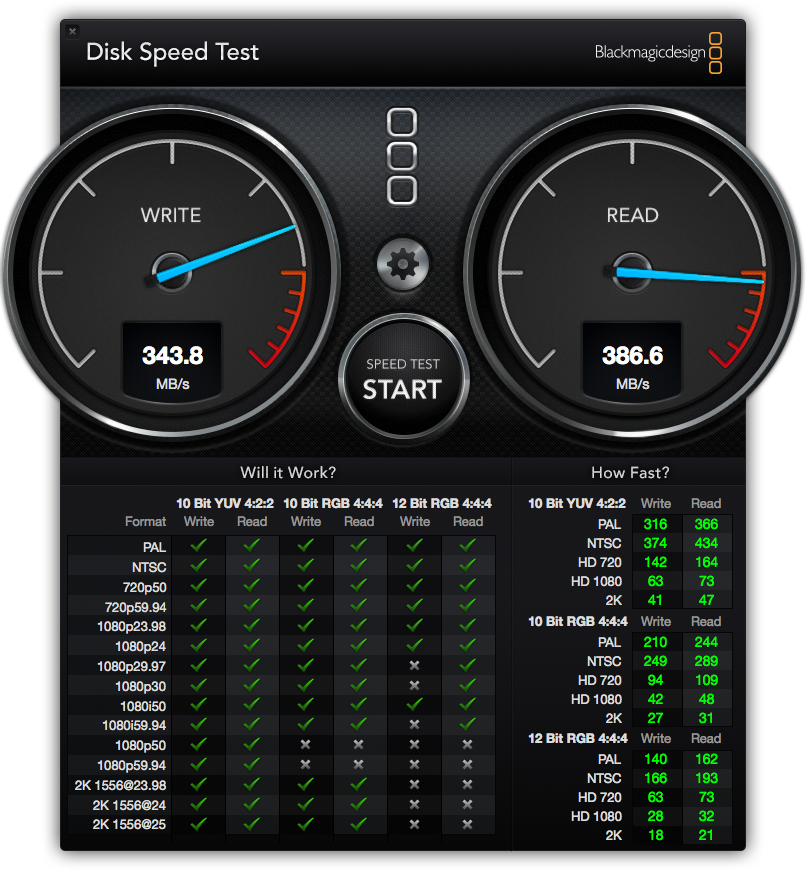

Has anyone attached a Samsung 840 Pro to the Seagate GoFlex Desk Thunderbolt Adapter? It sounds like a fast combo, but I'd like to see some benchmarks 🙄
I don't have a desk GoFlex, but have tested with the portable Thunderbolt GoFlex adapter, which another poster with both indicated were the same speed. There are many tests posted on various threads here.
Here are my results with a 256GB Samsung 840 Pro and a 256GB Crucial M4 SSD drives:
-howard
Left: Samsung 840Pro .............. Right: Crucial M4
