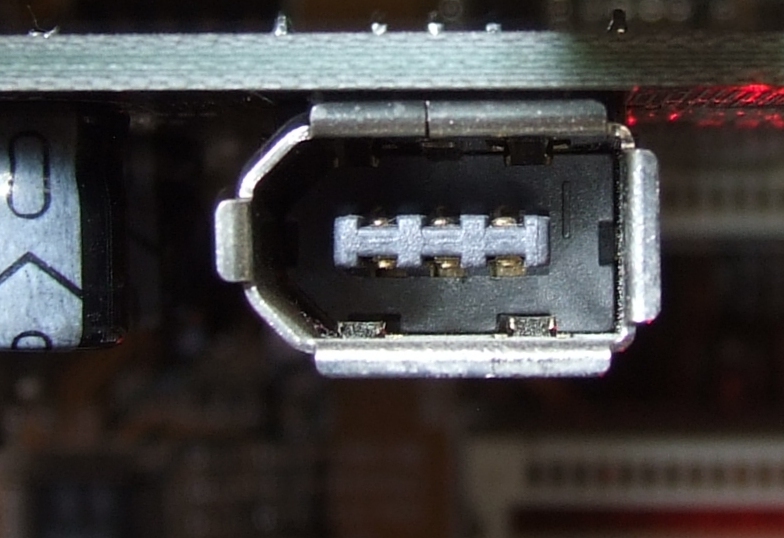

Another thing too, if you go the FireWire route: Make sure it's FireWire 400 or IEEE-1394a - NOT FireWire 800 or IEEE-1394b. It's not likely you'll run into the latter, it wasn't common and relatively few Macs ever came with it. iMac G5's of any variety only ever came with 400 (1394a), and that's what you need. Your iMac can use 800, but only with an adapter which you'll almost certainly not find in a physical store.
Here's what a 400 (1394a) connection looks like:
The FireWire ports on your iMac (and on an external drive) will look like this:

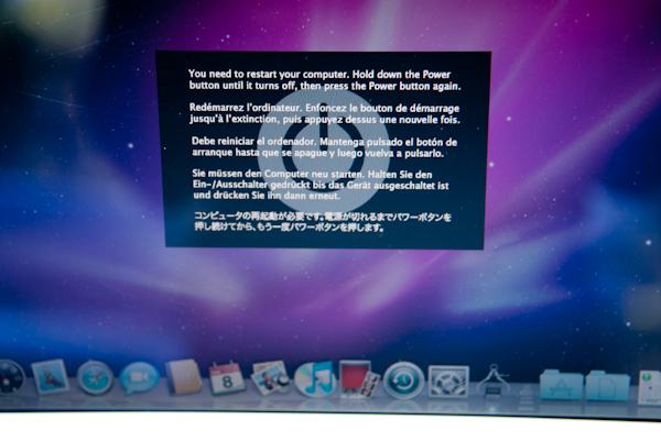

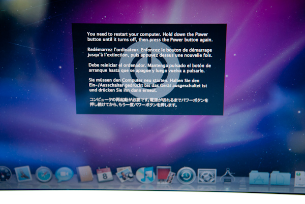

    • Do you ever get a screen that looks like this:
  • When you do get it functional, how long does it run? Is it always the same amount of time?
  • When it stops working, what happens?
    • Does the iMac just power off?
    • Do you get a black screen but it stays on...e.g., you can still hear fans running, etc.?
    • Does the screen remain normal, but the computer "freezes up", i.e., becomes unresponsive?

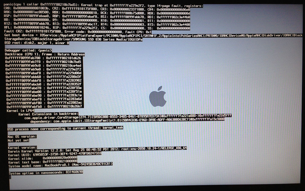

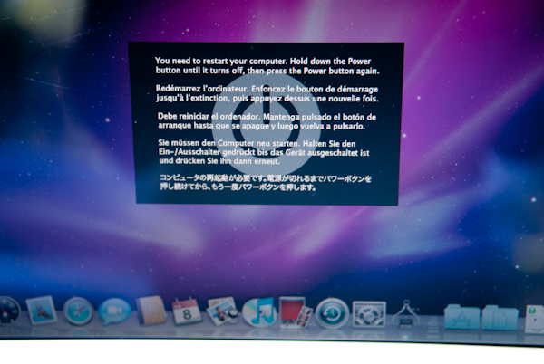

    • Does it go into a kernel panic (screen that looks something like the following):
I'm not trying to be nitpicky, but any further info you could provide will help someone troubleshoot your problem.

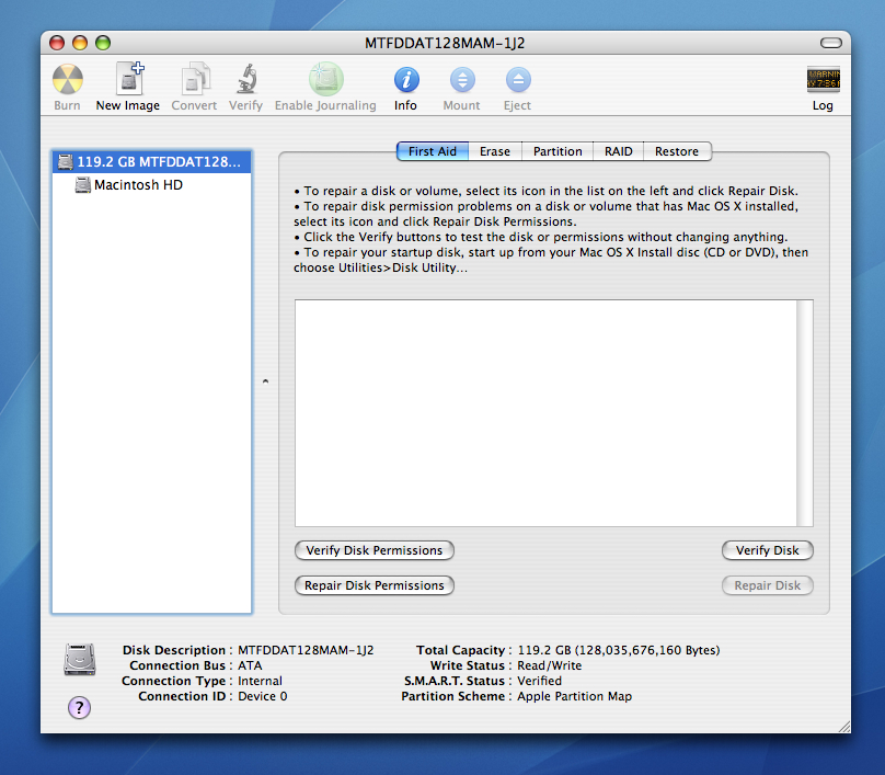

OK, that's good info. This sounds like a disk issue, even though SMART says it's verified. Try this: start the iMac in Safe Mode by holding down the Shift key at boot (begin pressing Shift from the moment you press the power button). Safe Mode turns off unnecessary extensions and other things, leaving OS X with just the basics that it needs to run. This will take a bit longer than usual, while your disk gets checked for problems.
Assuming it completes the boot process, try the following:
  • Try again to move your fonts folder onto a USB drive. You may find that it works now; if so, I guess your immediate problem is solved.

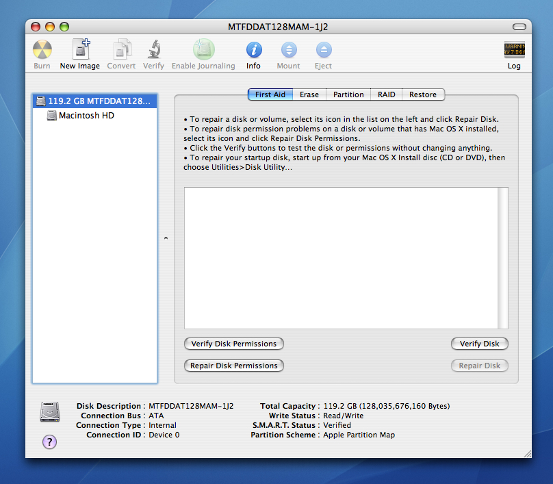

  • Open the Disk Utility program, and try verifying the hard drive. See the pic below. Choose your drive from the column on the left, then near the bottom on the right, click "Verify Disk". Give it time to complete the process, and see if it reports any errors.
When you've finished the above, you can just restart the iMac (or shut if off) and it will reboot into normal mode.
