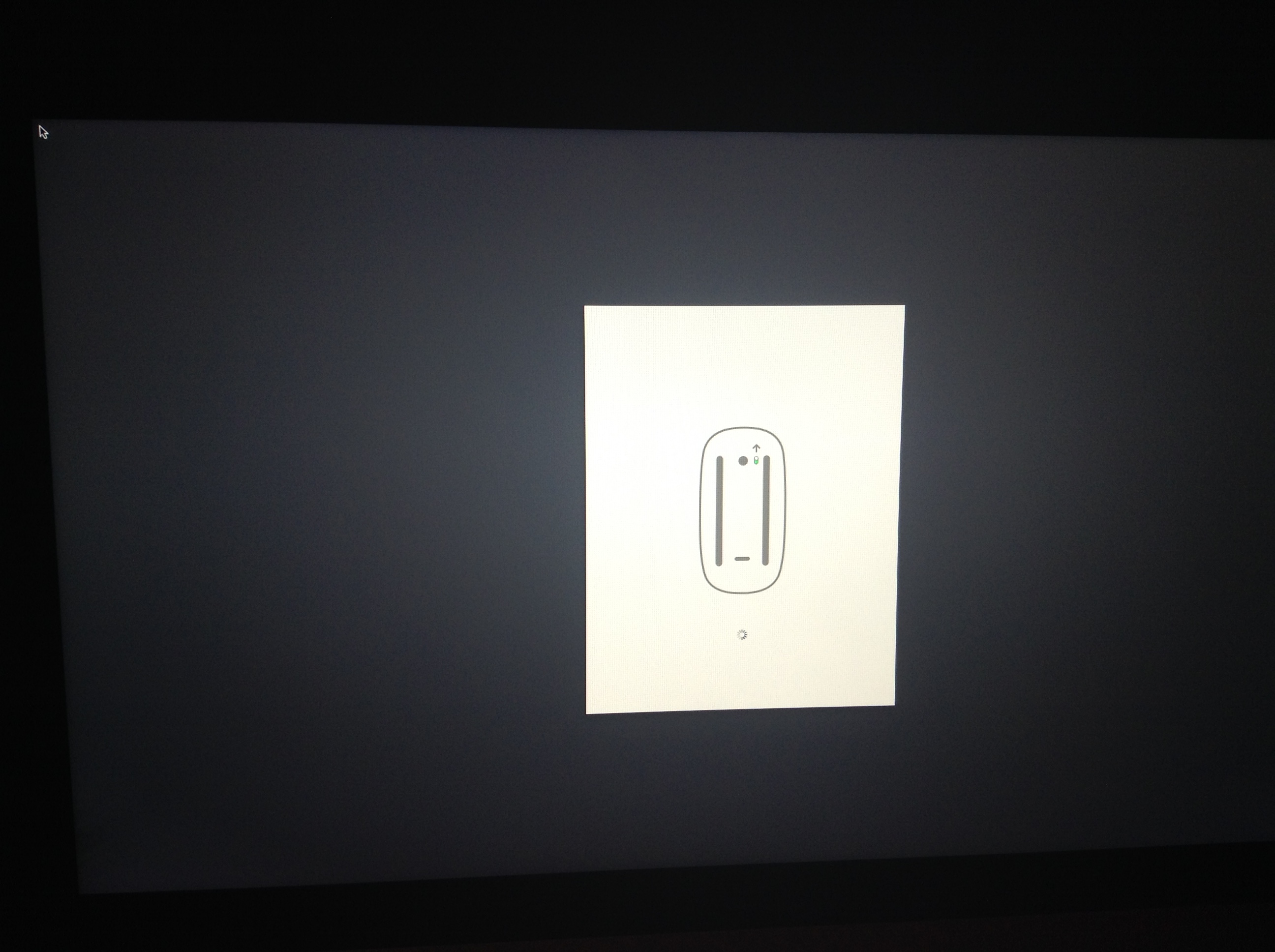

I went into recovery mode to convert my system to apfs and now when I try to boot I end up getting a screen telling me to turn on a mouse along with a spinning "busy" wheel... I dont know how to fix this! Im worried I may have corrupted the HDD or something!

you may need to have a usb connected kbd/mouse for some recovery actions.
I can enter recovery mode with a USB mouse but not MacOS itself... what should I do? In recovery mode it wont let me select my main partition anymore saying like "bless failed" it wont detect any time machine backups and even trying to do a full reinstall it cant connect to the server...
I am getting desperate here, its a 2012 iMac and I thought itd be okay... I wish I never upgraded

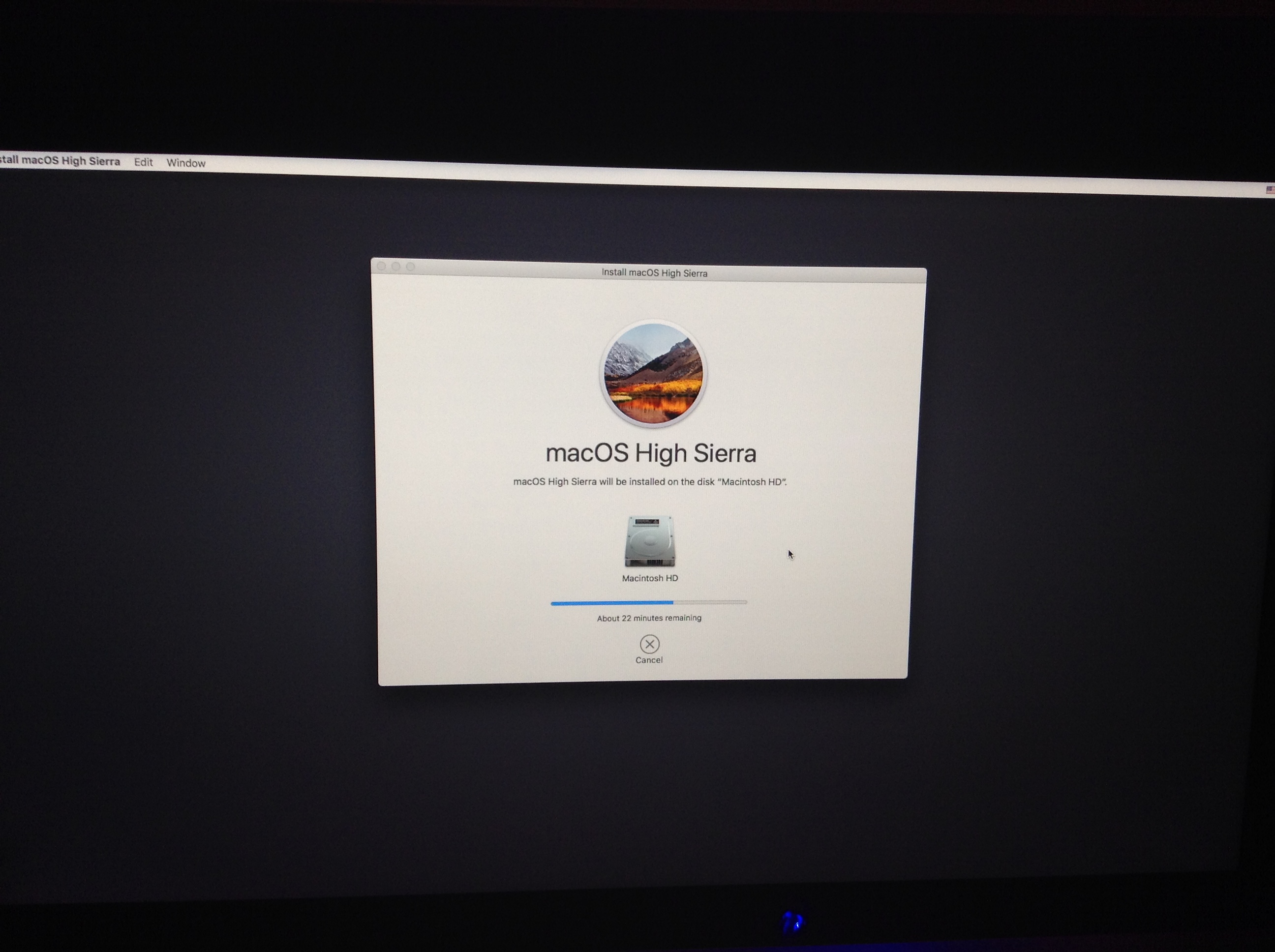

well... i got here in recovery mode. i pray it boots to the full system after doing this, i swear ill never touch that new file system crap ever again!

Unless you replaced your internal HHD drive with a SSD flash storage, converting it to APFS was a bad choice. I suspect you will need to erase the drive and reformat as HFS+ Mac OS Extended Journaled. If you don't have a backup, there are options to save your data before erasing.
im currently reinstalling HS from recovery, i dont know what the end result is honna be. Also I constantly make time machine backups but recovery mode wasnt able to find anything bootable from my time machine drive :/

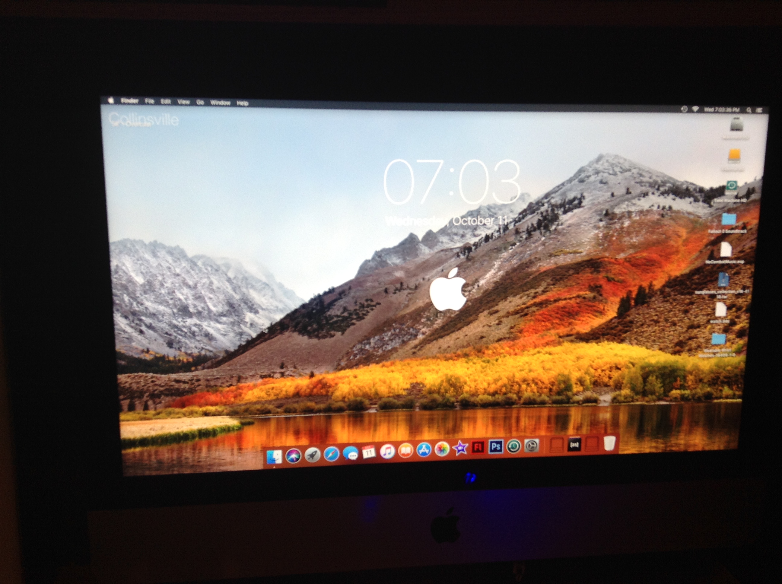

[doublepost=1507766824][/doublepost]Phhheeeeewwww!!!! thank god that worked! seriously, i was about to vomit from how upset i was >o< thanks for your assistence on this, guys! I really appreciate it!
So note to anyone with this problem, go into recovery mode, sign onto your wifi and reinstall high sierra, nothing will be lost :3
-And as a follow-up, it looks like the APFS file system installed cleanly after all that anyway so... thats nice I guess *sigh*
