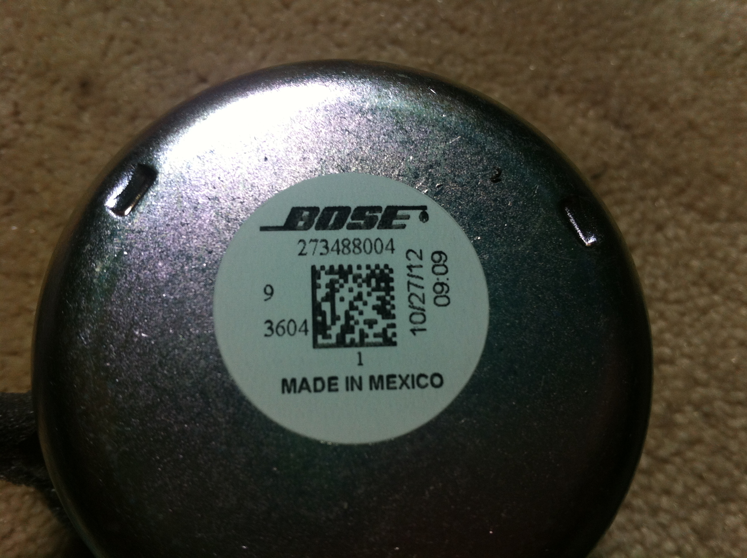

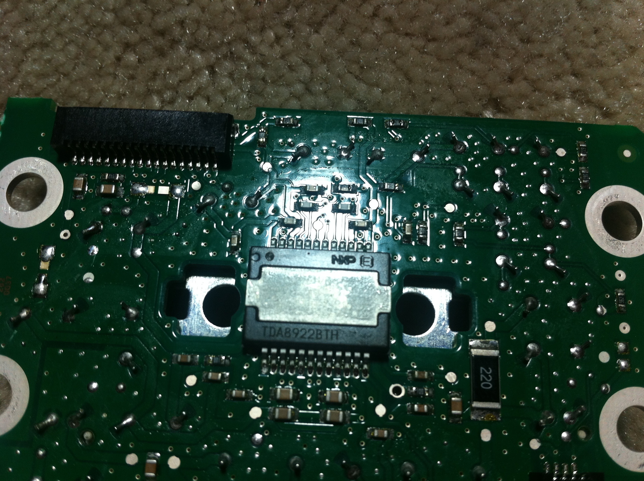

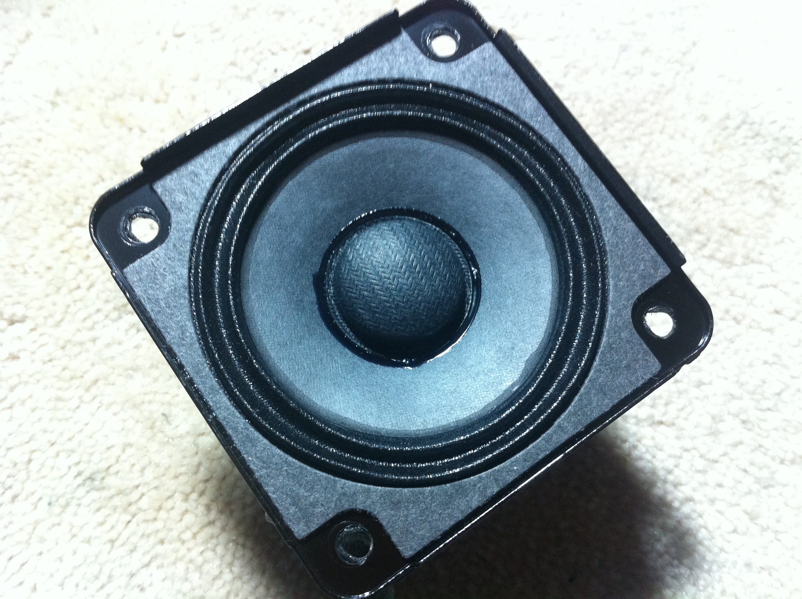

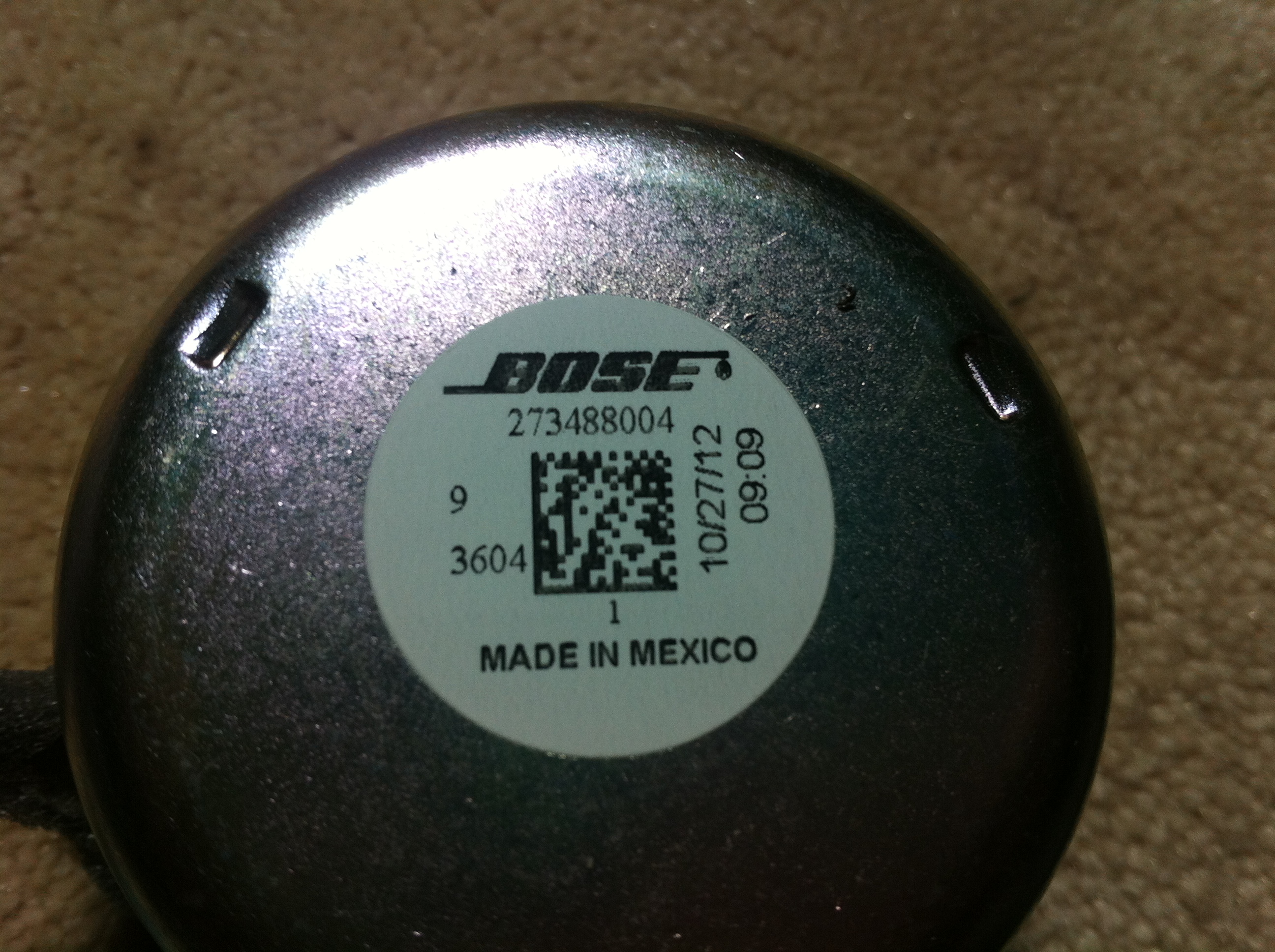

The heart of the SoundDock is a TDA8922BTH. This little amplifier IC is a SMD component. The spec sheet claims it is a 2x50W Stereo amp IC (50W per channel) The SoundDock's power brick spits out a ±18V. This isn't enough to get the full output of the IC. The IC's data sheet says "Operating supply voltage from ±12.5 V to ±30 V, and you would need the full ±30V to get 50WPC into 6Ω The service manual says this thing consumes 36 Watts Maximum". So with So at full distorting volume it only is taking 36W from your wall socket. Add the iPod charging, other components, the fact that the IC isn't 100% efficient, and you get less than 18W per channel at full. I'm guessing 8-10W per channel. I don't have an oscilloscope to check the wattage (service manual doesn't say), so we at least know i is well under 18WPC. The amplifier IC drives two 2.25" woofers that Bose calls Full Range Twiddler speakers. These tiny speakers aren't the highest quality. The speaker's diaphragm is made of paper, and it has a paper ridged surround. Bose used to call this "Space Aged Paper" Not exciting or anything. You can find similar drivers with these specs for about $10 each. That said, these ones appear to be made BY Bose themselves, and not a 3rd party. Paper made speakers aren't a bad thing. They can sound pretty good, and are commonly found in high quality, but vintage speakers (1960-1980s) but in this day in age when technology and speaker material has improved, and other materials allow for more accurate reproduction of sound, it is a sign of cheapness.

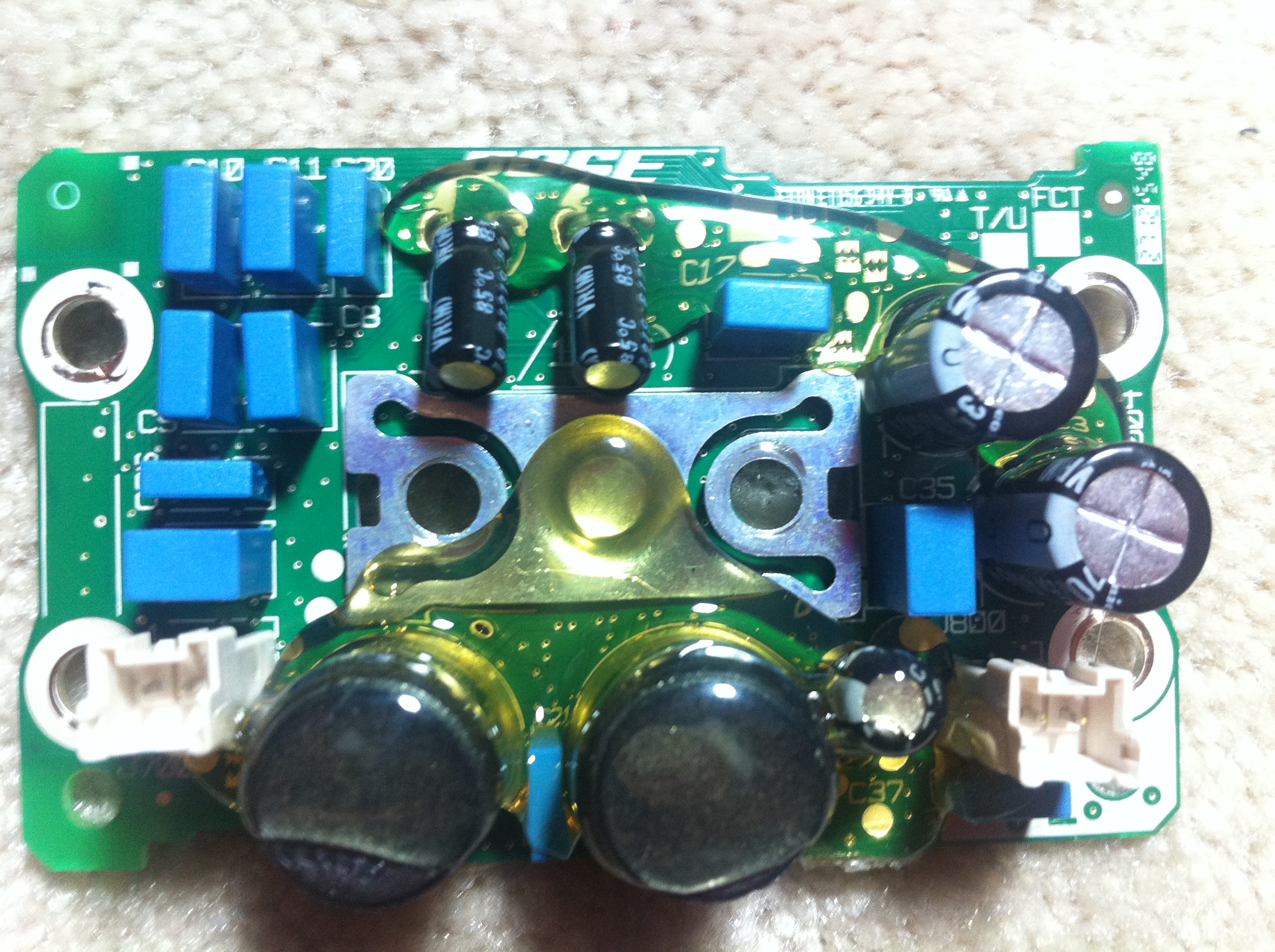

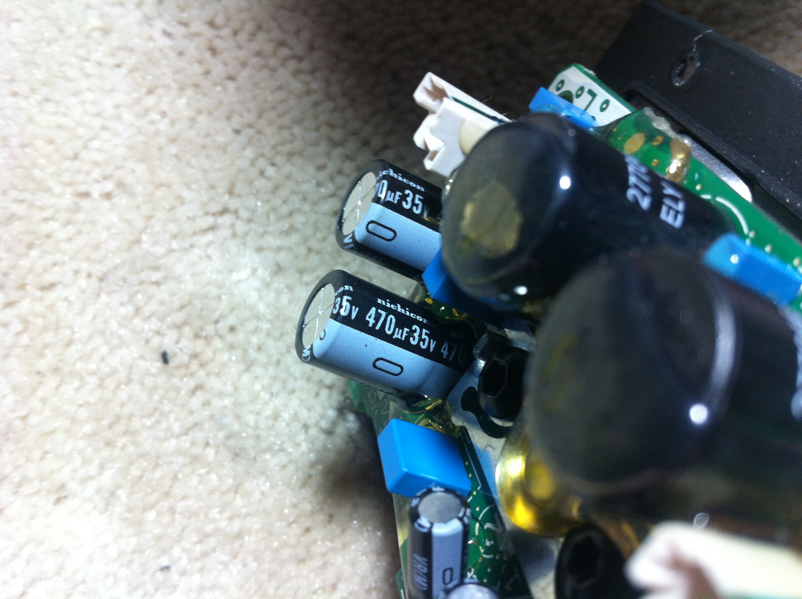

Circuit boards... Inside the unit, the pcbs are made of quality fiberglass, and are double sided through hole plated. Yay for quality here. It gets better, because many modern electronics (especially TVs and computers) use cheap crummy no name electrolytic capacitors. These caps last for several years before bulging and/or leaking. As you guessed, the equipment doesn't work after that. Quality brands such as Nichicon, Rubycon, Elna, Nippon Chemi Con (aka United Chemi Con), and even Jamicon.. They are used in quality electronics and are high quality Japanese caps that almost never fail. Nichicon and UCC/NCC did have some bad batches around 2003, but that has been resolved. Well Bose decided to use Nichicon, so in terms of reliability, GOOD choice!! The plastics are ultrasonically welded PC/ABS plastics, and that is a decent material. In terms of build quality, and part quality, they did good here. Yes they could have used higher quality drivers, but they aren't bad, and they are in a properly tuned enclosure.
