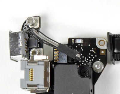

This is cheap on Apple's side, normally electronic stuff has a Diode on the main board which prevents things like these, i.g. connecting the + and - wrong, seems Apple did not get this safety measure onto the board.
You can find out on iFixit.com if it has a separate power board, I think it does, and if it does you need to find a replacement, might find one on Ebay, don't think Apple will send you one.
http://www.ifixit.com/Teardown/MacBook+Pro+15-Inch+Unibody+Early+2011+Teardown/4990/1

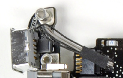

In this attachment you can see there is a plug connected to the main board, also seems to have a tiny small board, you might be lucky.
On the second one you can see there seems to be a diode bridge module, so there might be a good chance you can fix it.(The small black block)

It definitely does have a separate Magsafe board. You think that's what went and not the logic board?

The dark square looks like a diode bridge but I find it kinda odd that if that is the case it is damaged.
You might try an electronics store where they can solder a new one on.
It could also be a fuse but it's not likely to be one.
Hopefully is is only that and nothing on the Logic board.

SUCCESS!! Replaced the magsafe board and it works again! Close call there
