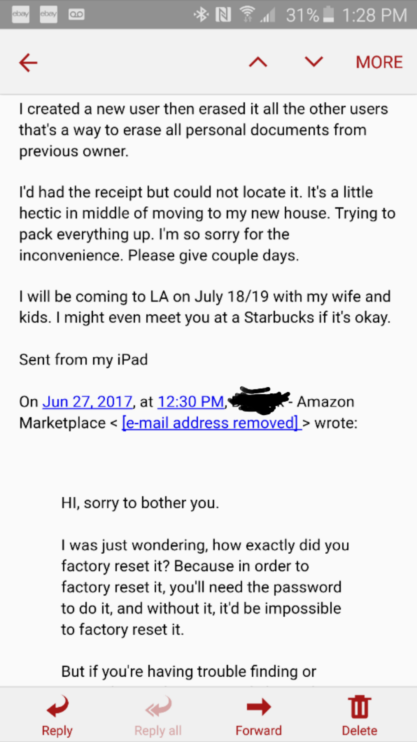

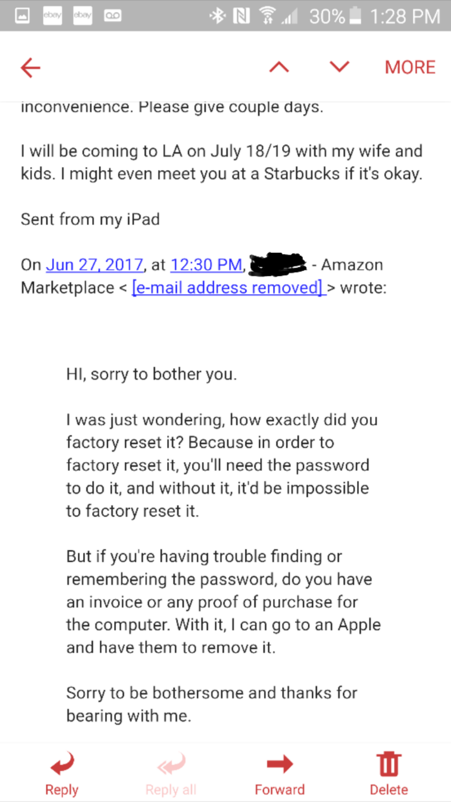

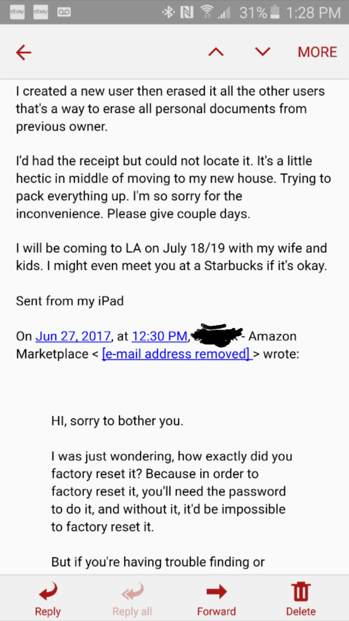

Whelp, I think I may have bought a stolen laptop. I bought it from Amazon.
The seller had a at least 10 positive feedbacks and I thought I was buying it from a store or something because he had a lot of MacBooks for sell.
I paid $950. It's a shame because I really wanted this laptop. And it's a great laptop.
I've uploaded 2 photos. The first one is my email to him and the 2nd is his response. He responded saying he lost the receipt.
May end up returning it.
Fuge me.
Fuge me.
It's pretty unusual to have a lot of MacBooks for sale, and to be selling them on behalf of other people (Removed data of 'previous' owner). The price isn't suspicious, thought if you'd paid $600 then it's definitely a worry.
Thank god you brought through Amazon though and have some recourse! Their story is possible, but to me that sounds like stalling. If leaving it till later in July you'll be out of any return window, and they should be far more aware that you cannot use this computer. If they were genuine I would expect a response of apology and asking you to send it back.
It's up to you, you could deliver an ultimatum. You cannot use it and right now it's a $1000 brick, either they provide you with a receipt (And you have time to confirm with Apple) or give you a password. But don't leave that more than a couple of days and start the return process immediately after. You could contact police and stuff if you suspect stolen goods but it's not your responsibility and sadly nothing would happen. The decent thing to do is take a few minutes searching for stolen good reporting sites and check the serial number, if it is reported then contact Amazon immediately and let them deal with it (You'll get the money back and hopefully the original owner would get their computer back). If not then just return it and get your money back (But still report to Amazon).
