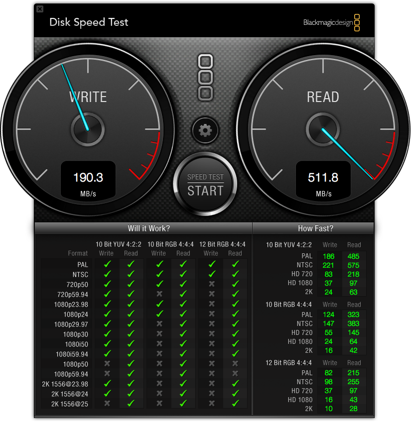

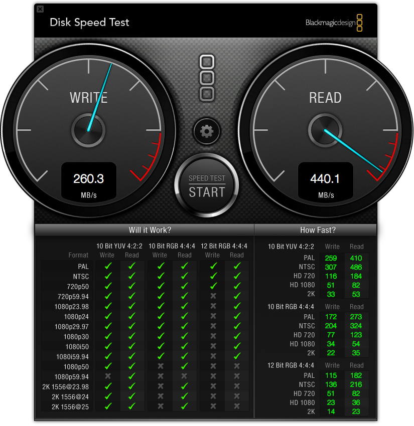

So i've done the dual HDD (SSD in HDD bay and and HDD in the optical bay).
My boot time is around 15 second. Does that sound right? I remember seeing people doing it in 9 seconds.

mine... after that the m4 reached also a reading speed of 501mb/s

Im guessing you bought the 128GB right?
If you bought the 256 or 512GB, write would be faster but whatever.
Yes, it is fine.
Mine boots around 12~15 sec as well.
But my write is 210 and read is 510.
Yeah, i bought the 128GB.
It's good to know i'm getting normal speed.

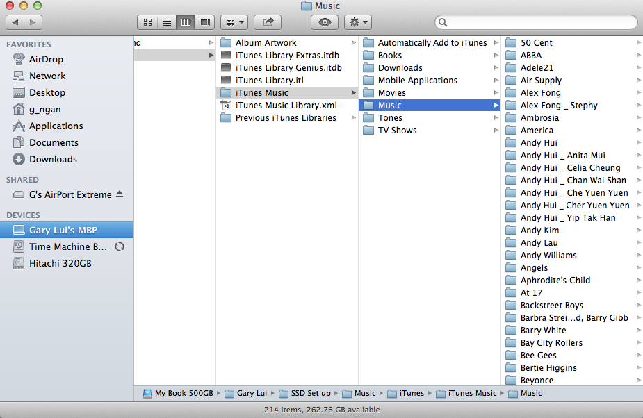

When i drag the music folder to itunes, it says "The app _____ cannot be add to your library because an error occurred. An unknown error occurred (-50)". All the apps can't be added.
The iTunes library seem to be messed up. When i backup the music folder, the music will be in under 'iTunes>iTunes Music'. When i install the SSD, i drag the whole music folder to iTunes. But when i check the folders, all the music will be in iTunes folder rather than iTunes Music folder. When i add a new song to the library, it will be in iTunes Music folder though.
Also, all my playlist isn't transfer. Any idea why?

Good choice on the M4, I love mine. I did enable TRIM. Does it make a difference? Don't know but I certainly feel more comfortable with long term performance with it though. Mine came with the latest firmware and yours like did too. For iTunes I just dropped my music in the folder and it added just fine.

Try copying the whole folder of itunes under "user/library/itunes"
to your new SSD's "user/library/itunes"
This should replace all the stuff in your iTunes.

Thanks for the tips yusukeaoki. It's working now. Is there any way around it because I would prefer to put the iTunes library in the HDD. My SSD is kinda full with iTunes library in it.
