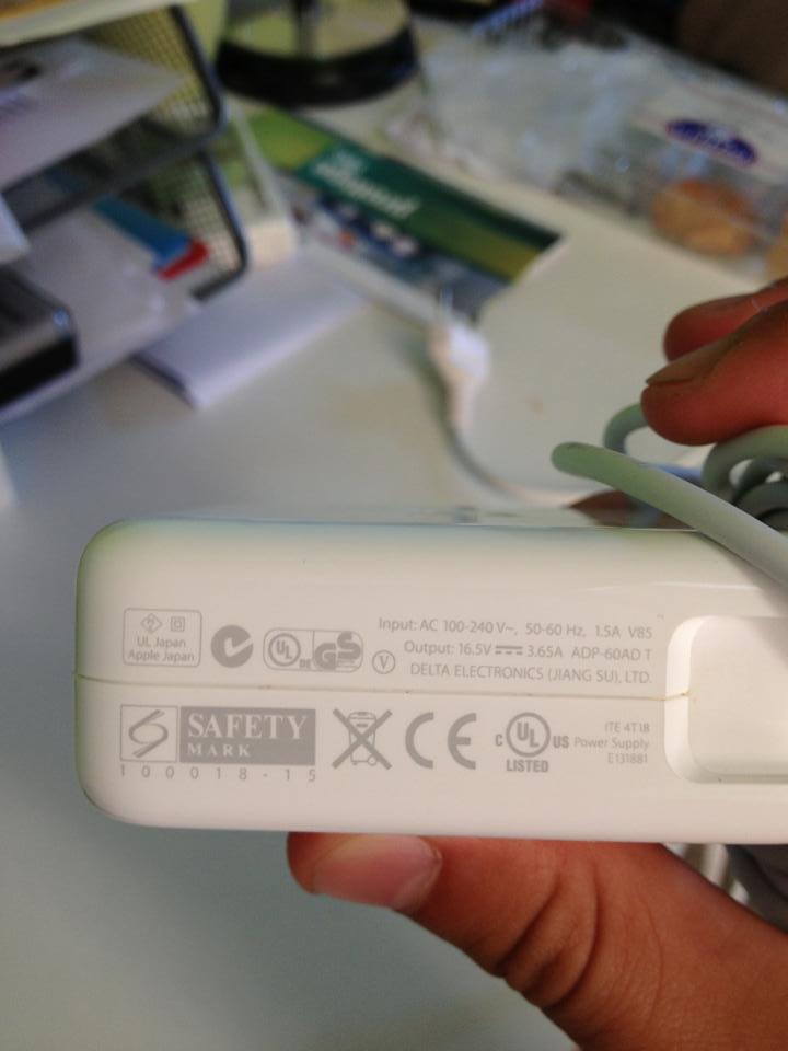

The 125v and 250v are the voltage of the power going into the adapter (from your wall), not the voltage going to the notebook.

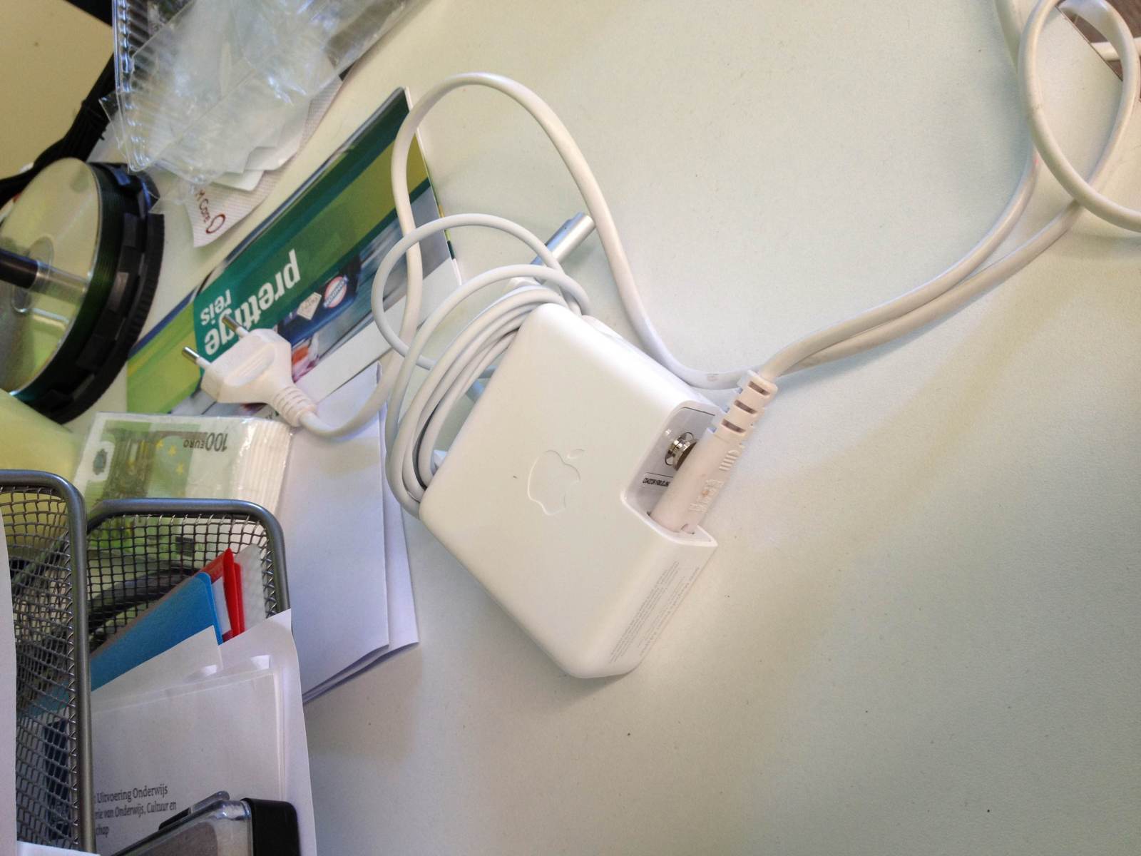

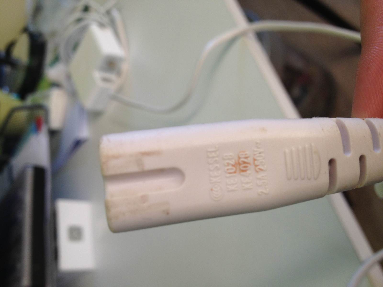

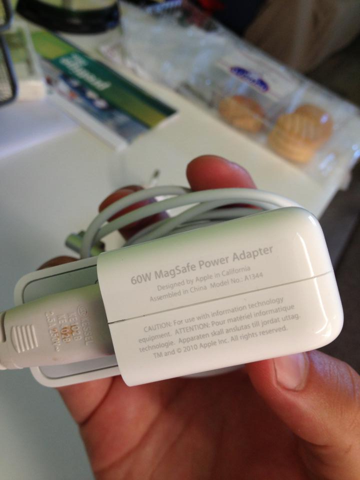

Take a look
That power plug would not cause any issues but it would not provide you with a proper earthing and you may experience tingling sensations on the aluminum body while charging.
That little ducktail doesn't have separate earth anyway, whereas the one attached to a power cable does have separate earth. And, yes, the little one sometimes gives off a tingling sensation on my 15" MBPR, wheras the one with the power cable doesn't. So, it seems that pushing a power cable from an old Airport Extreme Base Station or AppleTV into the adapter will work...
Yeah, that should be ok. As you can see the Apple power brick is capable of receiving 240/250v AC without problems. In the absolute worst case you might blow your power brick but it shouldn't damage your laptop.
Yeah... I wouldn't sweat that at all. The plug is nothing more than a venue for connecting power to the brick. You're doing that (perhaps without a ground). Go for it.
