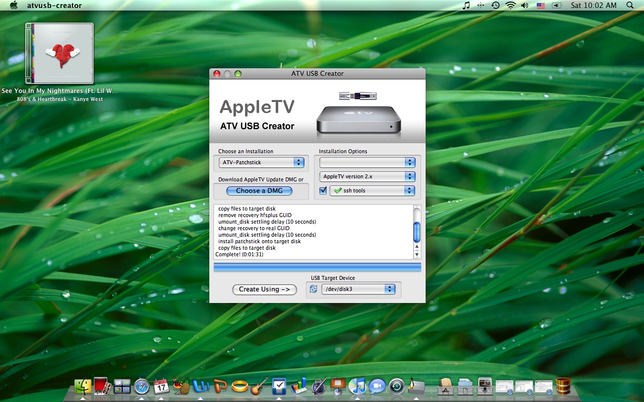

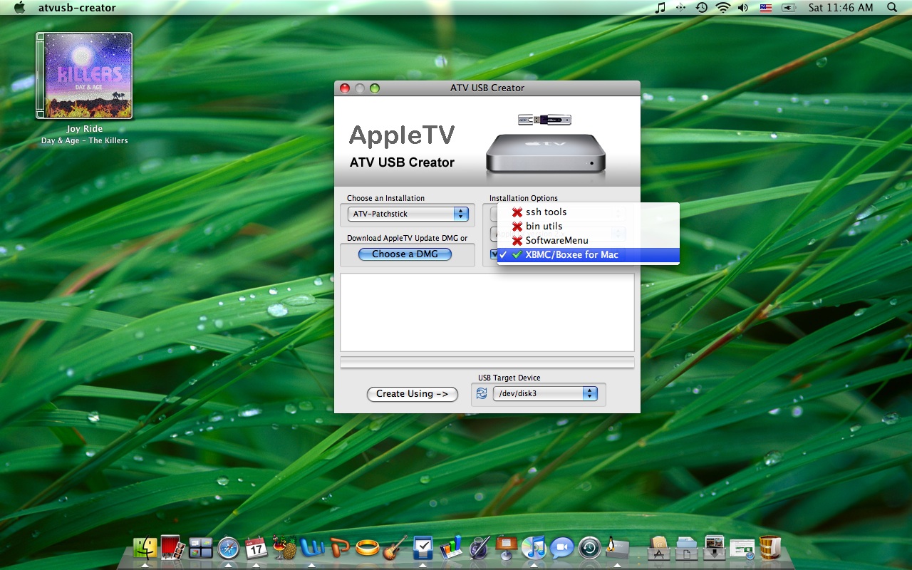

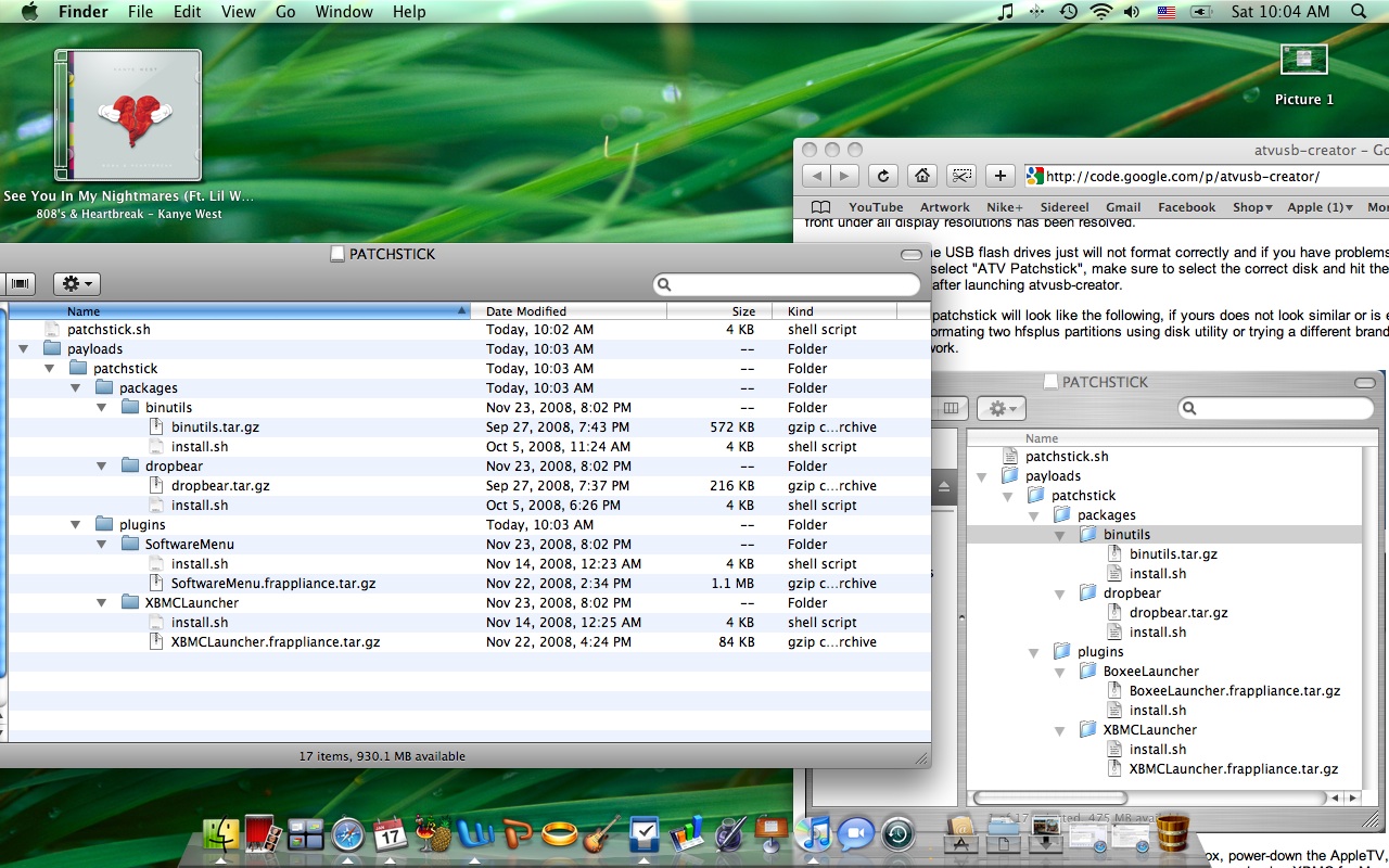

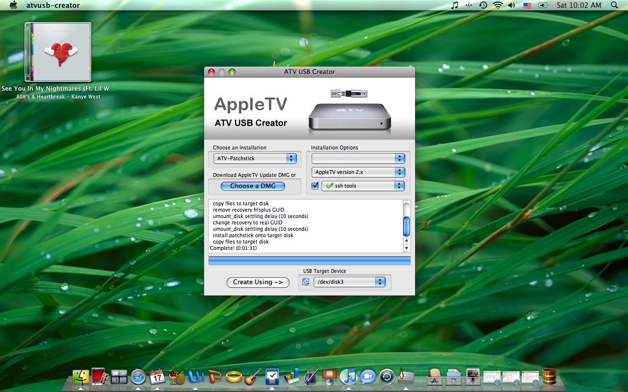

hi,
I am trying to install boxee on my ATV 2.3... but when I insert my patchstick the ATV runs as normal, without any sign of the penguin🙁
I am using USB creator 1.0.b10, I followed all the instructions from online guides but it still does not seem to work, included is a screenshot of what the patchstick looks like after I just completed the USB creator process
😕Do I have to have boxee for mac installed on my macbook, or what else am I doing wrong?😕
On the left screenshot, I have my patchstick open compared to an online guide of what it SHOULD look like, and the only difference is that mine does not have "Boxee installer"
Any and all help is appreciated:apple:

hi,
Change the selection from SSH Tools to install Boxee.
Then run the program and install to the thumb drive.
Unplug the ATV and insert the USB Thumb drive on the ATV. Plug the power back into ATV and let it power up. You should see Boxee being installed.

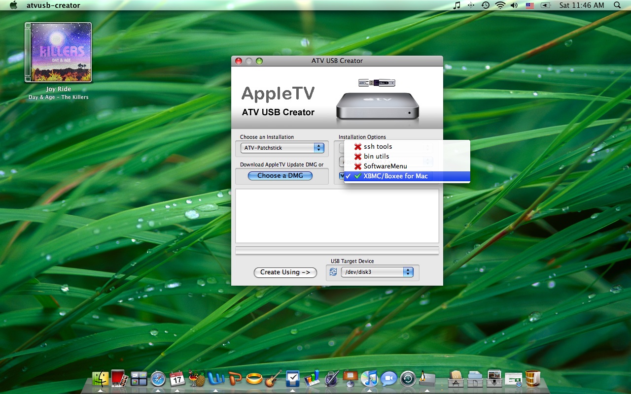

Thanks for the reply,
Unfortunately I unchecked everything except for XBMC / Boxee and it still did not work.
According to http://www.tuaw.com/2008/11/24/boxee-is-updated-for-apple-tv-2-3/
all presets are to be left alone, but this is what I initially used and found ineffective
After each failed attempt I am using Disc Utility to erase / format the thumb drive for mac (Extended)
Do I need to have certain items checked off with USB creator?
Thanks

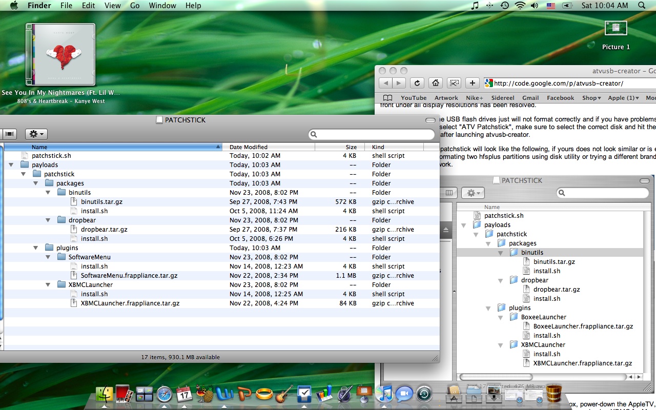

hi,
Exactly the same thing happening with me. I do have Boxee on my Mac. Still a no go on ATV. I am using a Kingston 2GB thumb drive. I format it using disc Utility to Mac OS Extended, but after it is finished formatting it always says Mac OS Extended (Journaled). Is this the problem?
Fixed
Thanks for help!
All I had to do was use a different Flash drive, apparently my kingston 1 GB is a p.o.s.
The drive i used successfully was an Insignia 1 GB flash drive😀
